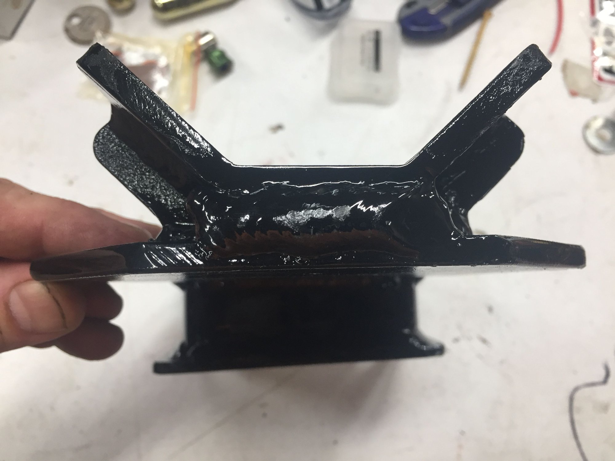

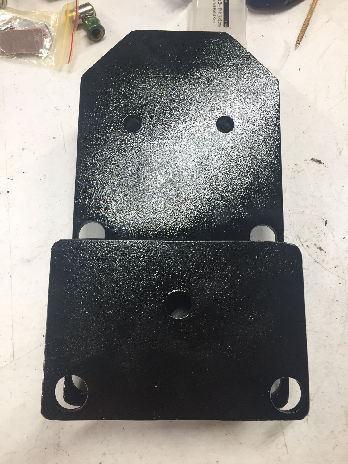

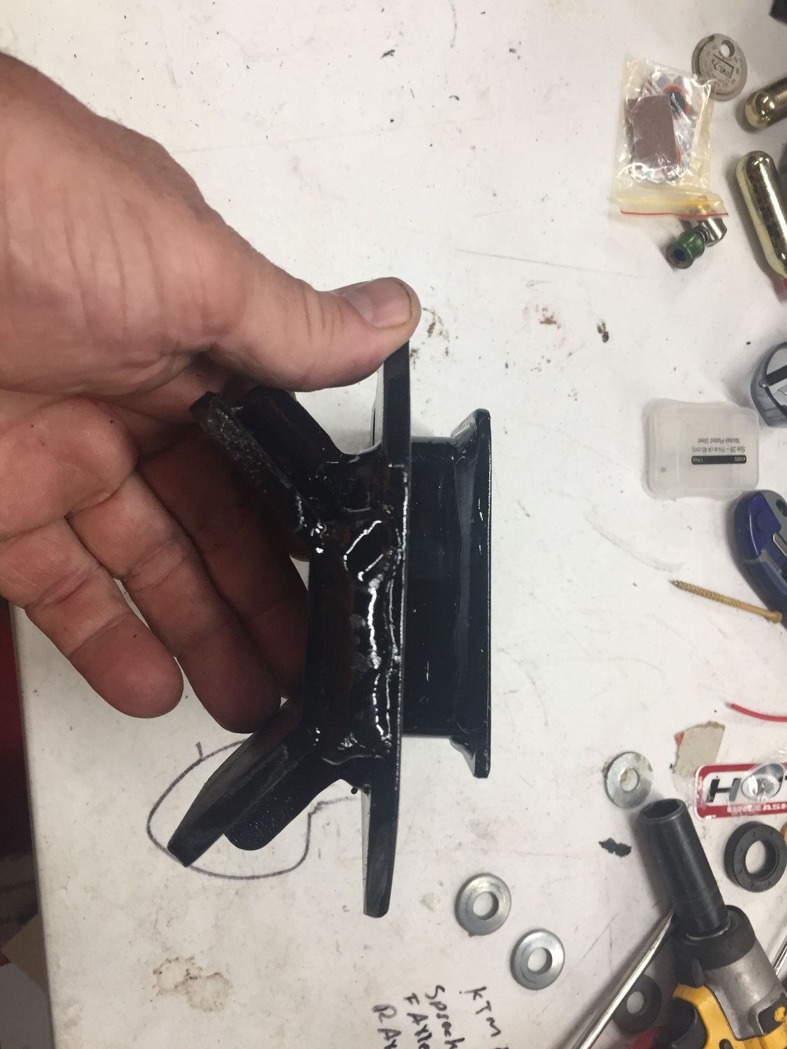

yes, the long beds do have tapered blocks. The 17 to 19 blocks are 3 1/4 inch high with about one degree of taper. The 20s have 2 inch blocks with about 2 degrees taper.
I have ave a PMF 1.5 inch, 2.5 degree tapered blocks with airbag tangs listed on FB market place for sale. I also have a set of the stock 2020 blocks I’ll sell. I built my own 2 inch blocks with 1.75 degree taper with airbag tags. They work great.
