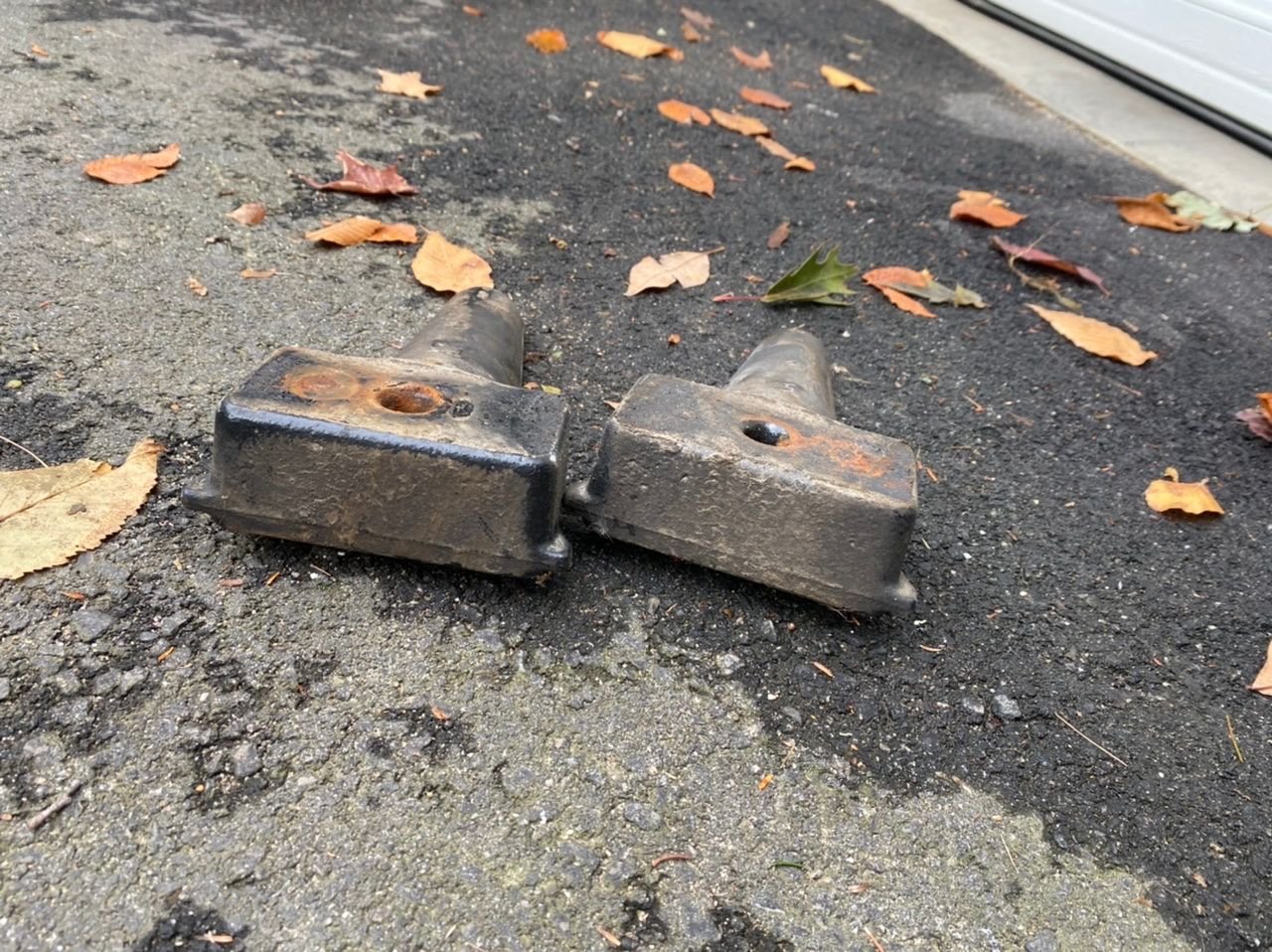

I have a set of 2016 2” blocks if anyone wants them. PayPal or Venmo me the cost of shipping and they are all yours. Or pick them up in Portland, Maine if you are nearby. PM me if interested.
https://cimg4.ibsrv.net/gimg/www.for...4b342ce8a.jpeg
https://cimg9.ibsrv.net/gimg/www.for...2f7cf7db5.jpeg
I’ll even hose them off before I ship them. Lol.

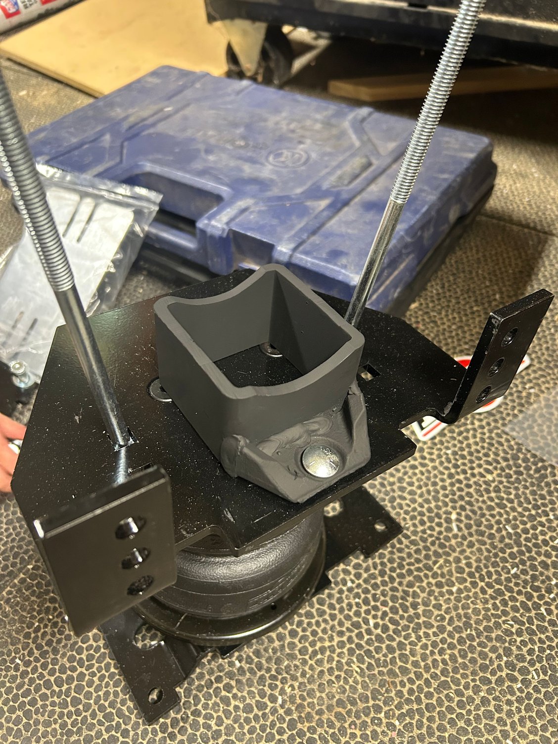

With my 2019 STX, it had about a 3” rake from the factory so I felt I needed more drop than the 2016 blocks would provide. I ended up just getting some 1” spacers off of Amazon which left me with right around a 1” rake, and looks perfect. I did have to get new ubolts as the factory ones needed about 1/2” more of threads. Just went to a local shop to have some made instead of trying to play the guessing game on which Ford part numbers ubolts would be the right length.
Since the spacers don’t have the bumpstop “tang”, I had to modify my air bag kit to make a 1” taller spacer and let the bag kit rest directly on the axle (prefer this over the tang anyway as I’ve read reports of them bending with bags). Next steps will be getting some kind of onboard air setup with cab controls for the bags, but just have manual fill fittings in the fender well for now. Made a 1000mile round trip with the camper weekend after the install and did great! I think the bags really help eliminate the “donkey kick” effect in the rear!
The silver 1” spacer under the leaf, and installed bag kit:
Before level:
After level:
Modification I had to make to bag bracket:
After level and with bags deflated:
With about 50psi to bring back to level:
