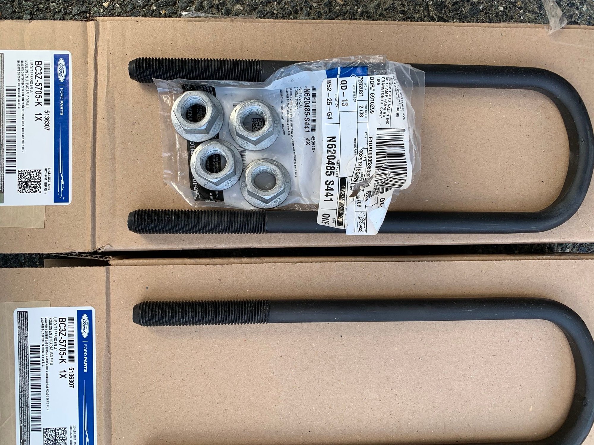

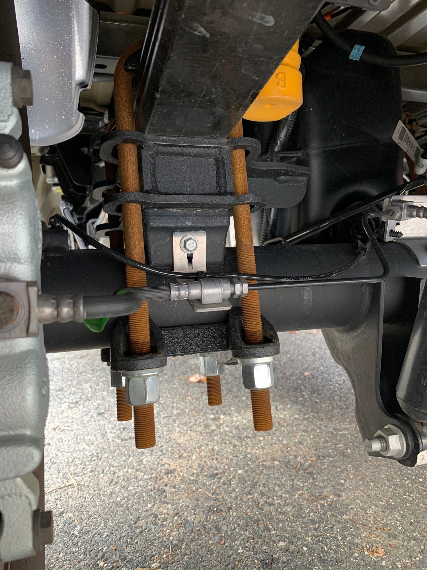

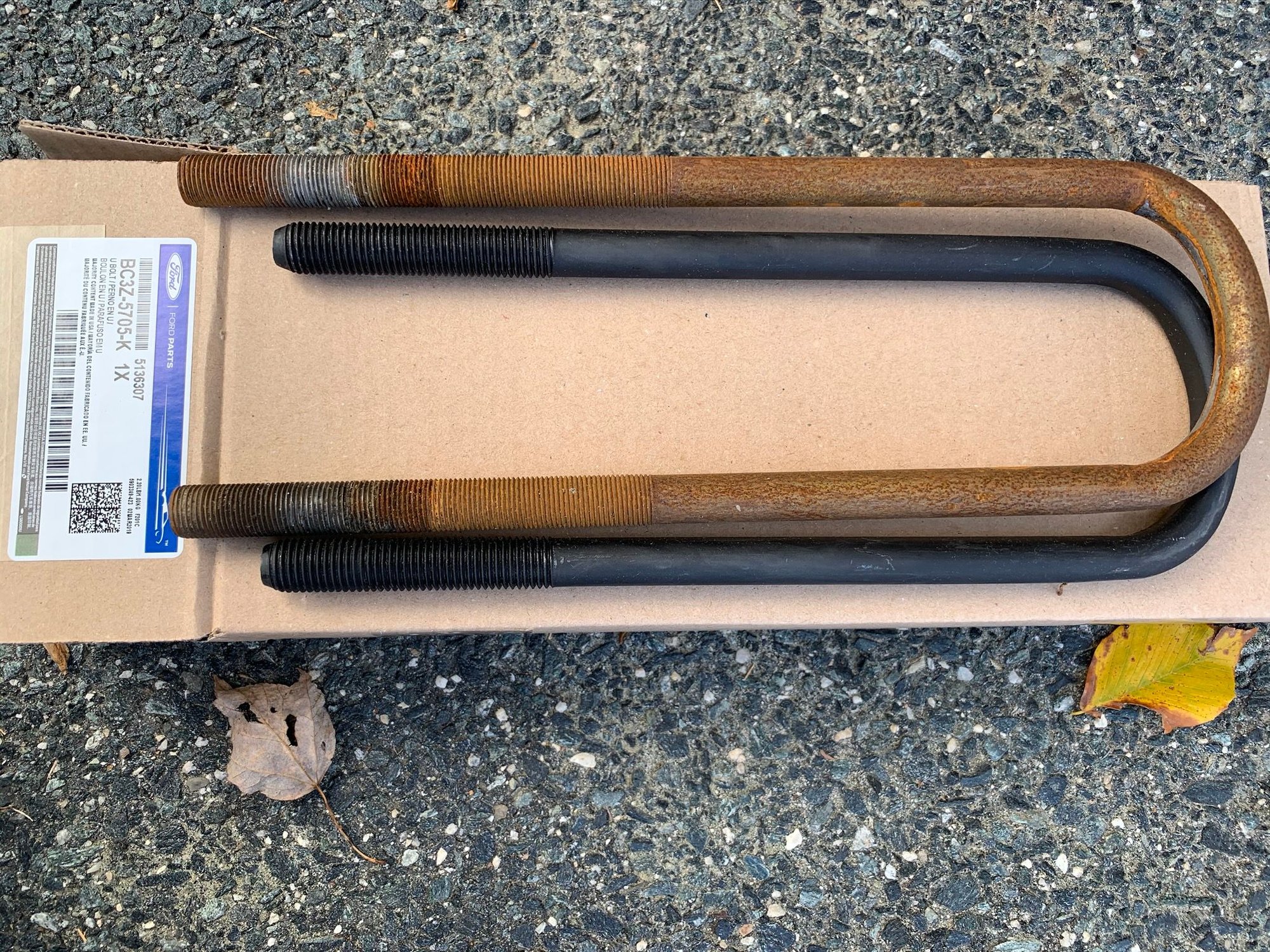

So, the U-bolts I bought from PMF along with their 2" blocks, were too long. I went to cut them down and discovered they were rusting. I know the rust wouldn't affect them functionally, but with a new truck and virtually no rust anywhere else underneath, they stood out like a sore thumb. Instead of cutting them down, I replaced them with Ford OEM U-bolts.
Thanks to BFT2017 for the summary post that identified various OEM U-bolts.
