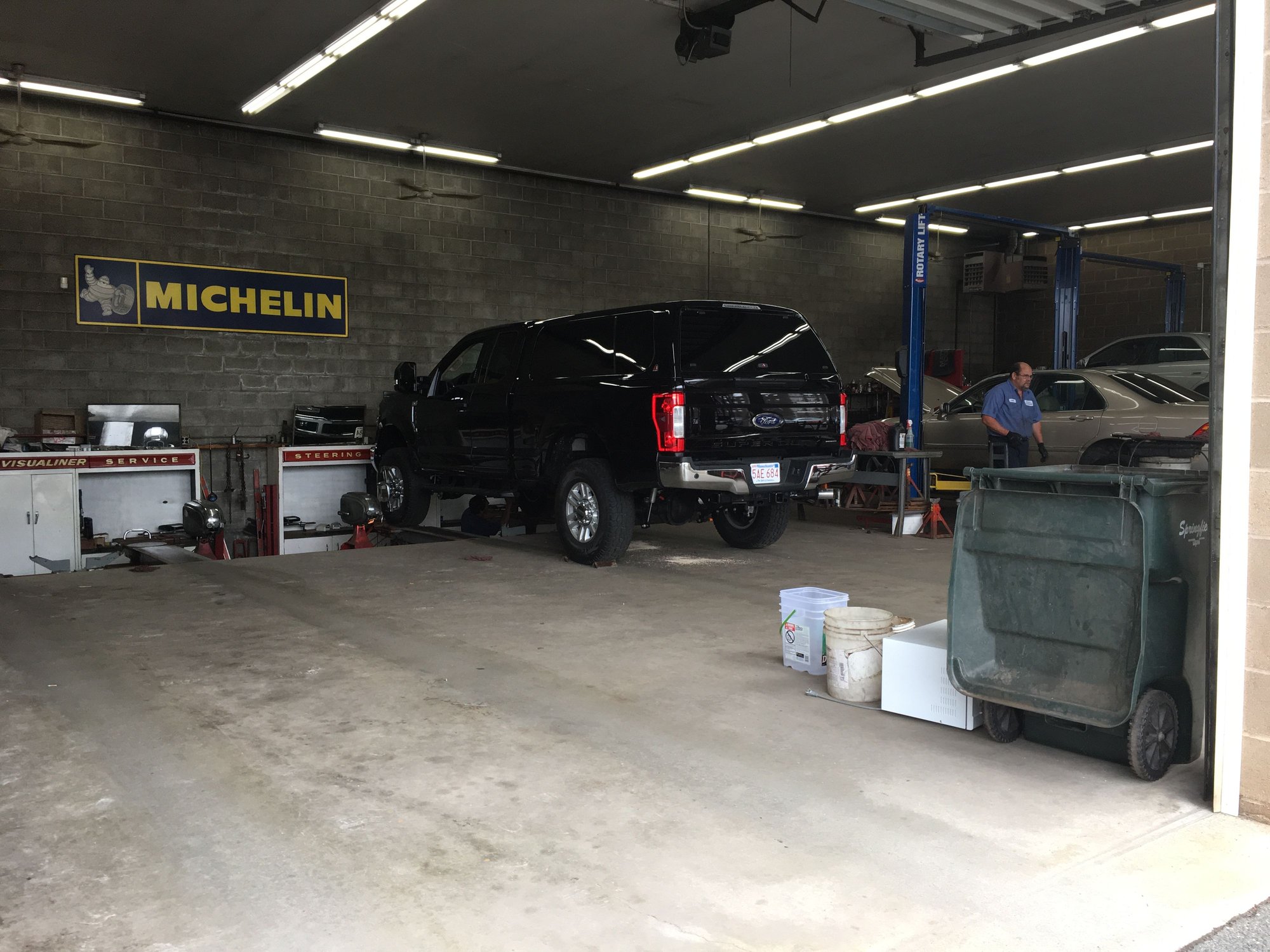

Steve's Alignment Shop Springfield MA! Great place. I forgot to ask what the caster is though.

Man I haven't seen one of those Alignment Machines since I was in my 20's and I'm 63 LOL. That Old School right there. Very Cool
right! I asked about those and the owner said they were from the 1950's

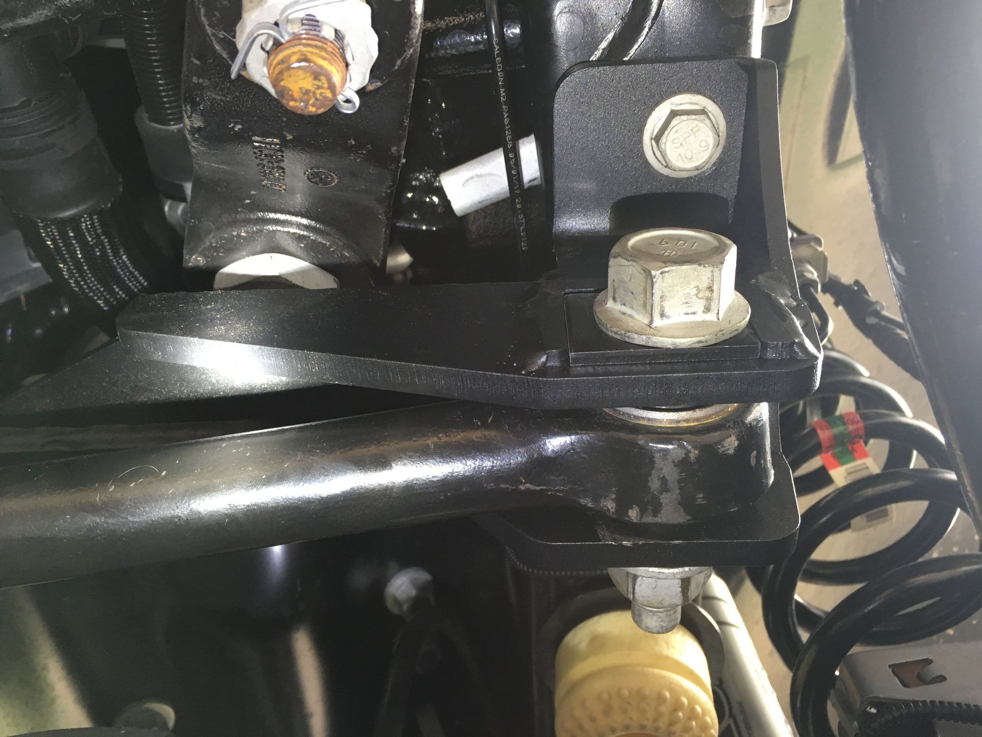

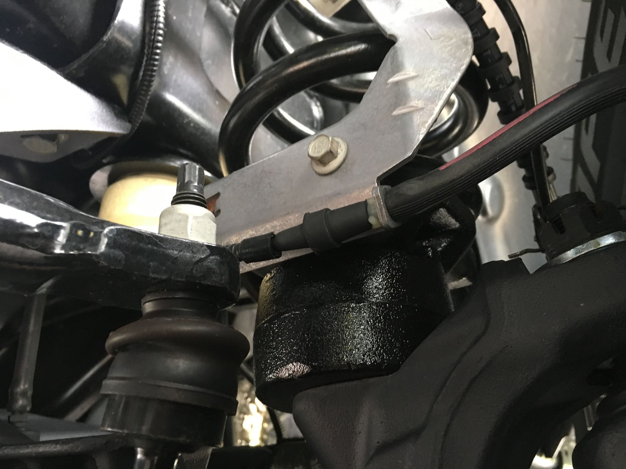

Just thought I would share some pics of the track bar relocation bracket and my pitman arm

Track Bar
that look
That looks different than the track bar installed on mine or it's possibly mounted wrong. It could be the factory one as mine says Readylift on the new track bar.

Its definitely not the stock ford mounting bracket lol. The BDS bracket comes with the square "cams" that can be installed 2 different ways based on the size of your lift. Those can be seen in the photos. It moved the axel to the passenger side too far and the square cams were not enough to adjust for it. The inherent problem with the bracket is that it only fits 2 sizes really. What I need is a fully adjustable bar so it can be adjusted exactly. I really wish Carli made an adjustable track bar for a 2inch lift.

LiquidStream I have a 2" lift with the Ready Lift Track bar bracket and it's dead center. Don't use the Carli Sway Bar drops brackets they need to redesign them after my pic's I sent them. There's 2 issues with them.

Well maybe I need the ready lift bracket instead?
