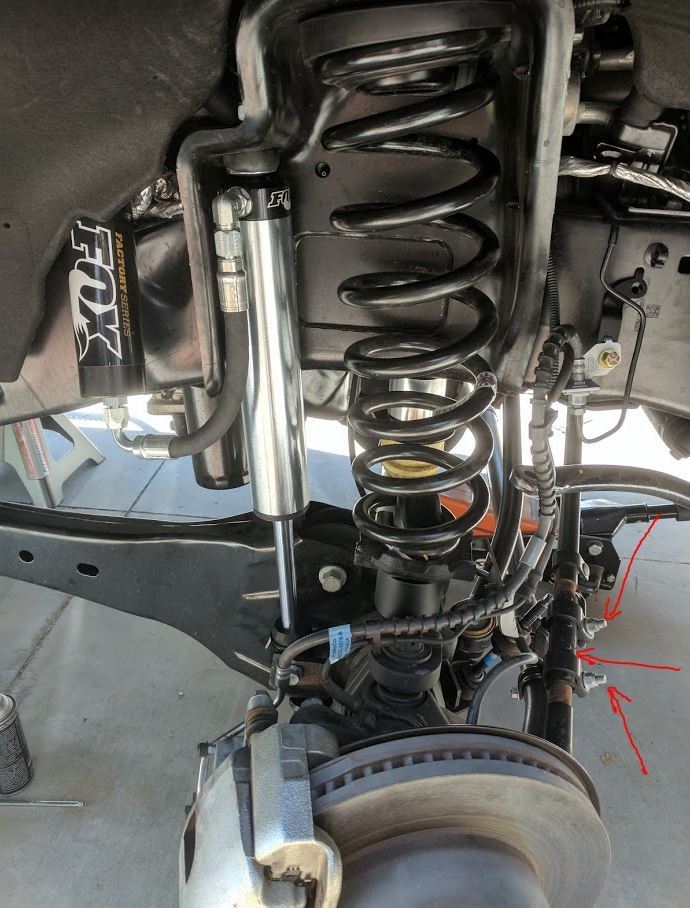

Are you just saying your steering wheel is cocked to the side? Or does it actually wander to one side while driving?
The cocked to the side thing is like a 10 minute fix. Its silly easy. You just loosen the two nuts, then screw the entire collar up or down to adjust your steering wheel left or right.
Edit: I just saw you said you are getting caster cams to fix it, then its definitely wandering. Disregard my pic. Ill leave it up there for peeps following behind, maybe they'll learn something

Thanks for the pic. Pulls to the left 'and wheel off center. Not happy about the install other than it totally got rid of the truck looking like you were "mashing the brake peddle after seeing a deer standing in the road at 60mph".. haha
