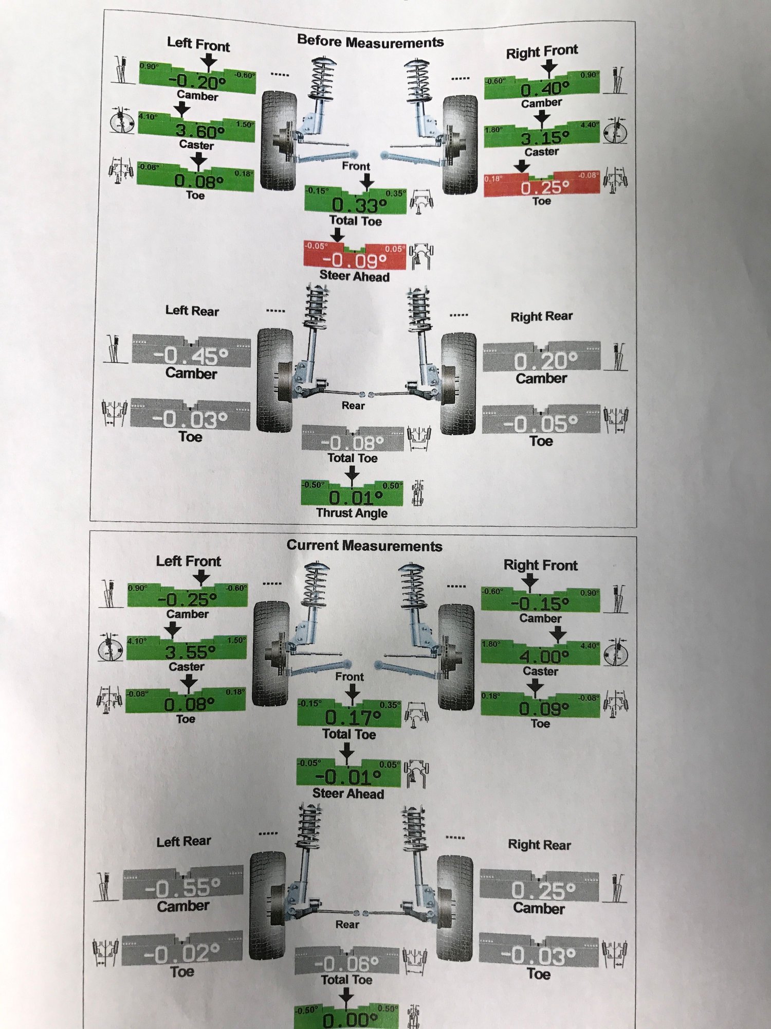

So off to the dealership i go today with my truck to see what is still causing my issue of the steering feeling light and sloppy especially at or over 50mph. Another call to BDS and the tech thinks i may have too much positive camber. They did agree to return the kit if Ford can't resolve the issue. Hope that's not the case as i'd be out a bunch of money for labor both from install and removal not to mention having to go out an buy new Fox shocks as there's no way i'd put the factory ones back on.
I mentioned to the dealership about possible issue with adaptive steering as it's night and day difference between under 50 and over 50. So I'll have to wait and see what they come up with.

Upon drop off i was already getting a tough time due to the leveling kit. The standard story of this won't be under warranty if there are issues, to which I understand to an extent. If there is an adaptive steering issue not sure how the leveling kit plays into that though.

So i just got a call from a BDS technician who states my steering wheel position sensor needs to be re-calibrated, which he claims can only be done by the dealer and he want the castor changed to 3.25 and 3.85 and that should fix my issue. Waiting to speak with the dealership to relay that information and see what i'm told.

This is where I set mine and it's like it was stock at any speed
That was my first thought. If you have the adaptive steering it needs to know where it is in the suspension cycle to know how much effort to put in. Its got to be the reason some guys have super twitchy steering and others are rock solid.
I like the KISS principle. I don't want a computer playing with my feeling with the road.
