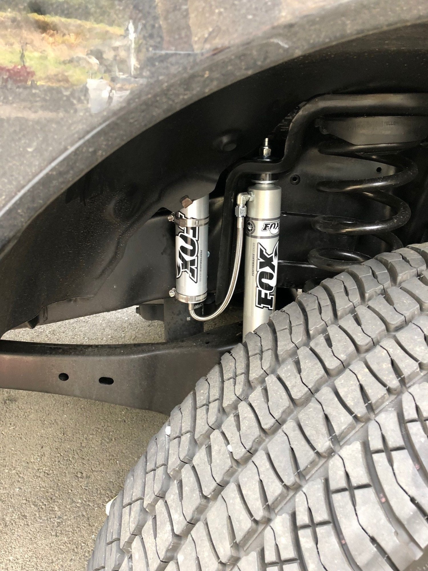

Can you take a close up picture of how you mounted the reservoirs?

Please excuse my dirty wheel liners. Haha. Fox could have given an extra inch of line (probably tells his wife that it's "12""). Wasn't too bad.

Center to center, it's about 4".

The shocks come with a small off-setting bracket that uses 2 screws to the chassis frame. Carli has a kit that mounts the resi in a hoop on top of the spring/spacer. I though the Carli mount would be preferred if you ran tire other than stock, but for now it looks decent to use the Fox bracket like I did..

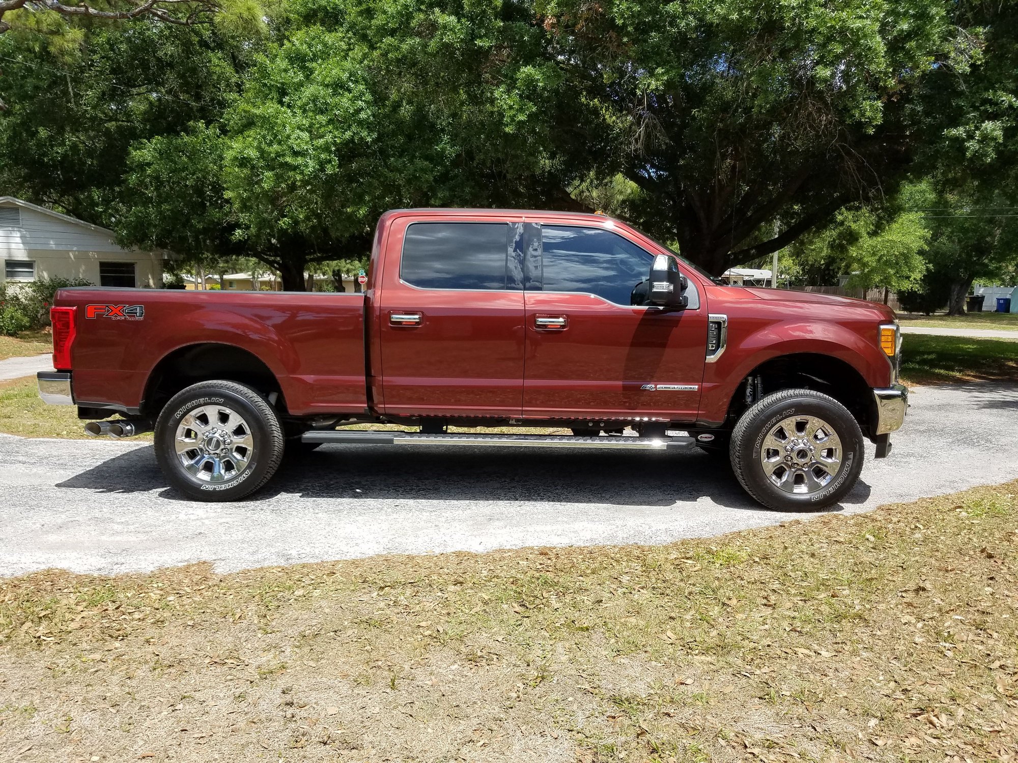

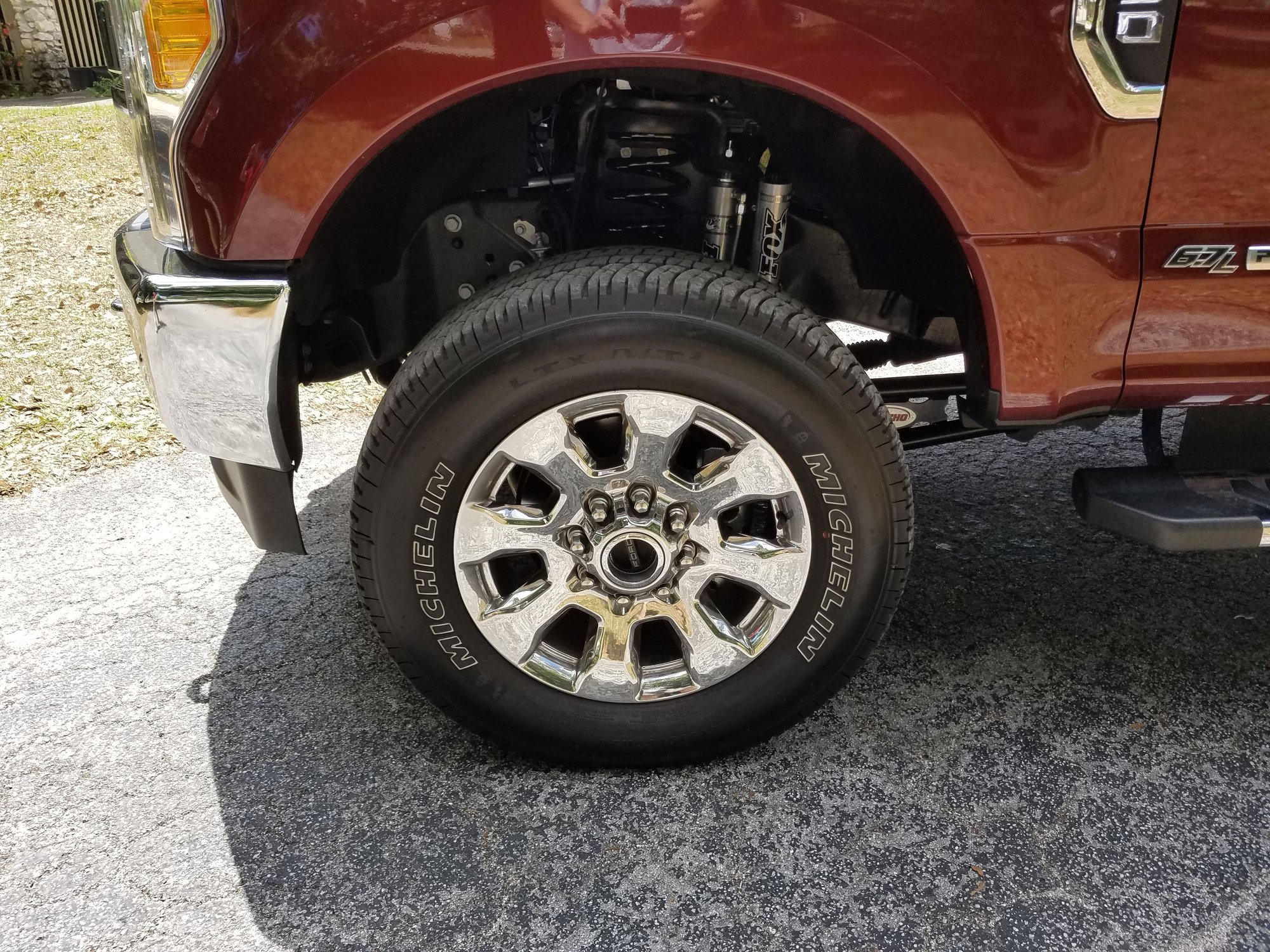

Rancho 2.5" leveling kit with radius arms and fox reservoir shocks. Stock wheels and tires (for now)
looks good. Sticking with a 35” or 37?
