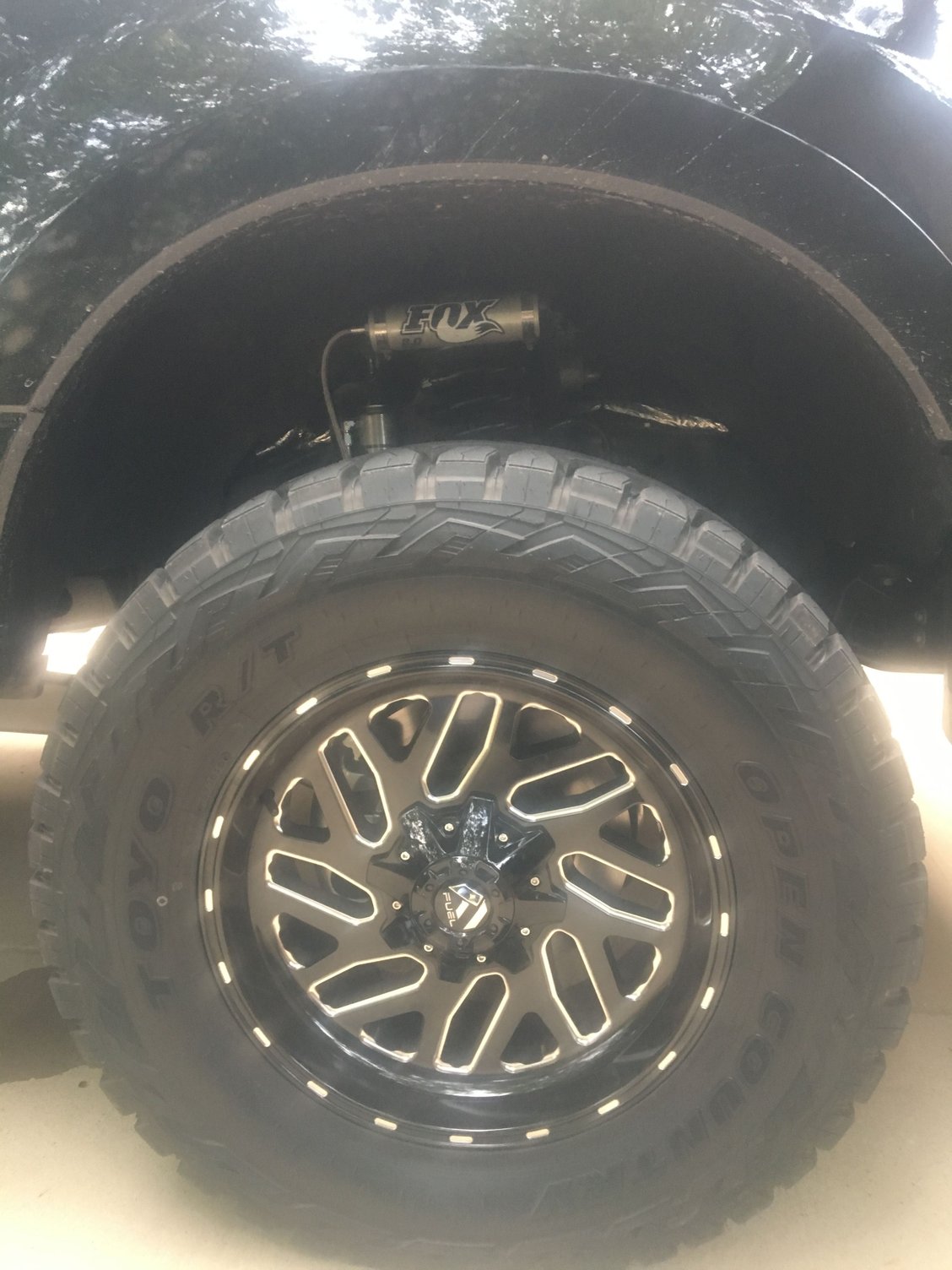

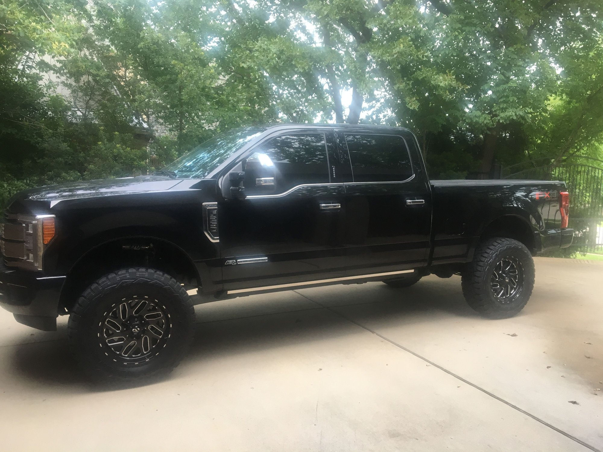

F250 Platinum with 2.5" Carli Backcountry 2.0. Add a pac springs, 2" rear block swap, and Ready lift Trac Bar Drop bracket (until the Carli Trac Bars start shipping!) Too Open Country R/T 37x12.50x20 on Fuel Triton 20x9 +1 offset. 2WD lower Front Valance. Good start for the truck only having 450 miles!!

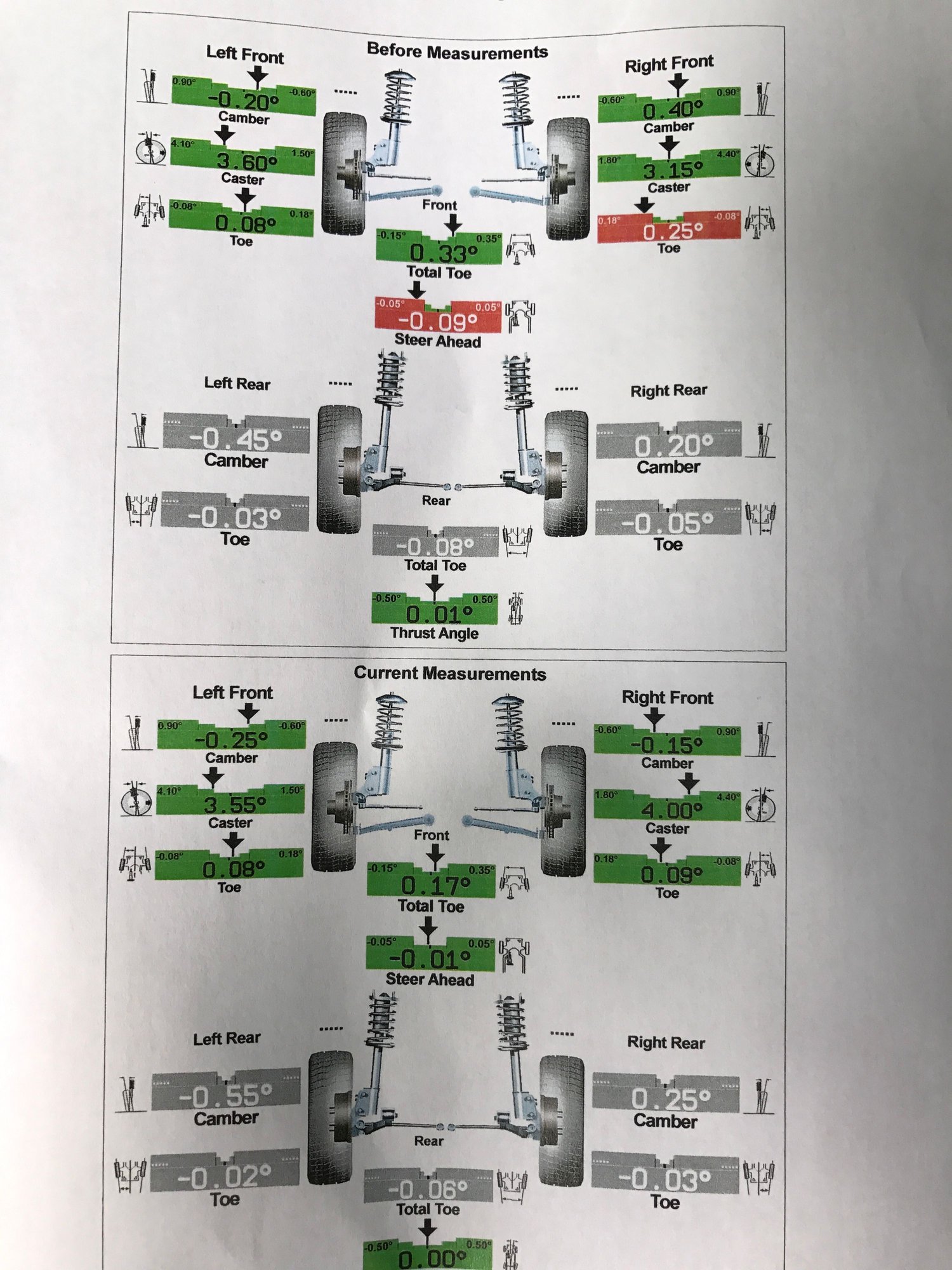

So i'm being told what little bit i feel now would be handled by a better steering stabilizer or dual steering stabilizer due to the somewhat aggressive tires.
Here's the print out.

I'm curious why the acceptable range for Caster is different from left to right. On the left, you have 1.50-4.10 and the right is 1.80-4.40.

the crown of the road.

Really? Must be new. The ranges on the 2016 are the same for both left and right @ 2.30-4.70.
And wouldn't camber be compensated for crowns in the road?

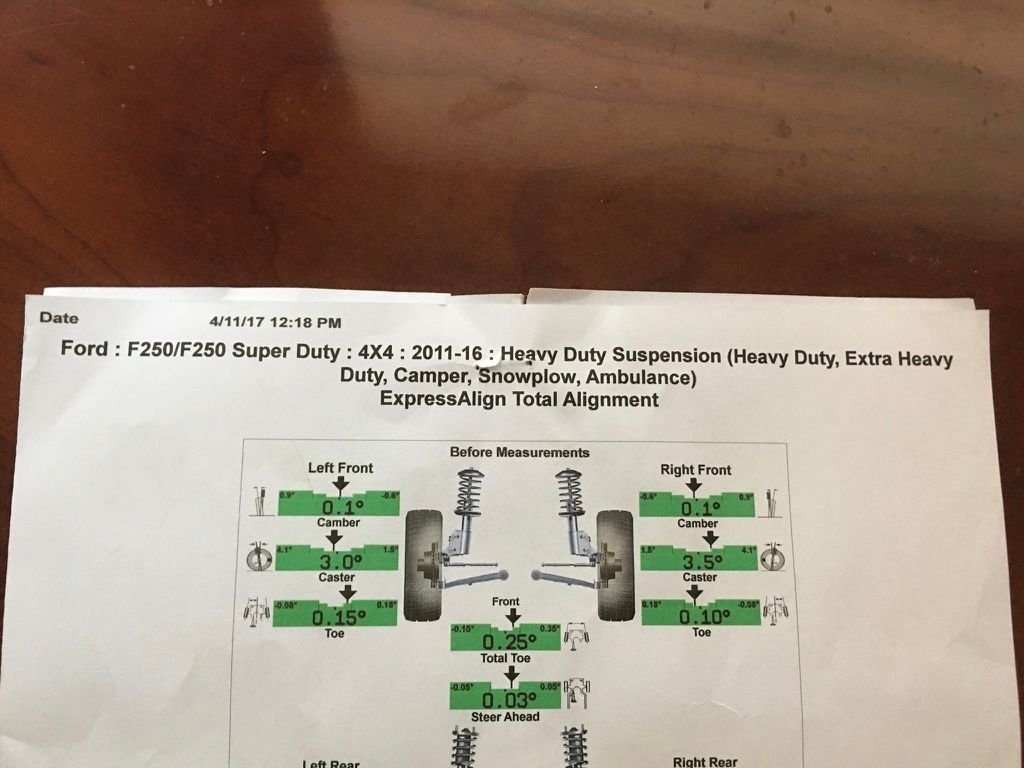

This is where i set mine and it drives like it did off the show room. I did adj the Tow a little.
