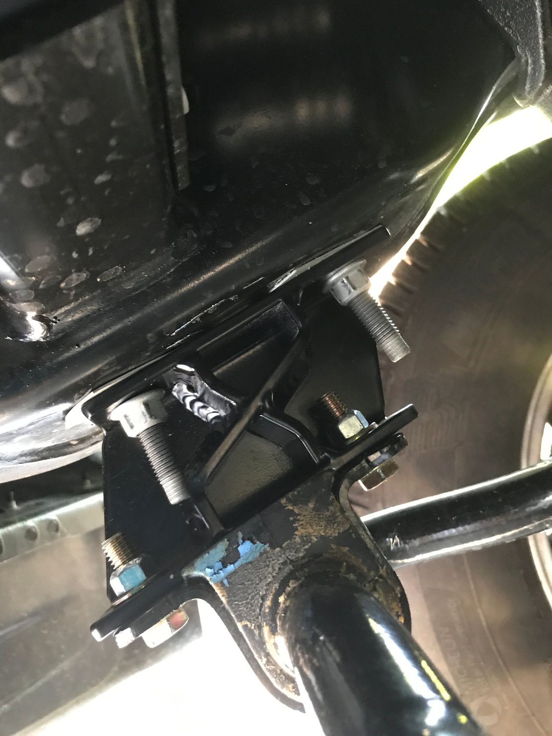

Originally Posted by Hackenbush
LiquidStream I have a 2" lift with the Ready Lift Track bar bracket and it's dead center. Don't use the Carli Sway Bar drops brackets they need to redesign them after my pic's I sent them. There's 2 issues with them.
What issues did you have with them??? I have some sitting in the garage and plan on installing next week.
His were the newer X brace design. One of the bolts was hitting the bracing and bending it out. They said it could snap with a hard enough hit. Check his post history and you'll find a pic he posted on it.
Found it.......looks like a simple fix. Maybe just trim that bolt a little.

Yea just be careful trimming that bolt. They snap real easy up inside the frame. There sending me a new set so I don't have to trim the bolt. I didn't want to cut anything because of warranty. They see anything suspension related cut off and they have an out. You would need to trim 1/4" at least off. I asked them to send me the ones like in there picture and the engineer told me they were not for 17's wouldn't work.
