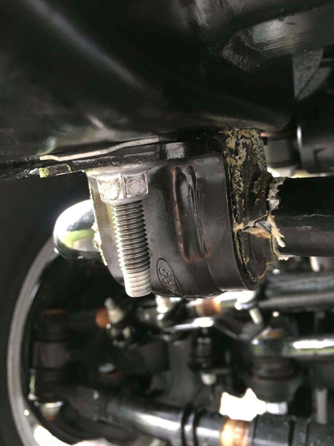

Originally Posted by Hackenbush
Yea just be careful trimming that bolt. They snap real easy up inside the frame. There sending me a new set so I don't have to trim the bolt. I didn't want to cut anything because of warranty. They see anything suspension related cut off and they have an out. You would need to trim 1/4" at least off. I asked them to send me the ones like in there picture and the engineer told me they were not for 17's wouldn't work.
what are they sending you? a redesign?
I noticed the same thing with the bolt. didn't think it was right, but at the same time didn't think too much of it. it works

Those bolts snap real easy and the pressure/angle on the bolt may help it along. There gonna call me and let me know, It's in the engineers hands right now. I flipped them around and it helped a little. I guess there is a left & right, one of the gussets is a little shorter. Guess we will see. Defiantly don't want to pop one of those bolts on a pot hole at 75 on the interstate.

Went to carli yesterday so they could take some measurements of the factory sway bar stuff. They gave me a shirt and hat for my time and said they'd send me whatever they decide on the redesign.
In the meantime, got around to installing my carli springs, bump stop drops, sway bar drop brackets (grinded down the factory bolts about 1/4 inch with a bench grinder), readylift trac bar bracket, one up off-road resivoir mounts.

How did you grind down the bolts with a bench grinder ? Did you remove them and reinstall them into the frame ?
Old Jul 19, 2017 | 11:37 PM
  #159
FmaxTurboSi's Avatar
FmaxTurboSi
Joined: Mar 2017
Posts: 357
From: Riverside, CA
Yes......when the brackets are removed, you can slide the front bolt toward back of truck to remove it. Took me about a minute to grind each bolt. I grinded it down just before the threads start, that way I didn't screw anything up. Slid them back in and it worked like a charm!!!
