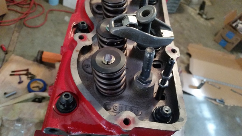

My setup is a single nut on a 3/8" stud. The nut is crimped so that it doesn't back off, much like the ones with a nylon insert. It takes some good effort to rotate them, and they can even be a little warm after removing them due to the friction. They're definitely not going to back off by themselves. Even then, there's not enough room on the end of the stud for another nut.
Due to being adjustable, they're not really torqued (like stock). Make sure the valve is 100% closed (cam lobe facing away from the lifter), then tighten the nut down until there's zero lash (can't move the rocker tip away from the valve stem / can't move the push rod up and down) and then give them another 1/4 to put some pre-load on the lifter. Not much to it.
I've thought about them being too tight, but I also tried adjusting them while the engine was running. Back them off until they clack, then tighten them until they stop, then another 1/4 turn. It didn't seem to make much difference. And yes, a valve cover with an accessible top is great.
Thanks for tossing ideas back and forth. Something's gotta be causing it, so it's just a matter of nailing down what.
