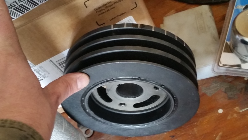

I'm fairly certain the timing marks are correct, but not 100%. I have a new harmonic balancer, but after I installed it, I realized that it ONLY had the timing mark for the passenger side (first balancer I've ever seen with that). I don't have those marks on this engine, and only have the marks on the timing cover. So, I didn't have a completely accurate way of getting a correct timing mark. I wish I had known that before I installed all the gaskets and covers, I'd have just lined up the two marks on the cam/crank and made sure it was completely at TDC.
Either way, I brought the #1 piston to what visually looked to be the very top. Then, I rotated the crank until the flywheel bolts were completely symmetrical (which was, maybe 2 - 3° of crank rotation).
Then, I marked the harmonic balancer at 0°, rotated it until the new mark lined up with 10°, marked again, etc. etc. until I had marks for 0 - 60° advance.
So.... Fairly certain my marks are correct, but not completely.
Attachment 193411
Attachment 193412

Hey AB. I just heard from Pmuller9, and he mentioned that 2 1/8" from the tdc mark = 36* advance. What do you have?
AB, I don't mean to sound like a snob or d...., but you have to come up with a way to test for an accurate tdc. I'm sorry, but you flunked second grade! Ha ha. I know it's easy for me to say when I'm not doing it. No offense intended.
No worries, it's a legitimate question/concern and is something I've been thinking about.
2 1/8" for 36° makes sense as, if I remember right, the 300 uses a 6 3/4" balancer.
6.75 * 3.14159 (pi) = 21.2" around.
21.2" / 360 = 0.059" per degree. (Roughly 1/16 of an inch.)
36° * 0.59 = 2.124"
2 1/8" = 2.125"
Honestly, though, I'm about 99% certain my timing marks are very accurate, or at least close to. If they're off, they're only off by a few degrees. Certainly not enough for a 15° difference (which is about an entire inch). I did this with the engine out, so I could very easily see down the #1 spark plug hole. I brought the piston up until I saw it stop moving and marked the balancer. Then, I continued moving it until I saw it just start to move down again and marked the balancer. The difference was not very much. I then visually used the flywheel bolts on the crank shaft to line it up and find the exact center between the two points, since they're symmetrical to the pistons (as you can see in the picture).
The marks every 10° were then made by lining the harmonic balancer up with the timing marks on the timing cover, which are already set and measured to the balancer.
That said, I do like the method mentioned by you, FTF. I had never seen/heard of this tool before, but it makes perfect sense. I am also seeing that they're available online for about $15, which isn't too bad. I'd make one myself but lack the tools to do so.
