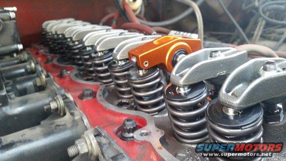

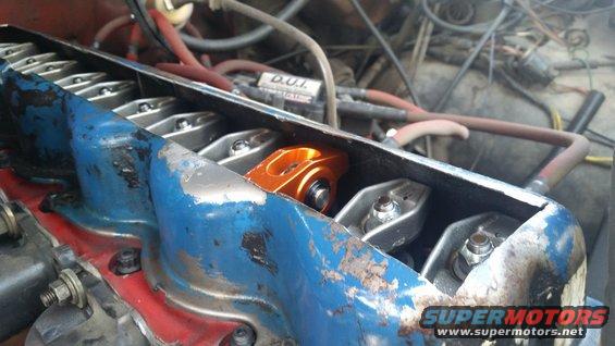

So, this weekend I went out and decided to see what I could do with the rockers.
I really want to kick myself because after weeks of looking over different types of rockers from different engines, manufacturers, etc, I had to keep in mind I was looking for rockers that would fit a 3/8" stud (not the 7/16" that is much more common.) I specifically avoided certain brands because they only sold a 7/16" and I didn't want to swap my studs out too.
So, when I finally ordered the Harland Sharp rockers, what did I do? I ordered 7/16" stud rockers!! When I realized this, I was so put out I just laid down in the garage and stared at the ceiling for a good 5 minutes. What the heck was I thinking?
Either way, they're on their way back to Summit, and the correct ones should be here soon.
But still, I had them in hand, so I had to check them out. The first thing I noticed is that they're very very close to the shape of the original rocker arm. Also, the roller lined smack dab up with the center of the valve stem, so I'm thinking I'm going to get away with the same push rods I currently have. Since the nut was too big, I couldn't tighten them down and roll the engine over, but I could set them in place and check some basic geometry.
Now, another thing I noticed is that not only are the similarly sized to the stock rockers, they're almost identical. Granted, since I can't tighten them down, I can't check clearances when they rock, but I am honestly thinking I do not need a spacer to make more room for them. It's almost like Harland Sharp, when designing these rockers for the 300, took the room available into account.
This is without the spacer in place:
I won't know until I get the proper set in hand and can tighten them down, but Harland Sharp rockers just might fit under a stock valve cover.

Thanks for posting the photos and I hope this eliminates the illusive squeak!

Hopefully you did not soak them in oil before you noticed they were the wrong size. I'm sorry about the mix up. You were just excited to get them. They sure look nice sitting there, don't they? See what I meant when I said it was painful to cover them with a v.cover? I'm sure the r.r.'s will eliminate the squeak.

And yeah, they're sharp looking! I need a clear valve cover.

Originally Posted by AbandonedBronco
... Harland Sharp rockers just might fit under a stock valve cover.
You will probably have to grind off the corners of the ones that are nearest to the indentations for the hold-down bolts.

I was surprised to see in that photo that you're running the DUI again. Did you determine what the issue was?

I put the DUI back on about a week or two after the engine was installed. The issue turned out to be a bad brand new spark plug. I initially swapped everything ignition related out. Spark plugs from the old engine, the DuraSpark setup I keep in backup, wires, etc. and it ran great. So, then I slowly swapped parts back until I narrowed down the issue.
Some parts guy behind the counter must've dropped one of the plugs or something.
