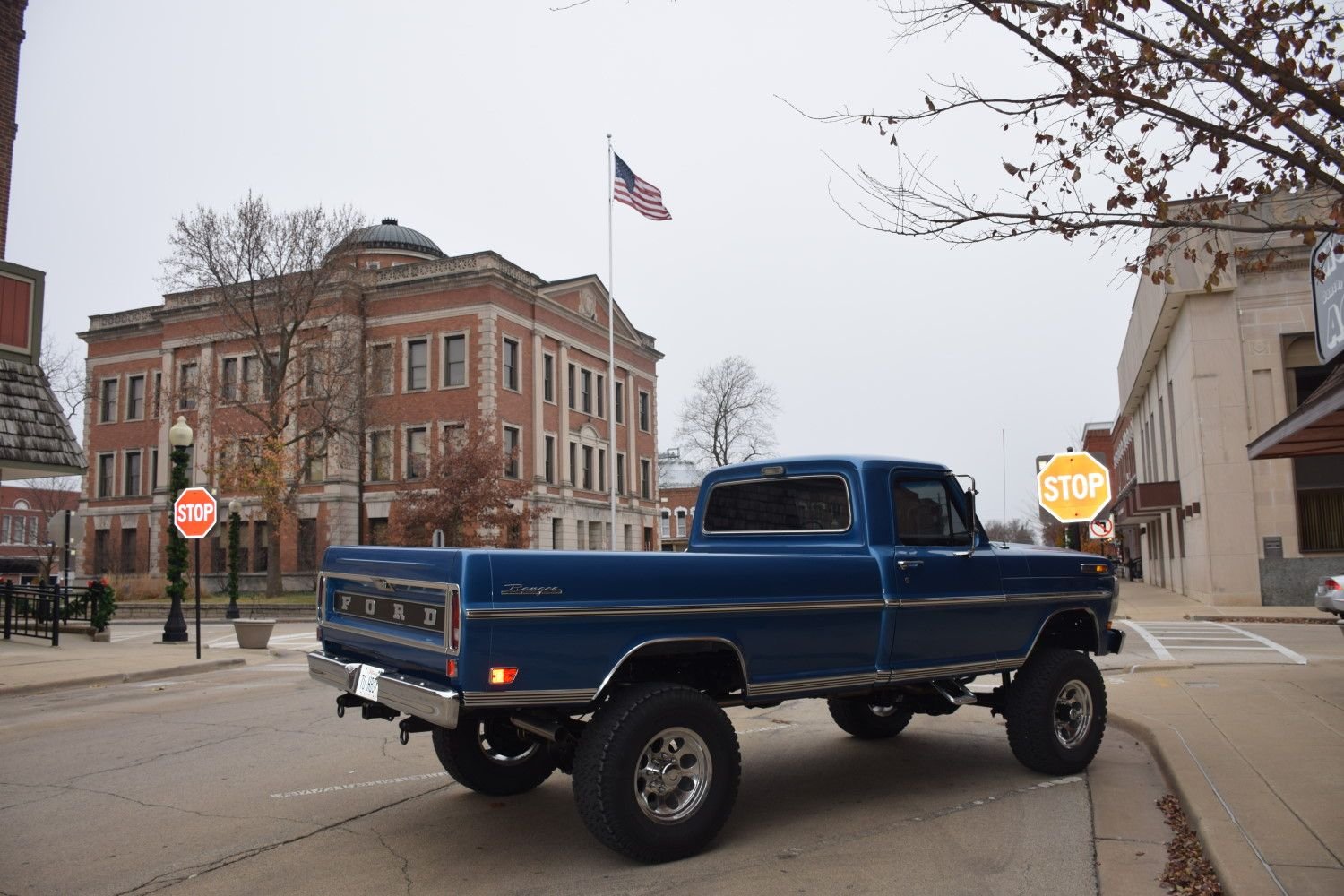

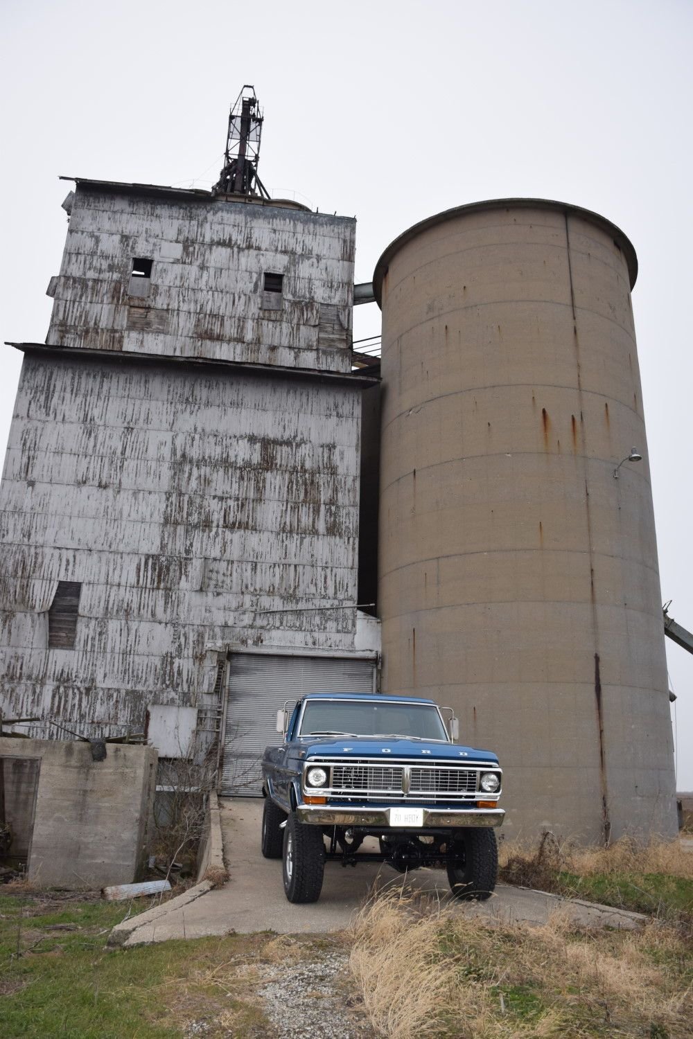

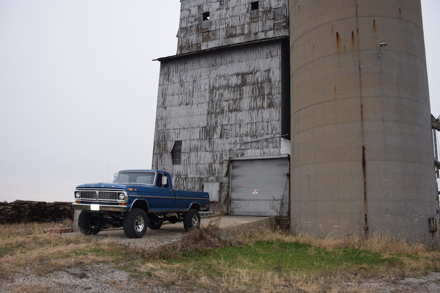

I've had a chance to put over 100 miles on the truck the past couple of months and I have a few observations.
Starting:
The Summit Racing 600 CFM carburetor is fantastic! All I had to do was adjust the idle it starts easily hot or cold and throttle response is excellent.
Drivability:
The biggest issue I have with the truck is bump steer. The first time I hit a bump and the front of the truck shot to the left I thought something was broken. Someone had suggested that I switch from push pull to crossover, I didn't think it would make that much of a difference. I was wrong. I need to take a leaf out of the front spring pack to soften the ride. The Skyjacker rear leaf springs along with 10 psi in the air bags works great. I also went from 50 psi to 35 psi in the tires, that also helped to smooth out the ride. The power steering is typical of an early seventies car, there is no feedback and the brakes are extremely touchy. It will take some time to get a glaze on the front discs and rear drums.
Drivetrain:
This thing needs overdrive so bad. Instead of the 4:10 gears I should have gone with 3:73 or something lower. Other than that the NP435 works great.
No buzz, squeak or rattle to speak of. When I first ran the engine the two-piece header on the passenger side was rattling but one sheet metal screw took care of that. The cab is nice and quiet until you hit about 45mph and the vent windows start to whistle. The exhaust is perfect, it's not too loud until you hit a about 2500 rpm under a load.
Issues:
The rear main is leaking at the rate of about drop per week. The PTO cover on the NP435 is also weeping oil. I have a couple of leaks in the on board air system and I'm thinking about getting mud flaps because the tires are rock chuckers.
Overall I'm happy with the truck. It's a blast to drive!
