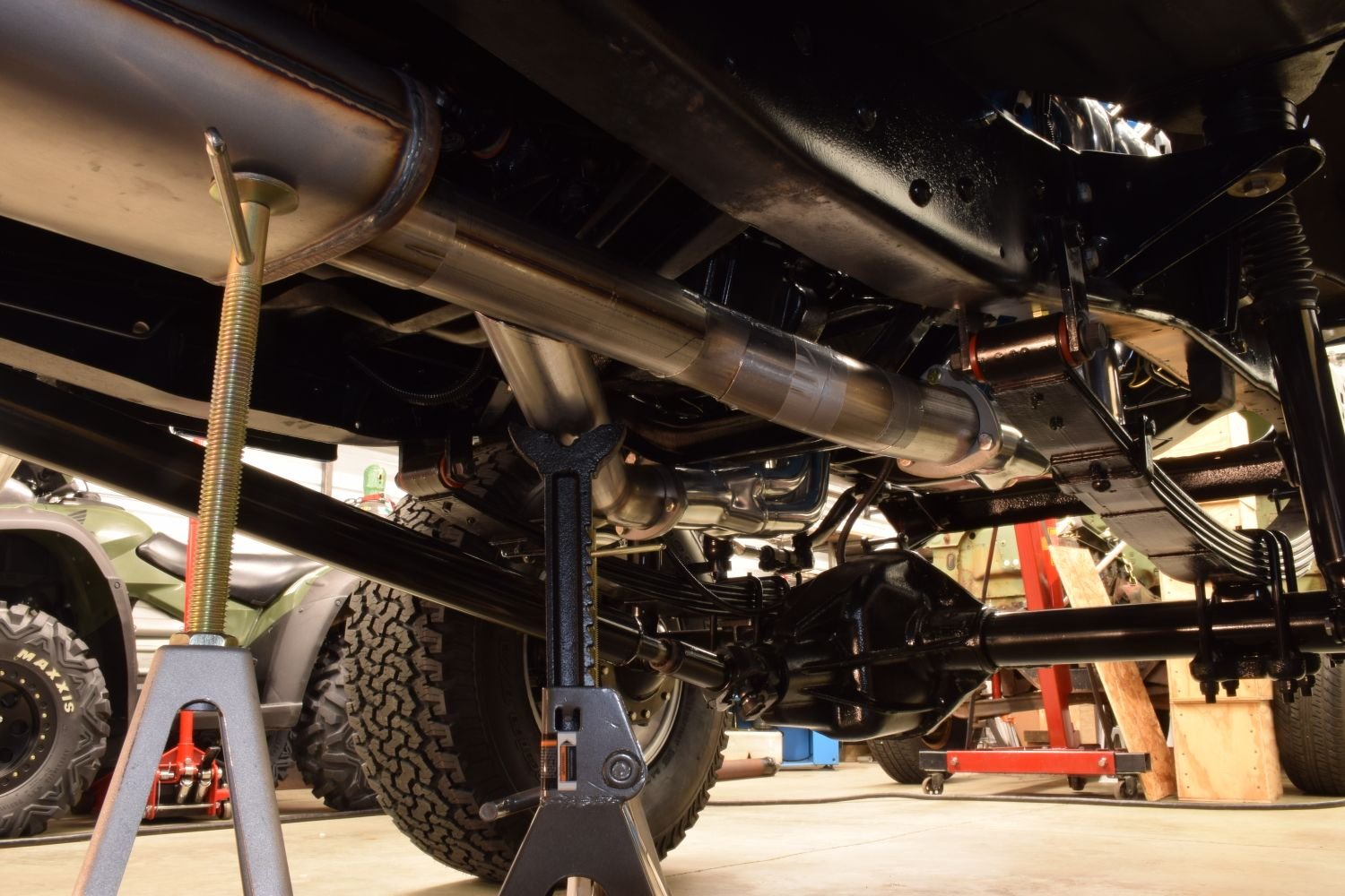

If you are really good at TIG welding you might want to have bucket handy, the pics below might make you sick.
I got a little more done on the exhaust.
I got all of the pieces cut for the passenger side collector to muffler pipe and ummmm.......duct taped them together so I could tack weld them......and it worked!
After the duct tape was removed I made the worlds ugliest TIG welds.
I need more practice.....a lot more practice.
I had to use the MIG for the weld at the Y.
From the muffler on back should be a bit easier.
