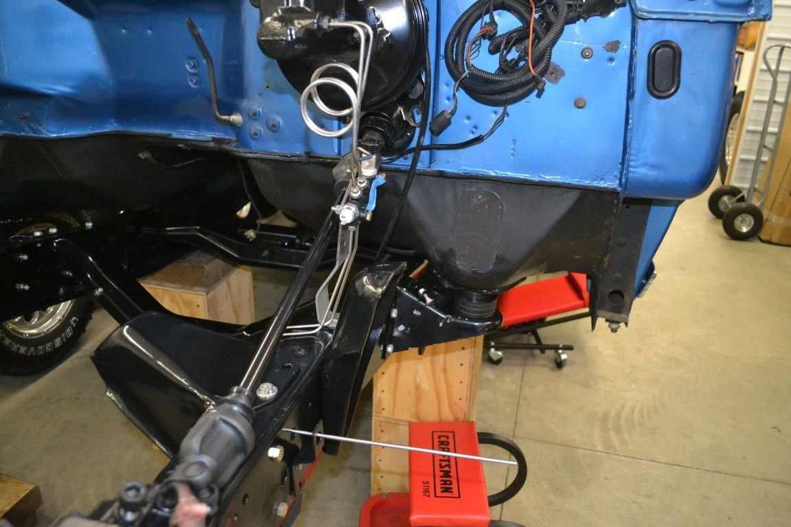

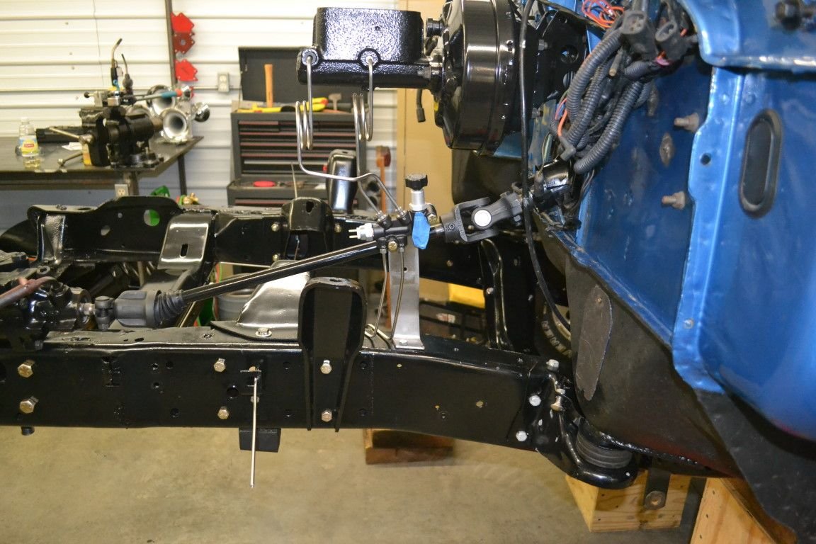

I used a Wilwood proportioning valve mounted it on top of the existing brake line bracket.
The front line out of the master cylinder (for the rear brakes) needs to be located 3" further back to avoid hitting the windshield washer fluid tank.

Nice clean look! I may go that route but I need to find out if it is a disc/disc valve.

Nice looking brake plumbing.
