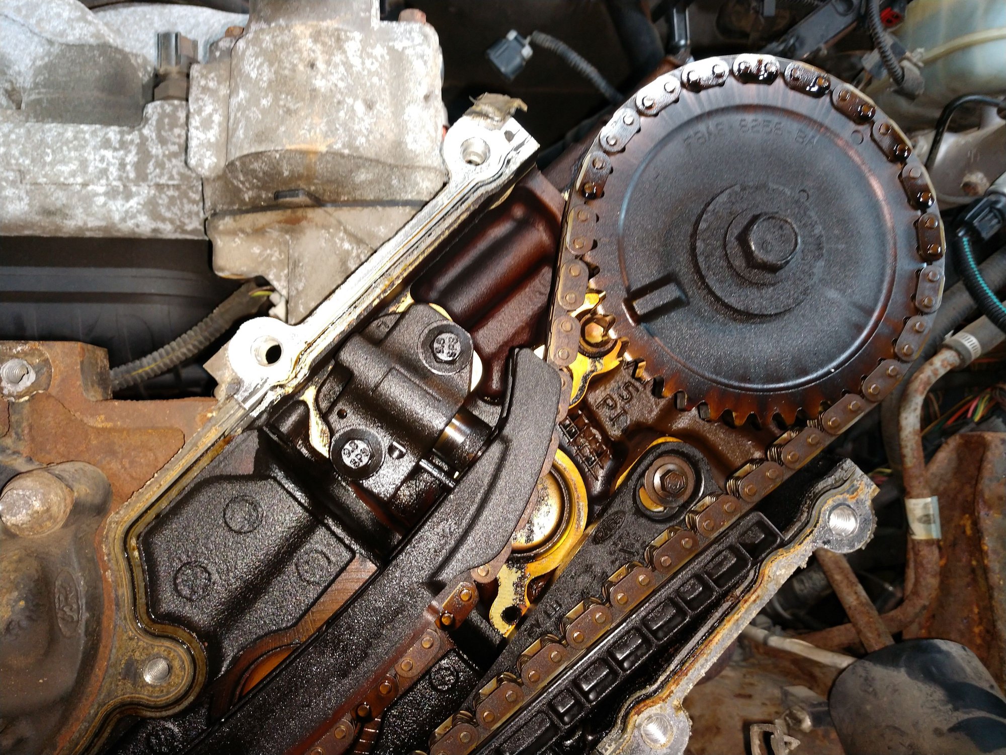

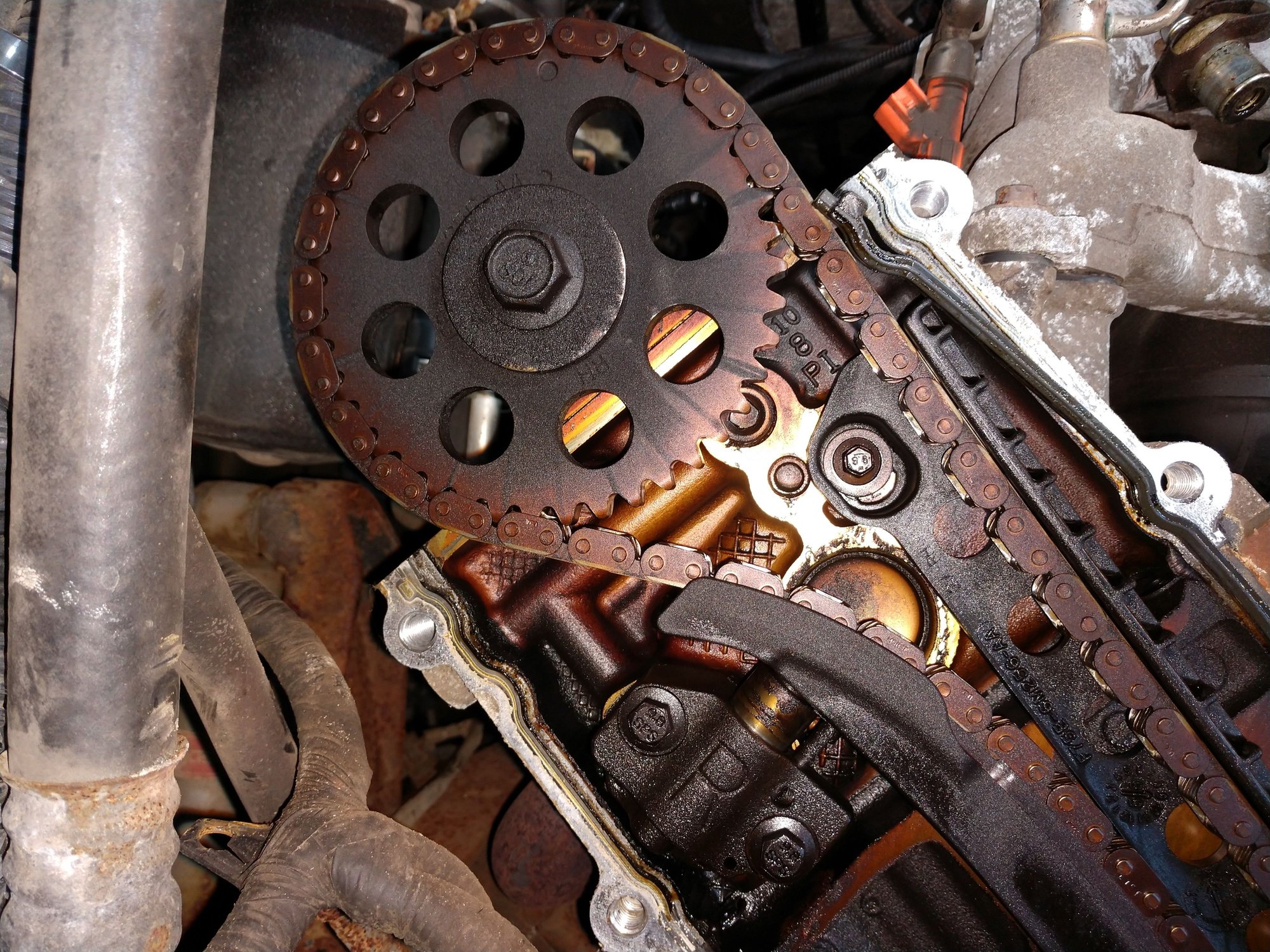

Under the gear PI is cast into the heads.
Under the cam shaft sprocket, PI is cast into the heads. Does this mean I have the Performance Improved version?

Yes, having the "PI" cast marks on the heads identifies them as the Performance Improved version, there is also another PI on the side near the spark plugs. By the start of EX production all V-10s were fitted with the PI heads but the earlier models still had the short spark plug threads, that was revised in '03 to the longer threads.
Everything is looking great so far, you have done a lot of work!

Thanks for the info on the heads! We're so excited to be making progress on it again. It's been close to 3 years since we driven it. I'm disappointed it rusted so bad on the damp concrete last year. But that makes it a good practice vehicle for learning body work. Hopefully we can eventually find a nice rust free EX to build. I'm struggling a bit with my desire to make it really nice vs what's practical because of the rust. Thanks for replying.
