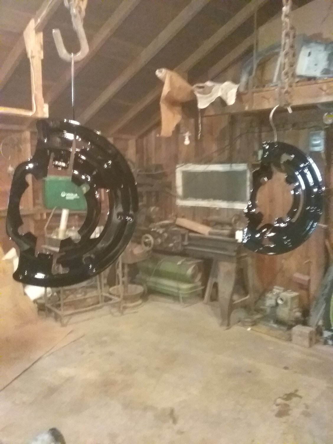

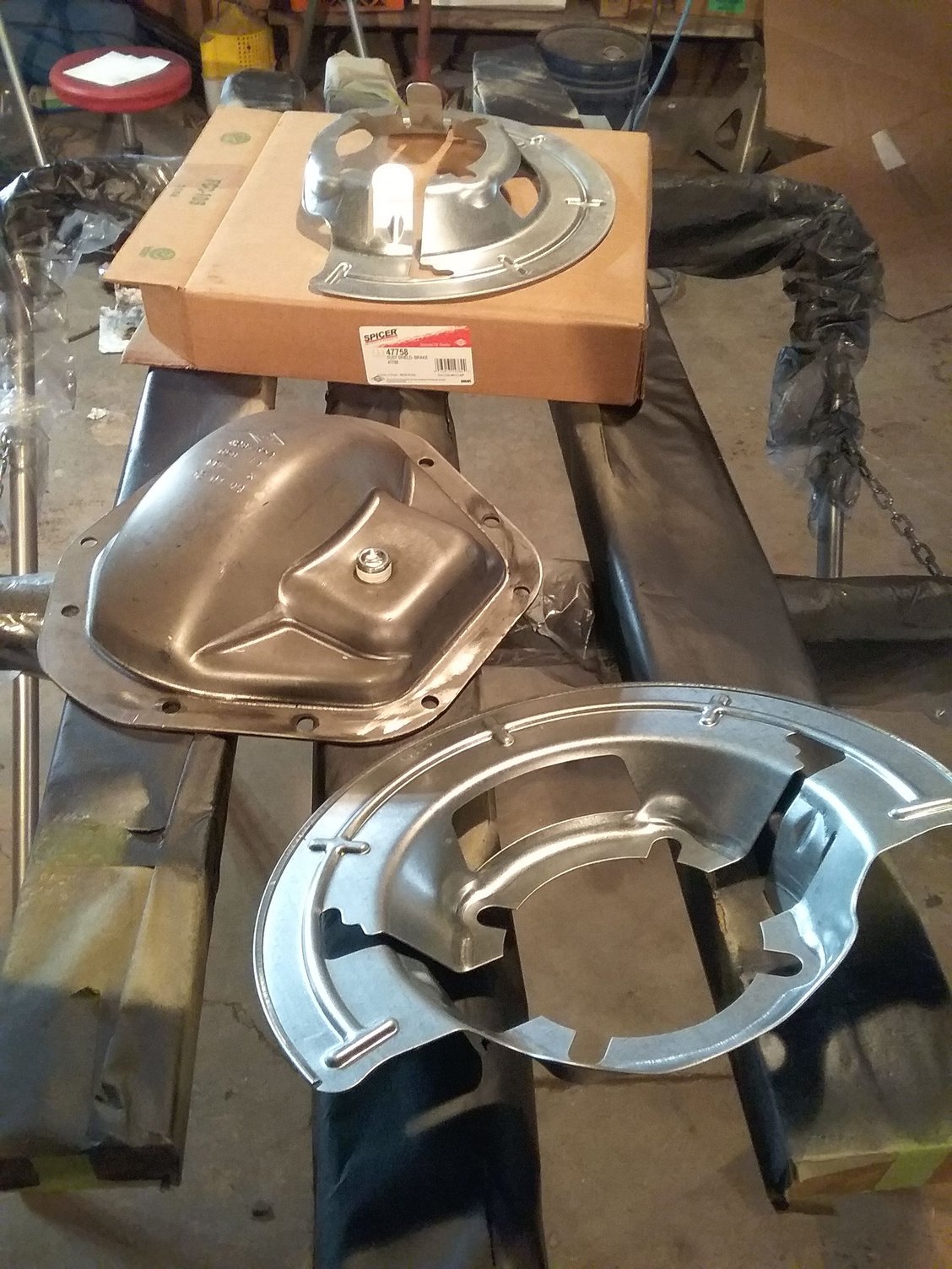

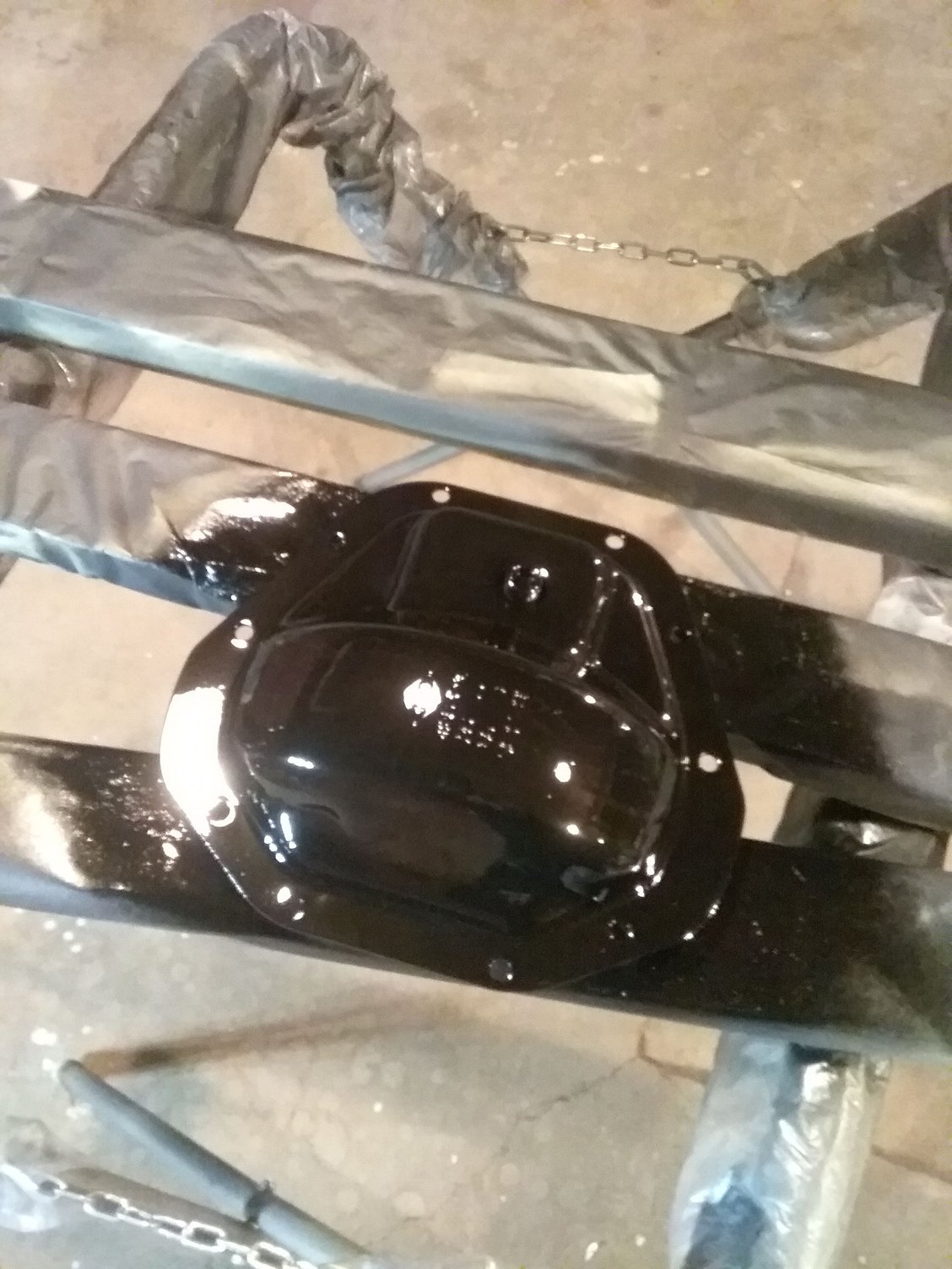

Getting ready to install the gears. Hopefully next week.
The one on the right is scuffed and ready for epoxy primer.
1st coat of clear
These kept moving when the air from the gun hit them. I need a better way to hold these. Good thing they're only brake dust shields. They have marks from trying to hold them still. Better to learn on these then something that would be seen.
