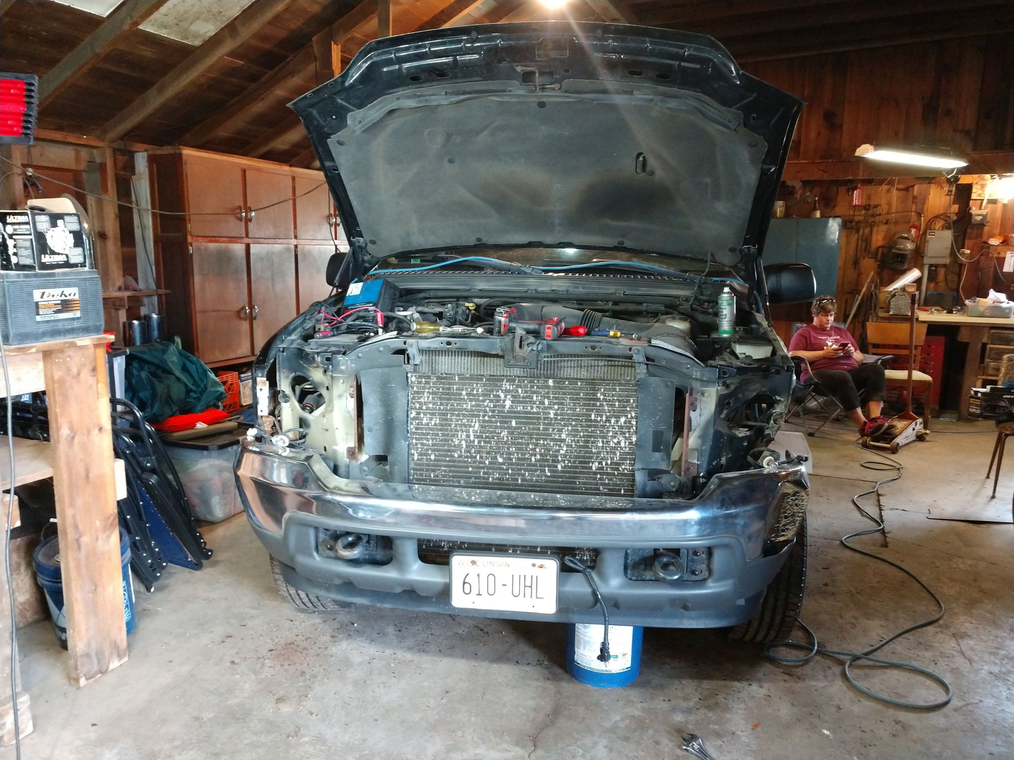

Here's some before pictures. The Pearl is getting the 4" Procomp lift recommended by Pirate4x4. Thank you sir, I can't wait to try it out. It's also getting the 05-07 front end.

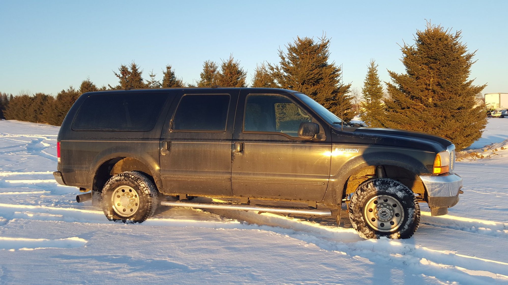

I couldn't find any pics with the fender on.

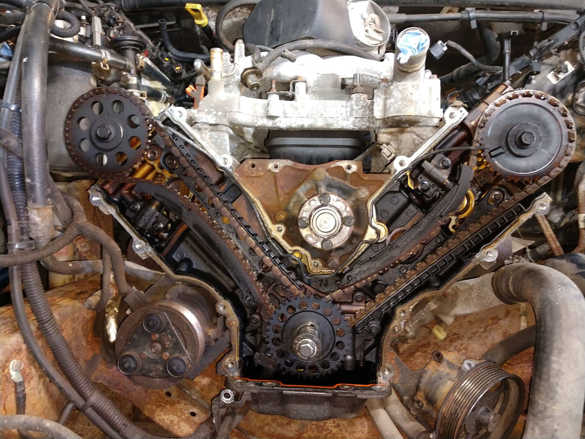

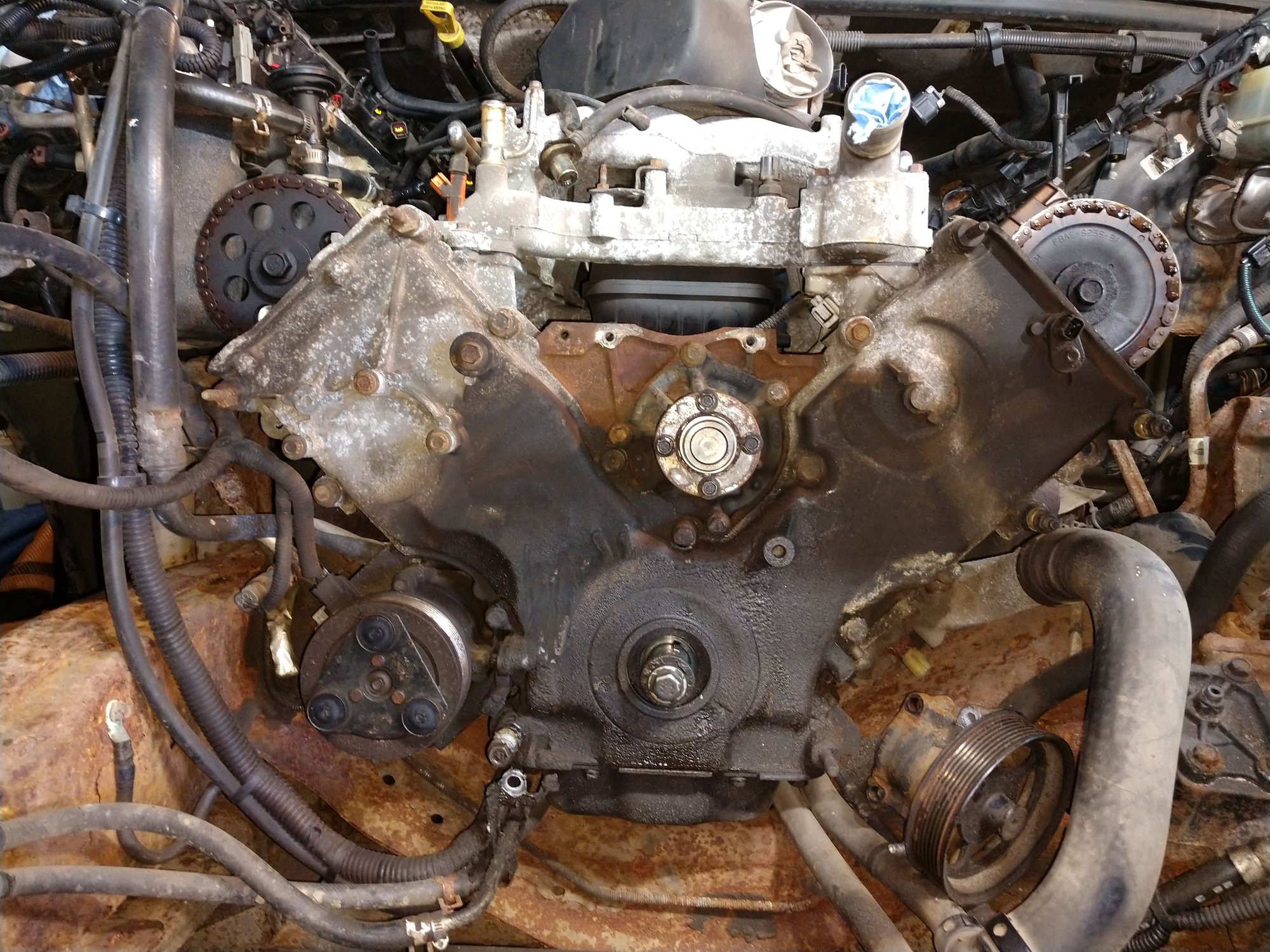

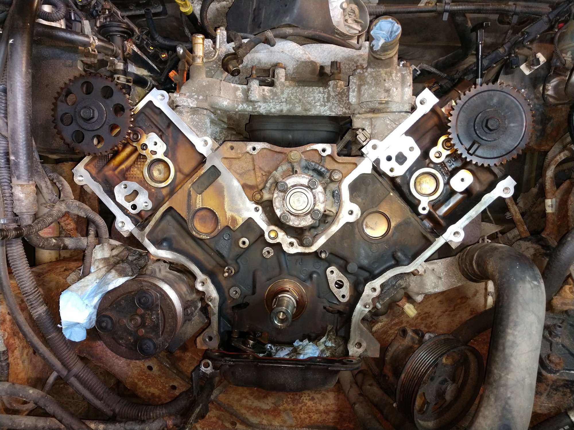

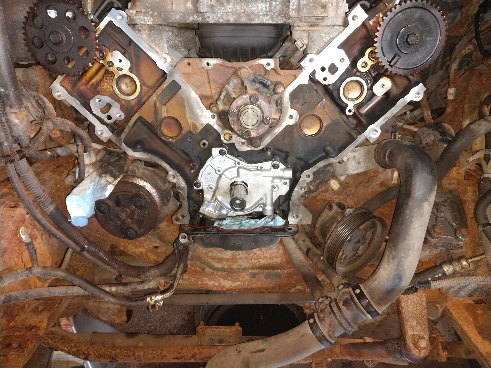

We had a ticking/slapping noise so I decided to change the timing set and oil pump. It runs much smoother and quieter now.
Also trying to end some oil seepage.

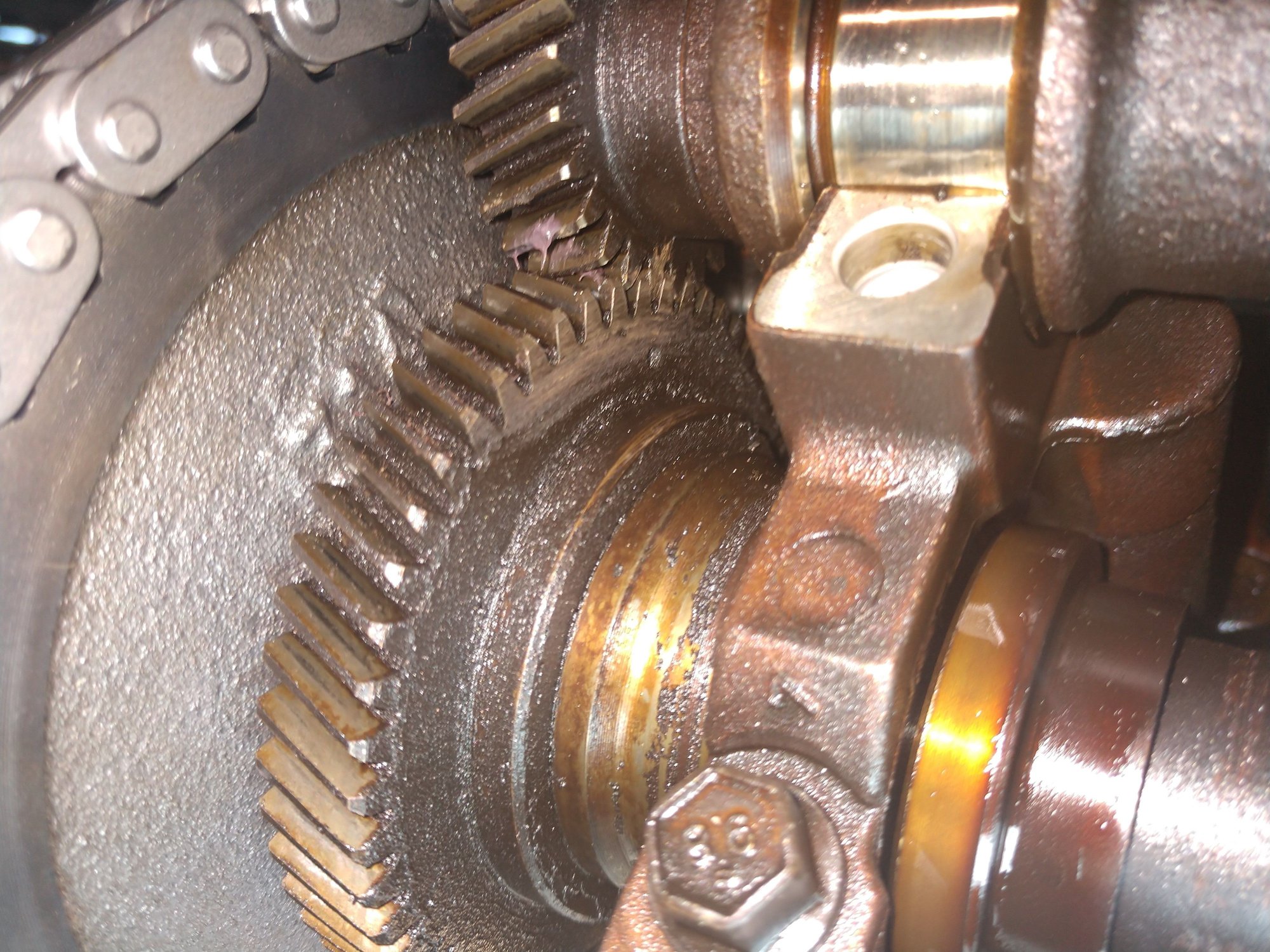

I struggled a bit aligning the balance shaft. I transferred the marks to the front of the gears so I could see them. It runs really smooth so I'm assuming I got it in the right spot.
My wife is actually a better mechanic than me.
