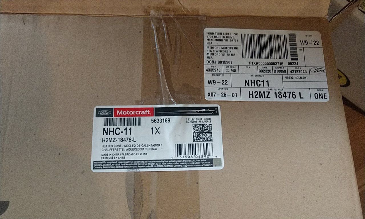

I fought the heater core and I won!
The actual changing of the heater core is easy, unplugging the quick connect fittings not so much. I cut the ends off and pulled them out where I could reach them. They come off really easy once you can grab them with both hands. You'll want new o-rings to put them back together.
The foam they send with the heater core is half as thick as what's on the original. I bought some at the hardware store. It fits nice and tight. I think air would blow around the core with the foam they sent.
Who is "they"?
Did you buy a Ford blue box heater core, a Motorcraft red box heater core, or an aftermarket heater core?
Any how about moving the photography back into the shop... I'm still lusting after that old lathe in the corner.

Originally Posted by Y2KW57
Who is "they"?
Bought it from the local Ford dealership. It was in a brown box. They would be Ford or Motorcraft. The picture was in the shop, just zoomed in. Yes, once I build or buy a shop, I'll be trying to acquire that lathe, an old drill press, and a hydraulic press from them. 😊 Wish me luck!

Not really that hard. I did a video about changing the heater cores. And as Y2K mentioned, get the OE heater core for anyone doing this.
https://youtu.be/JTftO4i_oTU
This is the heater core I used.
Changing the core was easy. Getting the quick connects off was the hard part. Until I cut the tubes off and pulled them into the engine compartment where I could reach them.@TooManyToys. I wish I had seen your video. The coat hanger may have worked. Mine is different than yours though, the tubes aren't as accessible. The one closer to the fender has a 90 deg bend in the quick connect fitting. On the bright side, that electric box wasn't in the way of the heater core cover.
