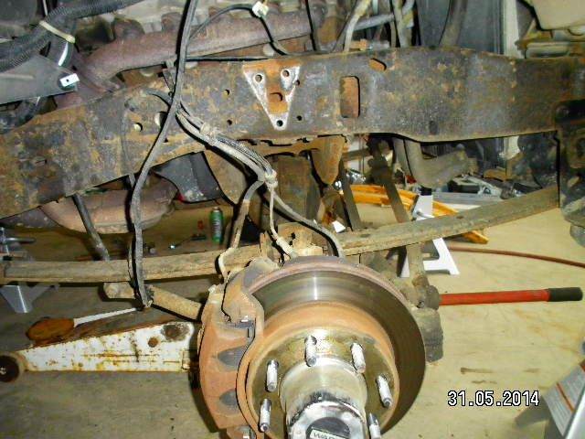

We started saturday night. Everything came apart easily. It sure is easier to get at with the inner fenders out. Sprayed all the studs with penetrating oil and quit for the night.
4 came out with the nut, 6 the nuts came off the stud, 4 were broken under the nut, and 6 were broken in the head. Welded nuts on the 10 sticking out of the head, 2 of them needed heat on the head to come out. The 6 broken in the heads we drilled with regular right hand bits till they screwed in a little ways,the cut the tapered part of a tap off, and used it to clean the threads in front of the stud. Then we used a left handed bit to back the stud out of the head. We had to go back and forth between left and right bits several times but 5 came out this way. The last one wouldn't budge, the bits were getting dull, and then the battery on the drill went dead. We were going to quit till morning and get new bits, but decided to try an easy-out.

That was Sunday and Monday. We also removed the rest of the exhaust system, and dragged it to my cousin's shop where we had a torch and welder. THANK YOU for all the helpful threads and pics, they are priceless. I should have listened to Christina I bought some cobalt and some titanium bits. I should have bought all cobalts
So today we're going to put in a block heater, new battery cables, and new power steering hoses. Then get started on putting the headers in. My tailpipe has the rear hanger on from the opposite side also, so we'll have to deal with that. I think it would rattle against the leaf spring the way it is. I look at that closer later.
