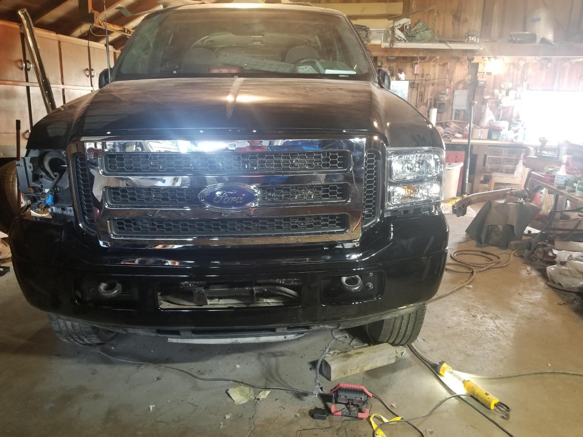

Is it possible to get the clips that mount the wiring harness to the driver's side inner fender?
So now we get to see the other side for a while 🤣😂.
So we actually took it for a little ride today. I haven't really adjusted anything yet. It rode nice and handled good, but I only went a couple miles. Feels like I need a new steering box.
