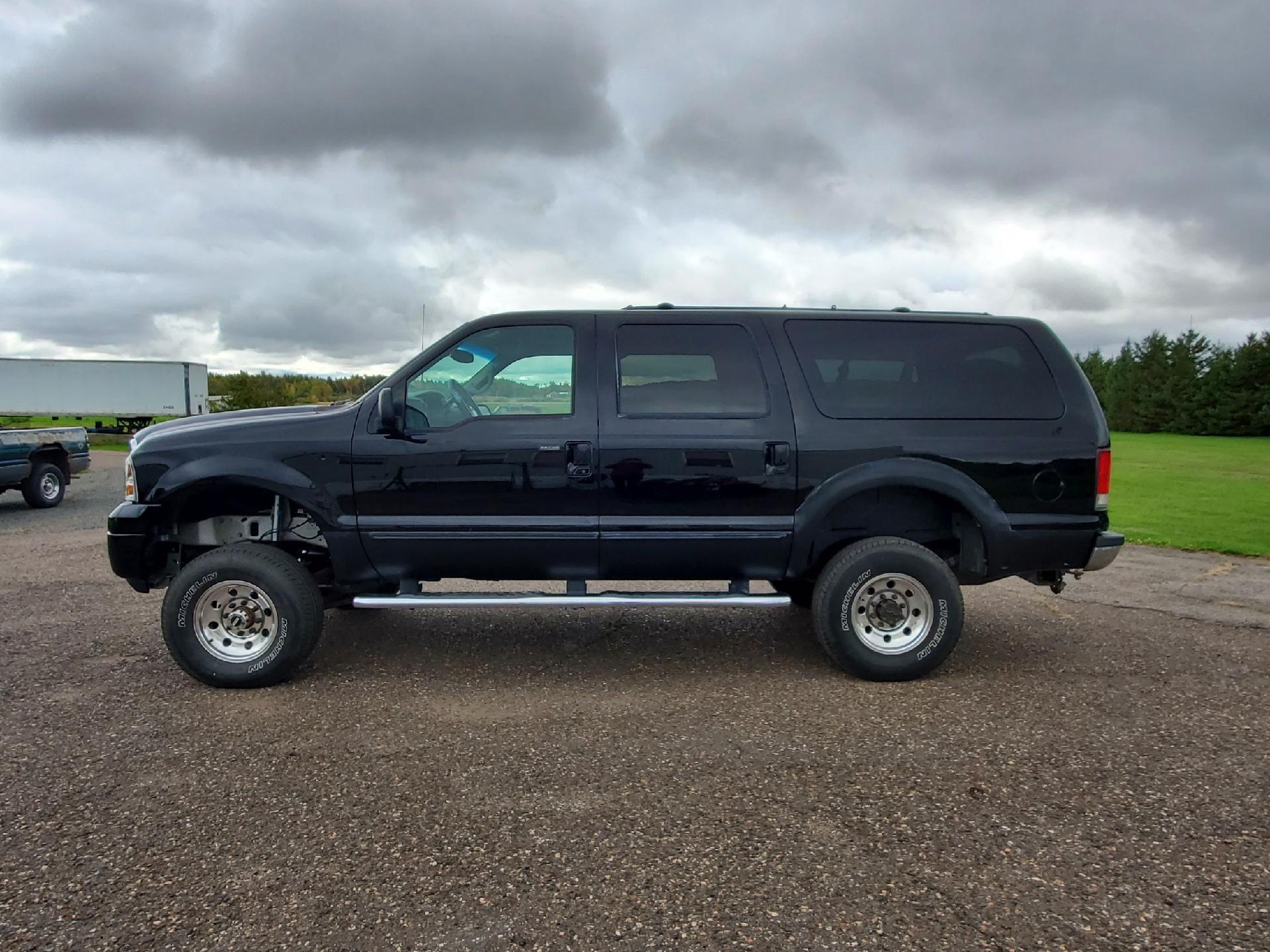

You can see the driver's side is taller. I'll try loosening the eye bolts before I get a replacement spring. Hopefully next weekend.
It's not finished, but it's really close! Tires Wednesday, tweek the tail pipe hopefully yet this week. I fixed the lights and cruise control. The door seals and hinges are installed. I can't get the washer pump to work. The relays click and the pump works, but power isn't getting from the relays to the pump.🤔Any thoughts on that? I have to sand and recoat 2 of the fender flares before installing them. I can't wait to see it with the bigger tires, 😎

Just a thought on the height difference and I don't know if it would even do this but did you replace the track bar also or is it the stock one? The other thought is that one of the springs was mislabeled. When ups delivered my springs from Amazon there was no manufacturer stickers or stamps left on my springs. They rubbed off in transport and I had to piece together what was left for front vs rear based parts of stickers that were left and visually matching up the springs that looked alike. Maybe the seller sent you the next taller spring?

They both are labeled 22210, but they shipped from 2 different locations. Maybe one has the wrong label? It has an adjustable track bar. I'll grab my phone and post pics of the alignment sheets. I have a question about the axle alignment anyway.

The leaf spring wasn't installed backwards was it?

I'm pretty sure they are in the same way, I'll check this weekend. I looked pretty closely when I put the axle shims on, but I've had brain farts before.....

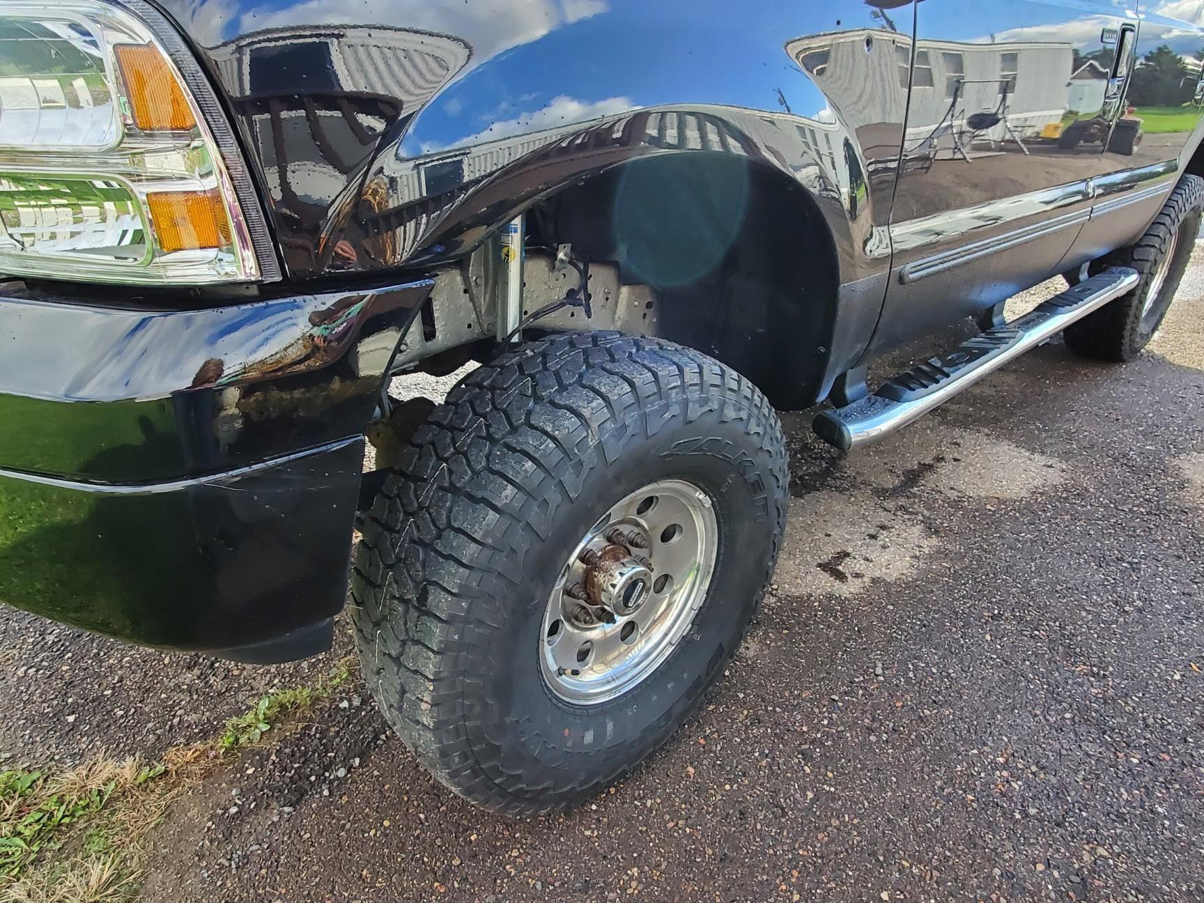

Falken Wild Peak A/T 315/75R16 AT3W
Needs the hub caps polished and put on.
Amazing how tires can change the look of a vehicle!
