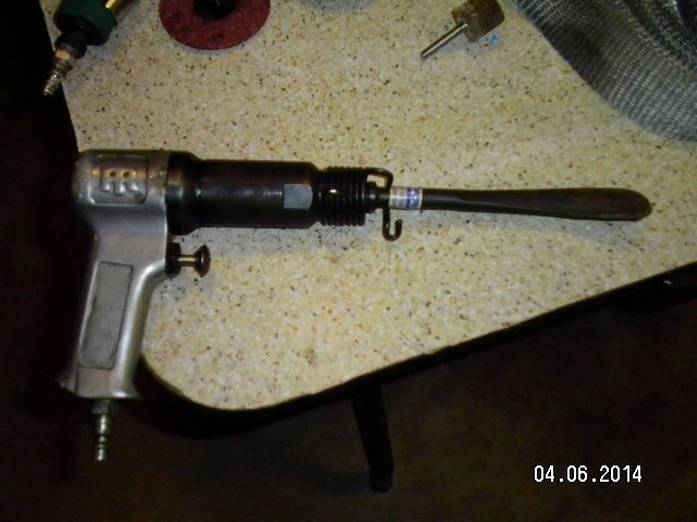

I put antiseize on the shaft as well as the threads.
Burnt with the torch while removing the studs.
Made the job a little easier.

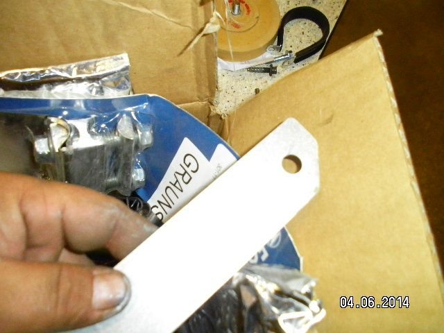

I think we'll have to use the hanger of the old pipe like Christina did.

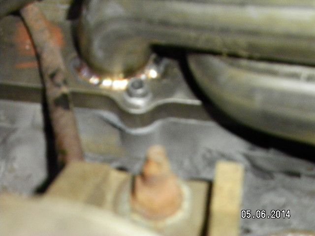

Had to grind flange on this bolt
I had two helpers, my wife and my cousin Gary(not pictured). We started Saturday and worked on it all week, finishing the next Sunday. I get to talking and some of the parts runs took longer than they should have. The kids had to get places and had some other things to do also.
The bolt in the picture we ground the flange down for clearance of the tube. We still ended up tapping it in with a hammer and punch because the head of the bolt hit the tube.
