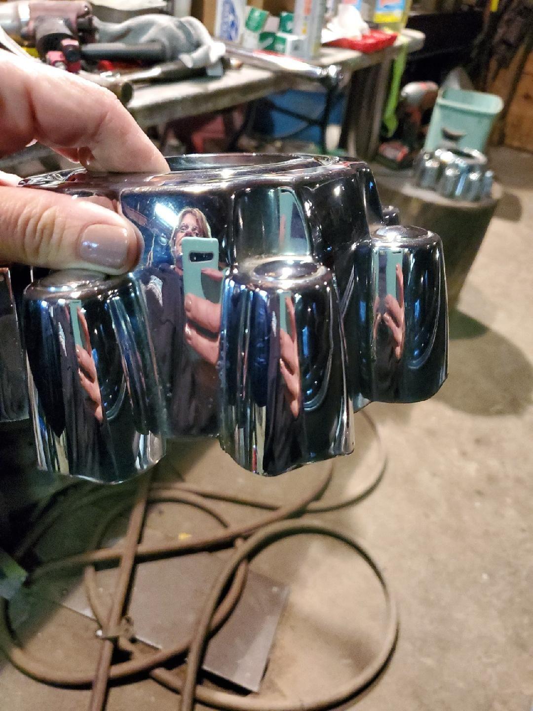

We're getting the little things done ☺️. We installed the rest of the interior trim, fixed a windshield washer leak, cleaned a bunch of ground wires, adjusted the bumper, and tried to get the EX to sit level. I loosened up the springs and took it for a ride. It's better, but the left side is still higher than the right. Anyhow, on to some pictures.....
My wife was kind enough to polish the hub caps 🙂
She did a great job and put some tire dressing on too😎

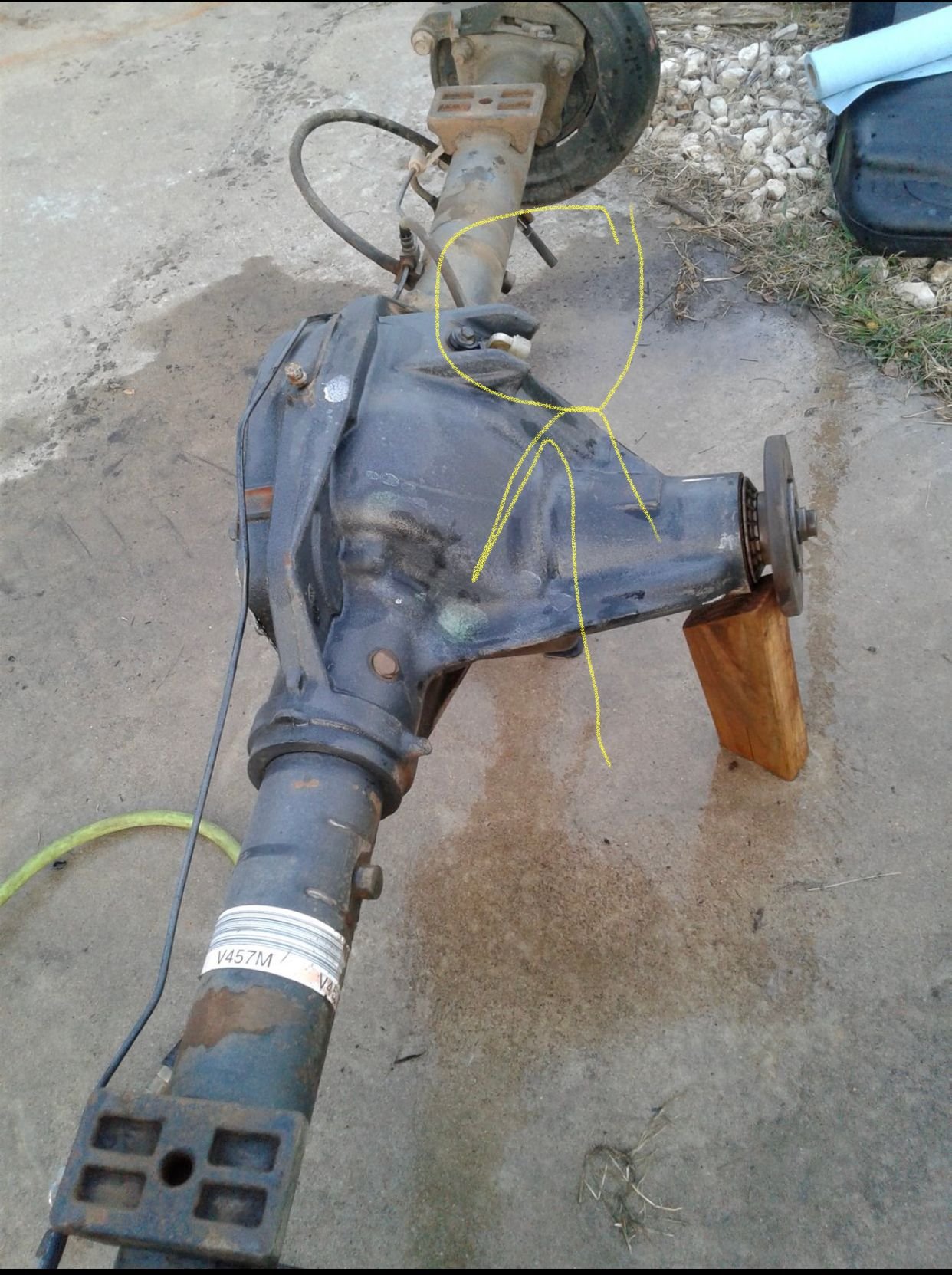

the tone ring was used up through 2008 axles I believe through 2010 axle had the tone ring.
here is a picture of an 07 axle with speed/abs sensor in place.
I stole that picture from this thread on here.
https://www.ford-trucks.com/forums/1...-thread-3.html
lots of great information on putting coil spring set up and rear axle swap.
