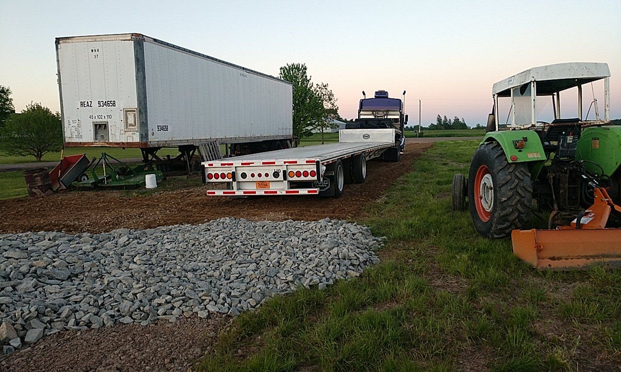

Freight rates still suck, so I've been driving this.
Widened the driveway and building a french drain so I don't need a culvert.
Work sucks, I'd rather finish the EX.
