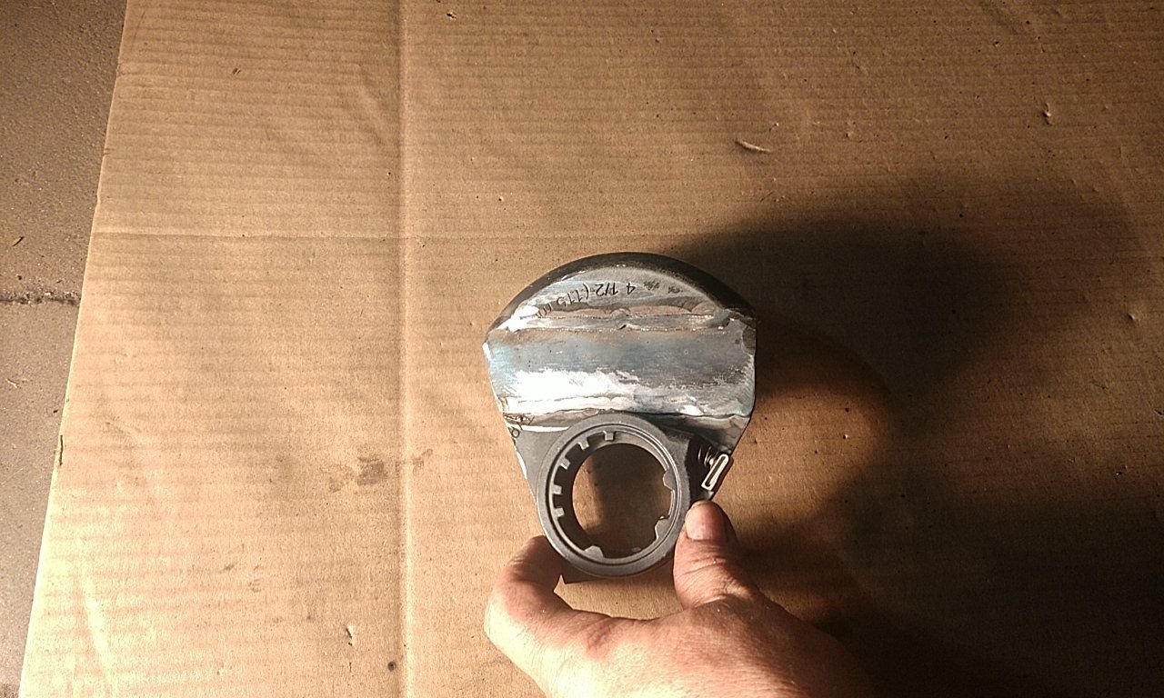

I've been using 6 inch cut off wheels on my 4 1/2" grinder. They work great but are really close to my fingers.
I made it narrower so I can get in places without the guard getting in the way.
Turned out pretty good 😊
