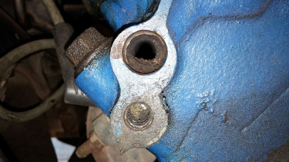

Today was equal parts frustration and satisfaction. I got the truck fired up and running and it sounds great. However I look underneath and see a steady drip drip of the green stuff. WTF??? Turns out I missed adding sealer to one bolt that threaded into the water jacket. Pulled the bolt and resealed so we'll see if that fixes it. Also when I started truck I hear a huge exhaust leak. WTF again. There wasn't a leak when I started tearing it down. I found this:
This plug decided to let go when I started the truck. Oh joy.

That plug, as you surely know, seals the front of the AIR passage that is drilled lengthwise through the head. I think the thread size on the outside of the plug is 5/8-11 and a short bolt will seal it. But, if you have an accessory that mounts there you have to have the plug.
Edit: I was thinking small-block. The BBF's air passages are bigger and I don't know the thread size.

I think that plug is .666 and available at NAPA.
There was a guy "Inside Man" who came on here a year back and did an emissions delete on a 460 before he sold it.
Somewhere in the last few pages of this thread.
https://www.ford-trucks.com/forums/1...s-removal.html

Got the plug from NAPA and sealed the hole. Modded the AIR pump bracket a bit too.
