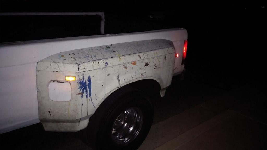

Picked up some clearance lights for the rear fenders and discovered I have no power to the harness. More investigating to follow.
Old Aug 24, 2014 | 07:06 AM
  #139
85lebaront2's Avatar
85lebaront2
Old School Hot Rodder
Joined: Feb 2006
Posts: 6,472
Likes: 11
From: Exmore, VA
The clearance lights on my 86 were originally fed from a relay mounted on the hood bracket out in the open just above the fuel pump relay. It is fed through a fusible link from the stud on the driver's side of the firewall. It is called the trailer tow relay. All duallys seem to have that setup, even now with the 1996 harnesses, mine still has a relay for those lights.

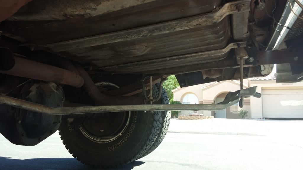

Bought and installed a spare tire carrier today. Gotta have the rear exhaust rerouted for it to work though.

From: Lake Elsinore
I could not find this relay on mine.

Ok, try this. AllData didn't have a picture of the 83 location, 86 should be the same or close.
File Type: pdf
Did you get that from LMC? Can't seem to find any spare tire carriers to fit trucks with a rear tank
Nope, my local pick a part off an '87 F250 extended cab.
Thanks for the info. I may have to do some rewiring.
The hold down won't work for dual wheels, you'll have to get the one for them probably from Ford.

Lights all working now. Had to tap into the rear taillights to get the clearance lights to work.
Why is that? Not deep enough? It looks pretty much identical to the one on your truck.

Bill's been on point with all his replys.
You need the big plastic cone to center the dually rim and you need to run a lighting relay or you will smoke the already feeble headlamp switch wiring.

I'm enjoying watching as well. Would another option be to install the headlight relay circuit, thereby taking that load off the headlight switch and allowing it to live with the clearance light load?
