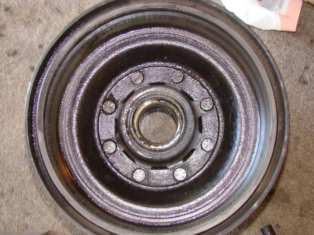

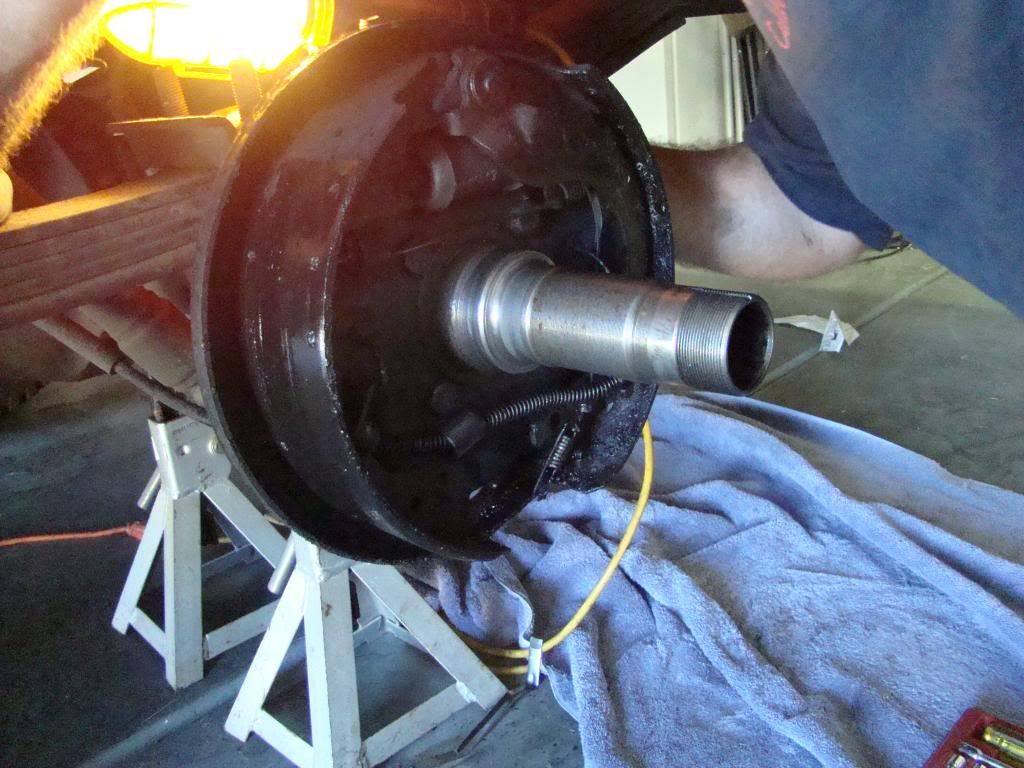

Started on the rear brakes today, what a freaking mess. I started with the left rear as I thought it was leaking brake fluid. Nope. Turned out the inner seal on the drum was shot and leaking axle oil all over everything. The drum was deeply grooved on one side (?). Took a bit of encouragement with some screwdrivers to get the drum off too as one of the long springs that hooks to both shoes had broken and was wedged in between the drum and shoes pretty good. But now I'm off to the parts store to get me some new shoes, hardware kits, seals, and cleaner. Ugh.

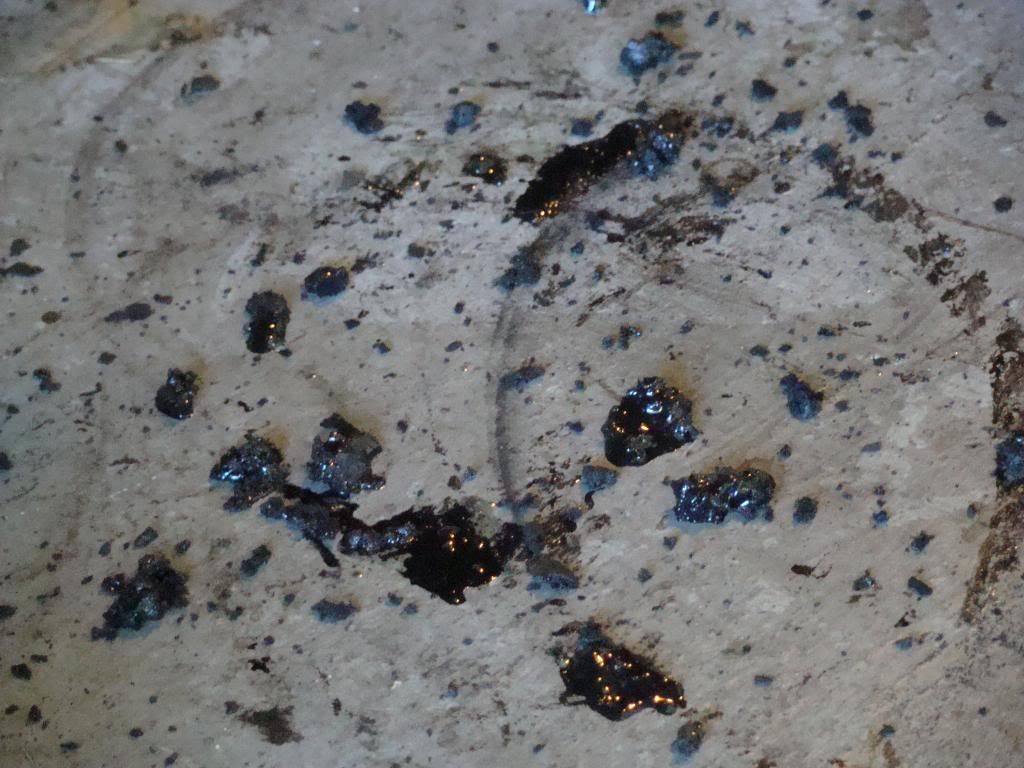

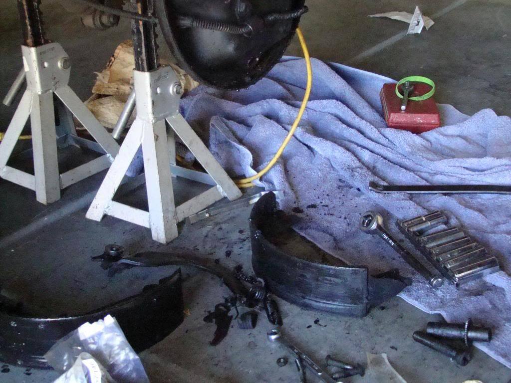

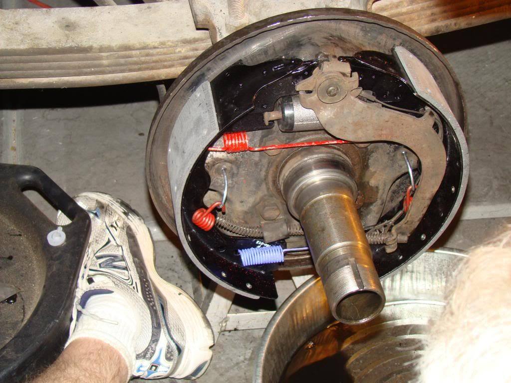

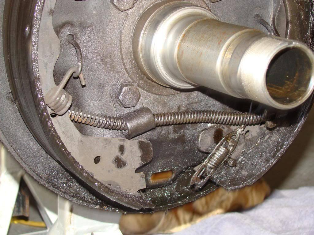

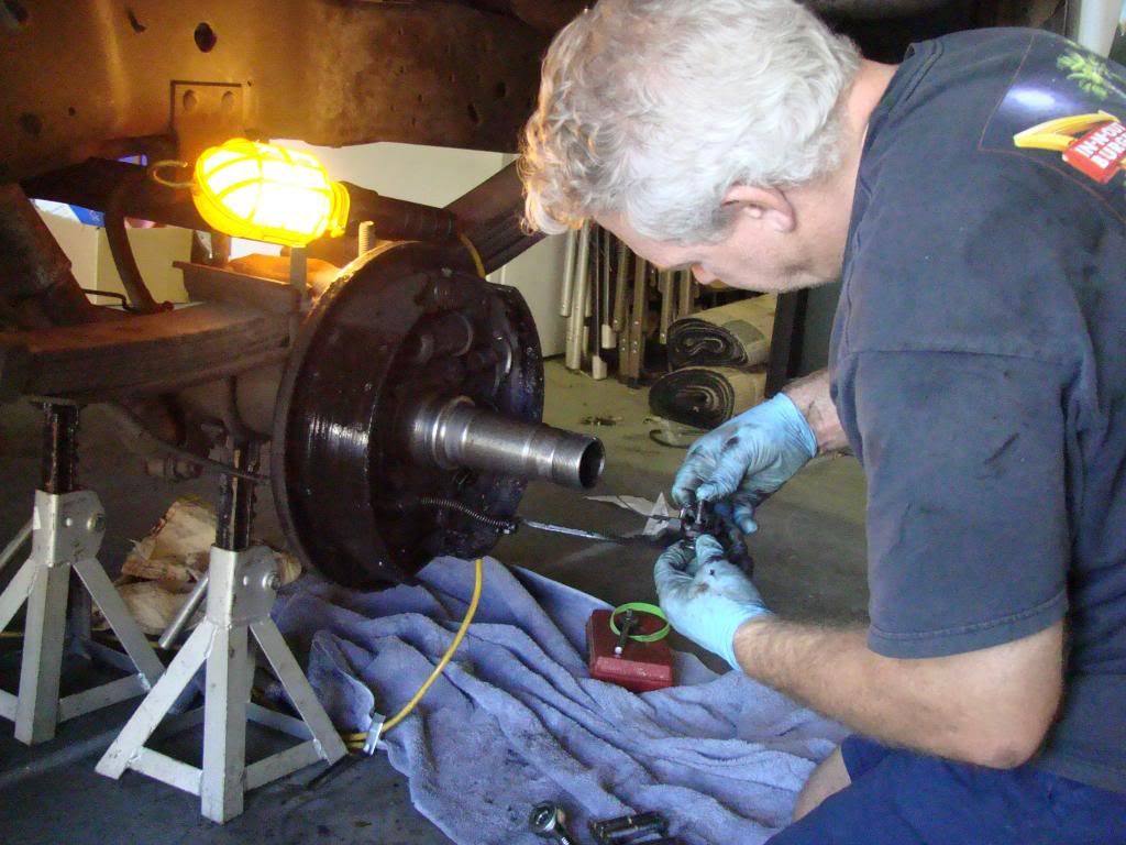

Jeebus H. Christmas, what a pain in the butt this job has been. Axle oil and brake dust makes the nastiest combo....
My youngest after she took a brush and some Dawn to the wheel...
This is what fell out of the drum and backing plate. My mother in law's gonna love her garage floor when she sees it...
And all cleaned up with the new stuff in, still lacking the adjuster at this point...
Finally about done with the left side. Gotta do the right now....

I didn't get any pics of the backing plate and shoes right after I pulled the drum off but the parking brake arm was completely FUBARed. It was jammed behind the trailing shoe and was pretty much useless. Now I know why the right rear tires were locking up, no braking action what so ever from the rear left side. I've bought other cars that were neglected, I just can't think of any that were this bad....

For those that are going to tackle this job, also check the small pin that comes installed on replacement brake shoes for the auto adjuster. Mine had new pins already pressed in, but they were just a hair bigger in diameter than the existing pin. The adjuster arm didn't fit over the new pin and I had to 'encourage' it onto the pin.

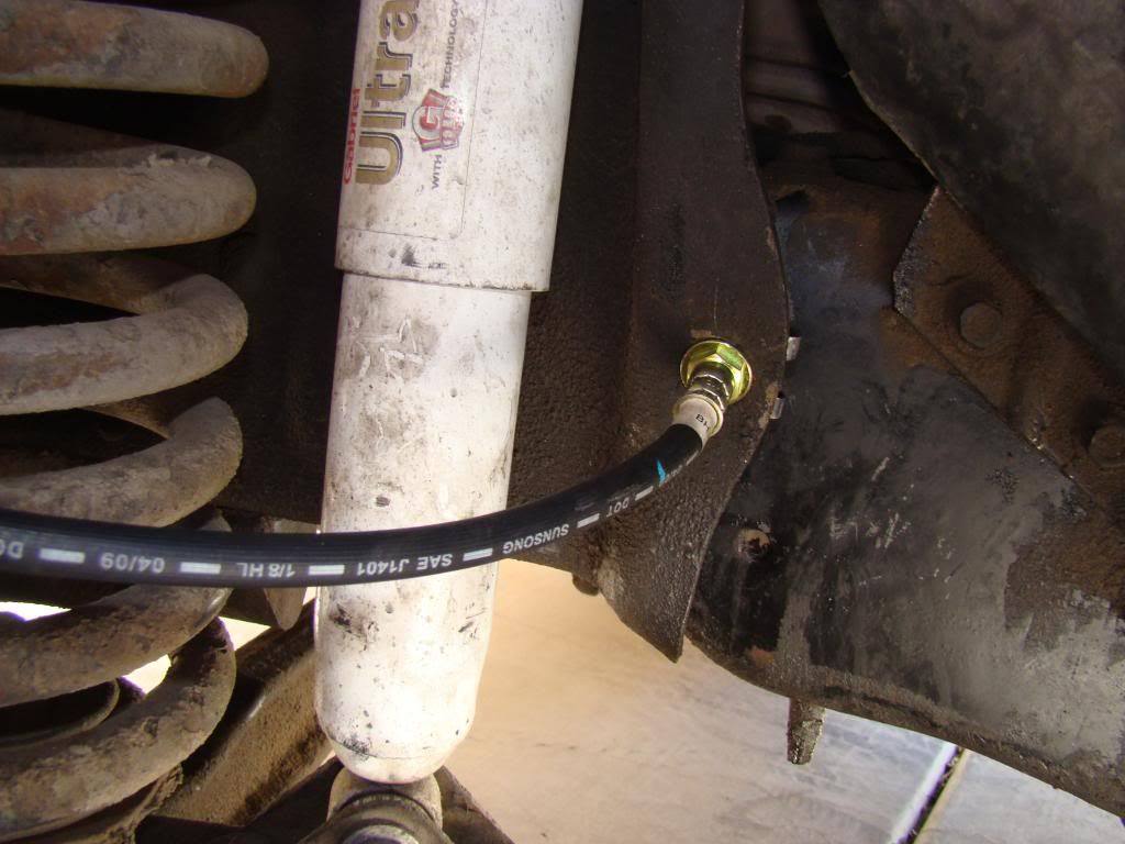

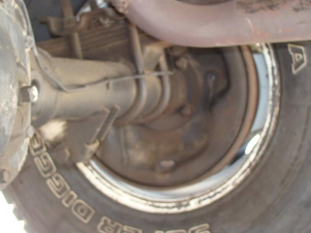

Did the right rear brake shoes today, was actually easy! No nasty axle oil to deal with but the wheel seal was just about gone so I caught this one in time. Changed the brake hose out too while I was under there. Now on to the fronts.

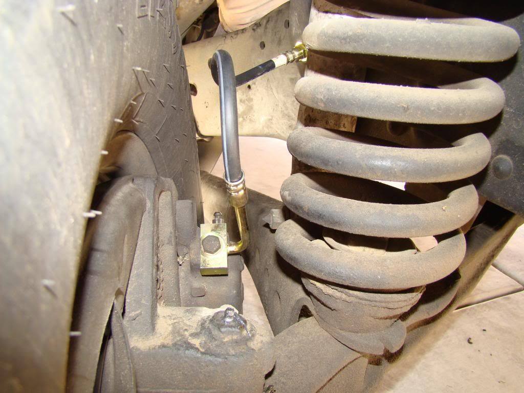

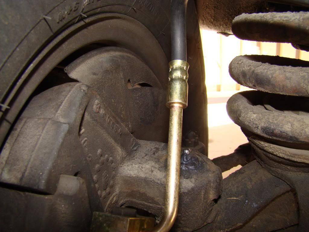

Other than having to use vice grips on the brake line fittings...

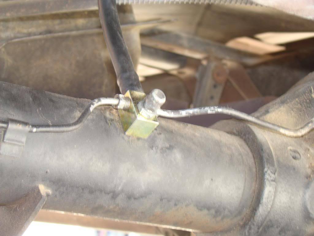

No more leaks:
