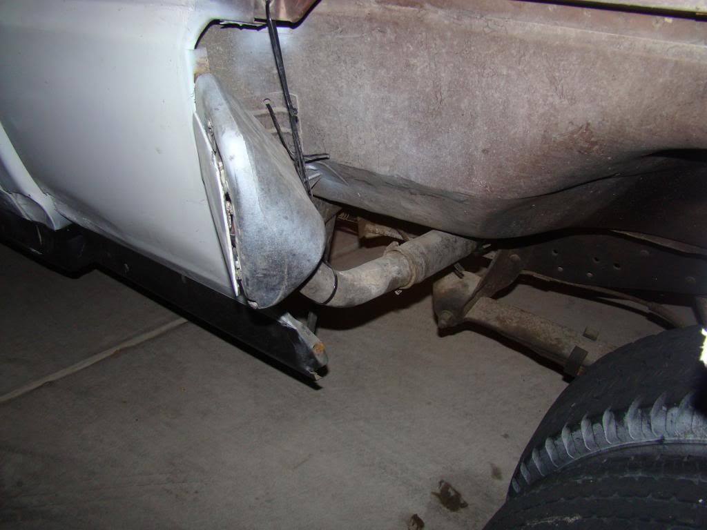

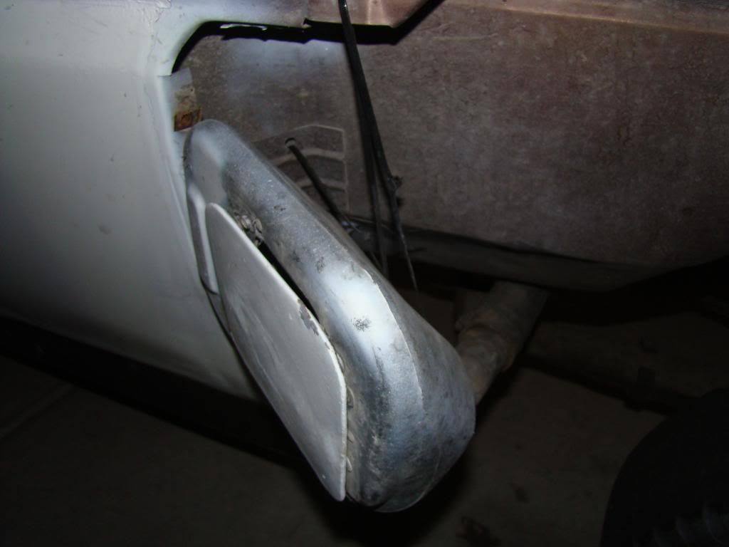

Took the sawzall to the left rear fender and cleaned it up a bit too. Lots of zip ties holding up the filler neck for now 'til I find a replacement fender.

Good progress, and as Jim says "Progress is good". But isn't it amazing what PO's do????
Amazing isn't quite the word I was thinking of....

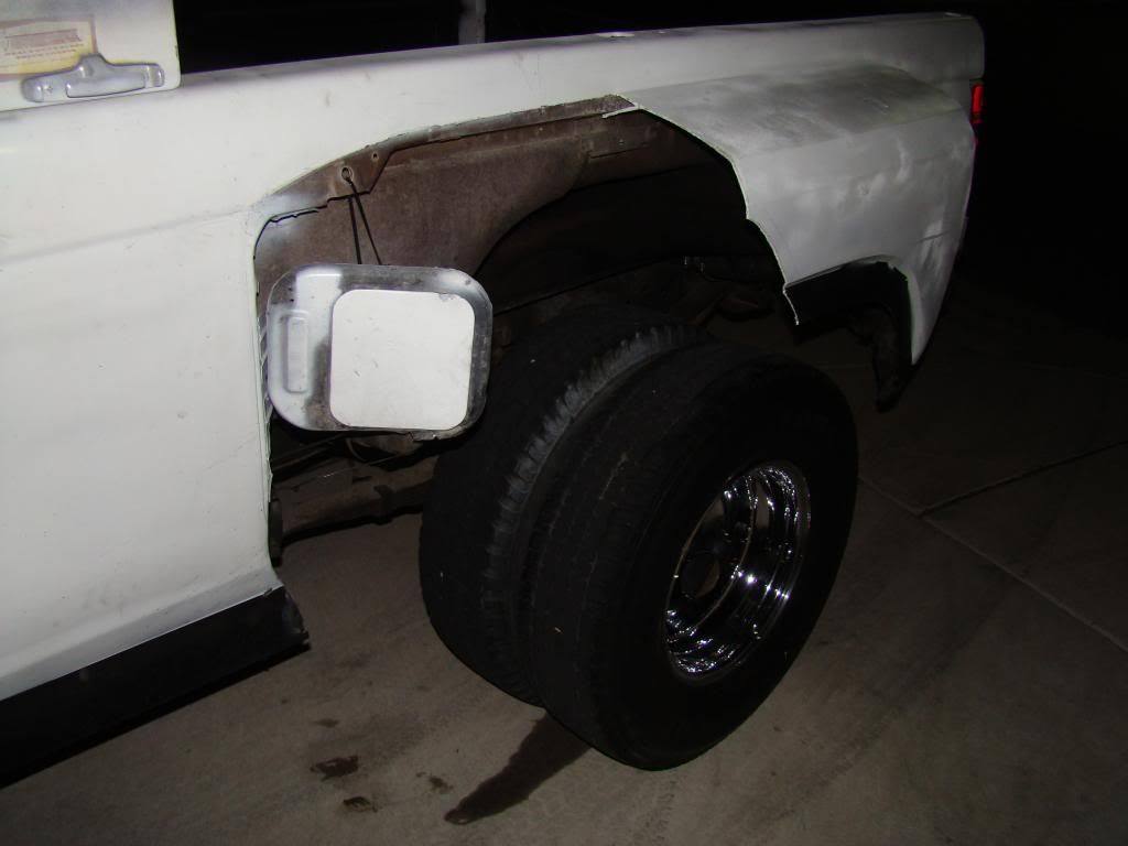

is that a big spacer on the end of the hub for the wheels to bolt to or is that stock?
It's for the dual wheels to bolt to. Single rear wheels don't have the spacer as far as I know.
Old Jun 24, 2014 | 08:38 PM
  #84
Russ85F150's Avatar
Russ85F150
Joined: May 2014
Posts: 52
They wont bolt on without it? Ive beenaaround alot of duallies from a 56 ford to 13 dodge and the only spacers ive seen were between wheels for big tires not to rub. Kinda wonder if its been converted to a dually or had the rearend swapped.
The studs are different sizes. Might be adapters but someone else more knowledgeable than me might know.
