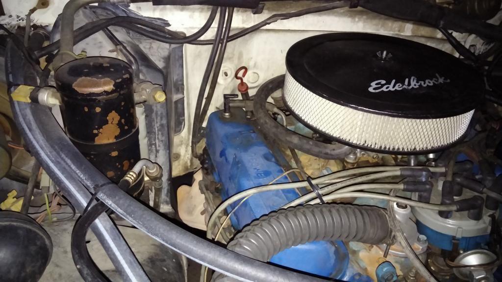

Got the PCV system fixed today along with pulling and chucking the kaput AIR pump. Installed overflow bottle for radiator and finished flushing the system. The fitting on the bottom of the air cleaner was quite a bit bigger in diameter than the fitting on the oil cap, so what to do? I took the rubber hose from the AIR pump and fit it to the air cleaner fitting (perfect fit). Then I used a bit of dish soap to slip the rubber hose from the oil cap into the bigger hose from the air cleaner. Redneck engineering at its finest.

From looking at the pictures, someone has definitely been "rigging" things. The original heater return went to a strange shaped pipe with a special O-ring sealed threaded piece into the water pump. This got it up over the air pump.
Looks good, you are getting there!

Took a short drive today to pick up my daughter from Grandma's hose and noticed coolant on the ground after I got home. All the weak spots in the cooling system decided to leak after the radiator was full and hot. Oh well, this is a good excuse to pull the radiator and support and steam clean the engine so I can fix it again.

And get/make a different mount for the alternator, thereby ditching the air pump bracket?
