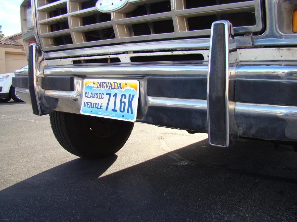

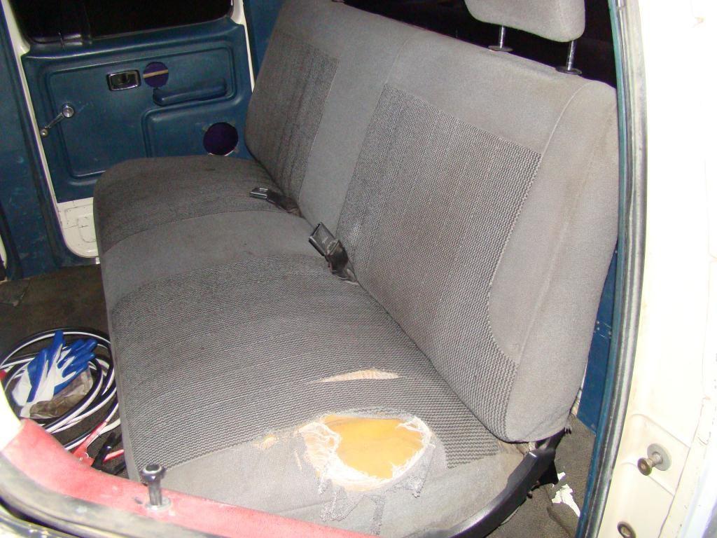

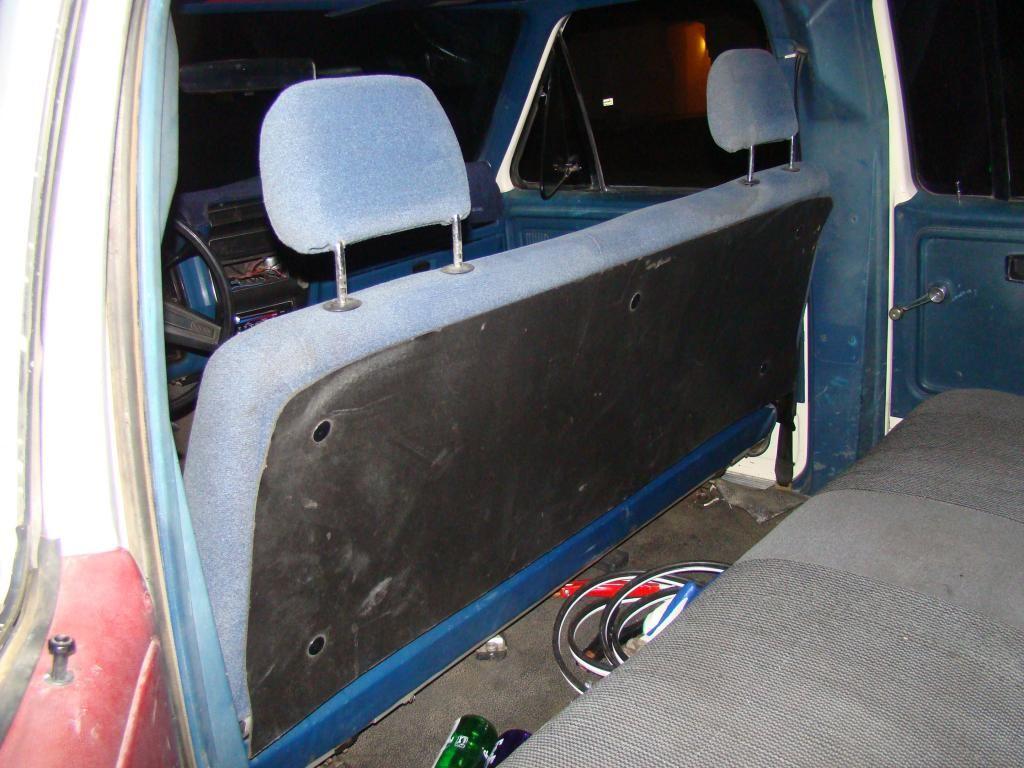

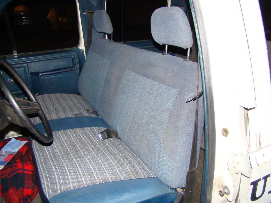

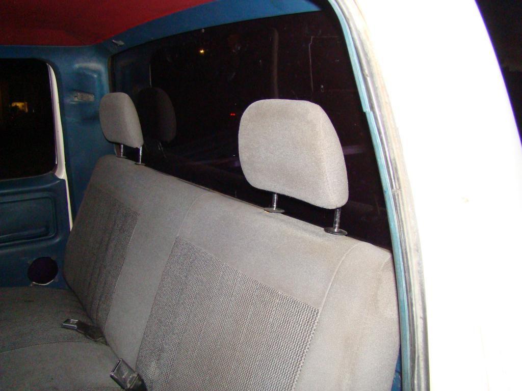

Went to the junkyard again today and scored me a 19T speedo gear, two bench seats with head rests, and a replacement bumper with the guards and rub strips. We did a bit of mix and match with seats but now me and the wife are feeling better that the kids' heads won't smash the rear window if we get rear ended. The rear seat bottom needs a cover but we'll handle that later. Kids don't care.

Coming along, Chris. Your truck is as much, or more, of a Frankentruck as Rusty.

Oh and I ain't done yet....

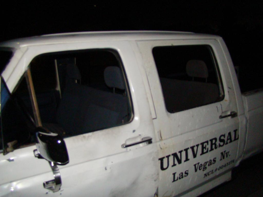

When I went to the junkyard today the security guy at the gate saw my truck and asked, "Did you buy that truck from us?". He recognized the left rear door off the '92 dually they had in the yard a few weeks ago and thought it was the same truck.

Chris, That happened to my dad in his old '75 Courier.He busted the back window right out of it with his head. Luckily it didn't do much of anything to him. Now if only my truck had head rests.
