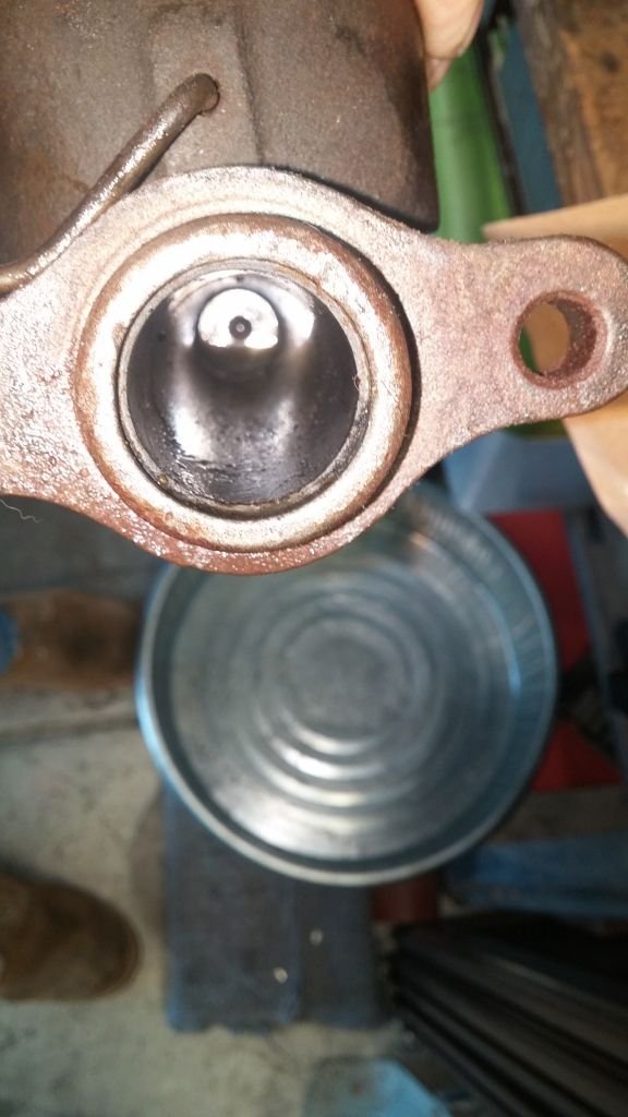

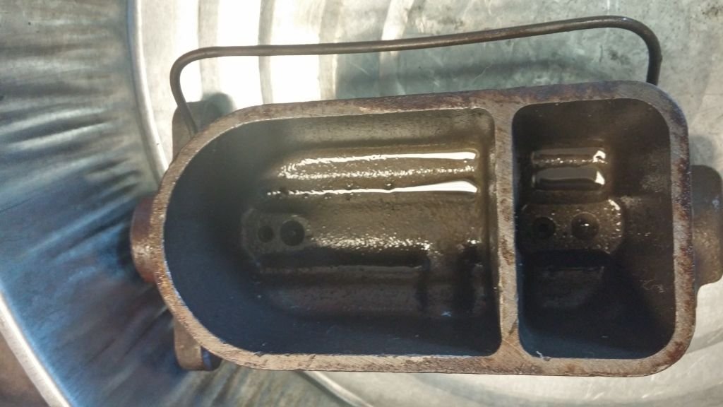

Pulled the master cylinder today as it was leaking out the back. Got a new one on order from O'Reilly Auto.
The reservoirs were pretty clean considering what I was about to find in the bore...

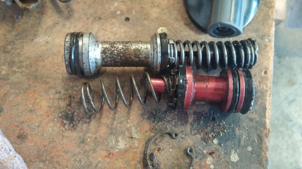

The bore had dirt almost halfway up the pistons. This is AFTER I wiped most of it off.
I knew I should have replaced the master when I did the rear brakes and all the hoses......

Live and learn. But, you are getting there. Keep on peeling the onion - and crying.

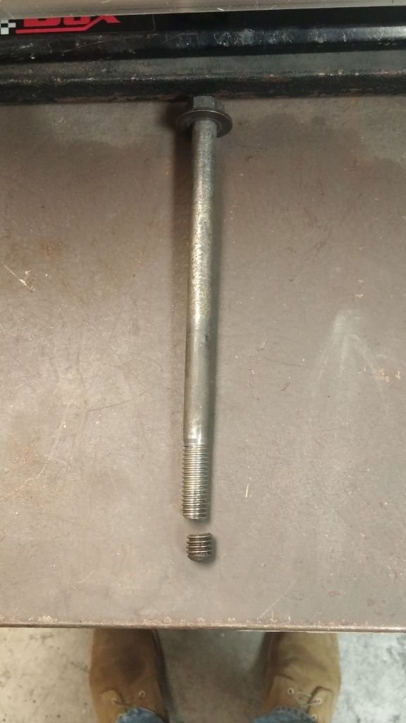

In a pinch you can use a Torx socket tapped into a drilled hole to remove a broken bolt piece...

All thread also works well if you break off a long bolt....like I did above.....
