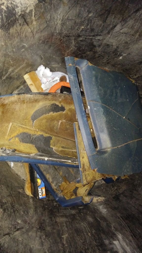

Swapped dash pads today, red for blue. The red one's got some cracks and the usual speaker grill issues but no where near as bad as the blue one. Replaced the broken A-pillar trim pieces with good ones.
Old dash pad in the trash:

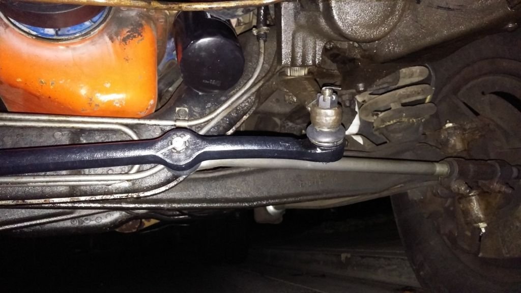

New inner tie rods.
Also scraped about 2 lbs worth of dried grease and dirt off the kingpins.

I don't know about the 83, but when I replaced mine they weren't cheap, especially the right inner. Be sure you grease the king pins regularly, mine are still the original ones. They take grease easier if you jack up the side you are greasing to remove the load on them.

I've greased them a few times since I got the truck. Last night I started pumping and kept going until all the brown nasty grease was out and the new stuff was coming out.

I replaced all inner and outer tie rods for under $40 from RockAuto. Probably won't last as long as original Motorcraft though.

I need to do the inner tie rod's this year. They're still good, but have a very minimal amount of play in them. For $20 a piece and I get to eliminate a tiny bit of play... My truck also has the original king pins. I can tell you that by the 3" of dirt/ dried grease all over the whole assembly.
