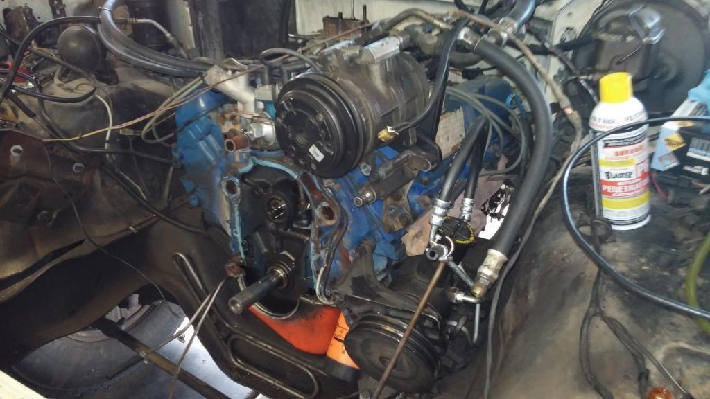

Originally Posted by Gary Lewis
And get/make a different mount for the alternator, thereby ditching the air pump bracket?
I've been looking at the high and low mount aftermarket brackets. Are there stock brackets off a car that will work to raise it up? I can hit the junkyard pretty much every day.
Old Sep 7, 2014 | 08:45 PM
  #183
Gary Lewis's Avatar
Gary Lewis
Joined: Jul 2010
Posts: 32,875
Likes: 48
From: Northeast, OK
Yes, there are brackets from cars that will work. Or, you can get one from a different engine, like the M, that has the arms for the air pump as separate pieces so they are easy to hacksaw off. This link shows what I did for Dad's truck.

L&L, JBJ and others offer high mount 460 brackets.
You see many more of them if you look in the '70's truck forum, below this one.

Or you could go full custom like I did for an alternator bracket.
That's from MM&M customs.

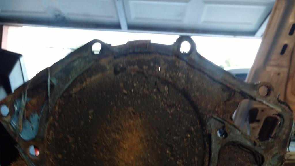

Pulled the front apart today to fix the leaky timing cover. Found a hole in the water pump plate. The timing chain's stretched so it'll be changed out too.

That's nothing out of the ordinary given the brown sludge that was in there.
You're making great progress with the truck!
Check the little scrolls in the back side of the timing case around the water passages are not filled up.
This is your last defense against water pouring into the oil if you have a leak there.
At least it pisses to the outside where you can see it,
