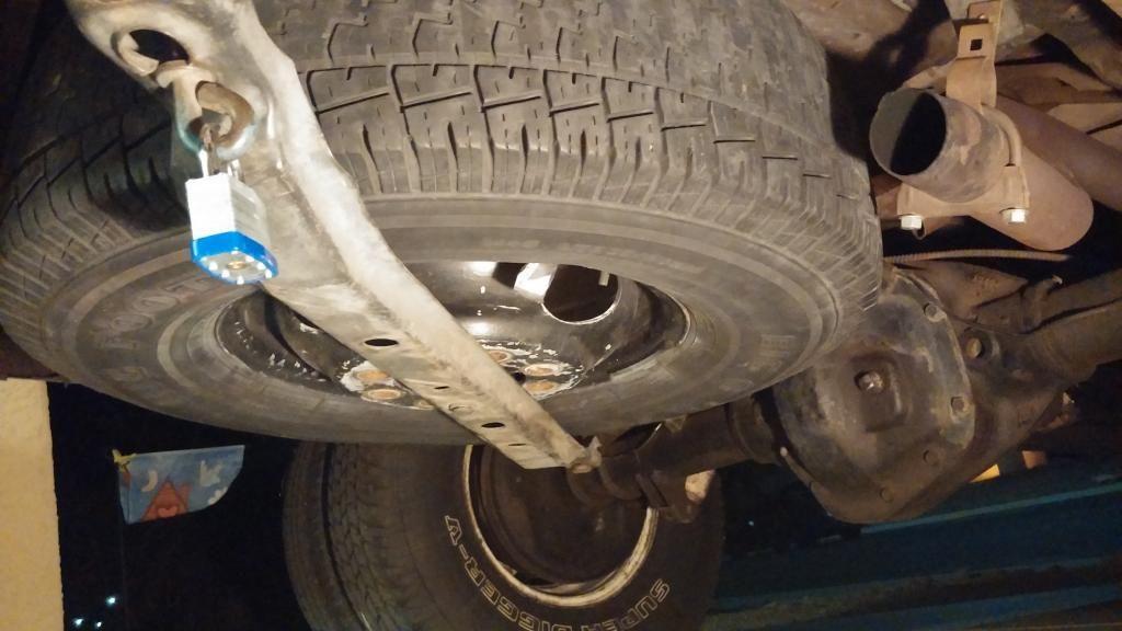

Got the spare mounted tonight along with some custom exhaust work with a reciprocating saw.
Gonna cut off both pipes right behind the mufflers tomorrow and reroute them to the side.

Good idea with the padlock.
