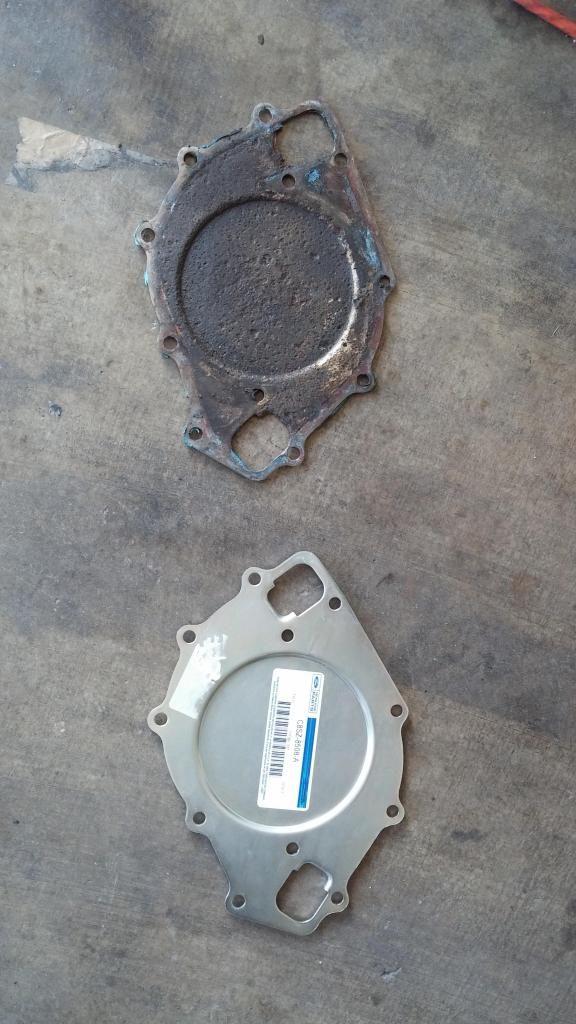

Got the timing cover back on and picked up a new water pump plate today too. Should have this all buttoned up Wednesday.

Good move getting the new plate, Chris.
You can't see it here but the old plate has several pinholes in it.
And that there is a prime example of why it's so important to change the coolant regularly.
Old Sep 17, 2014 | 02:39 PM
  #202
ArdWrknTrk's Avatar
ArdWrknTrk
pedant
Joined: Jan 2008
Posts: 23,576
Likes: 39
From: EXTREME southwest CT
But you can see where it got into the pockets of the timing cover...
I'm pretty good about changing my coolant and my backing plate is still all pitted.
There's a lot of cavitation and scouring going on in there.
I don't think it can be helped.
Nice to see you're doing it right, so you don't have to deal with it again.

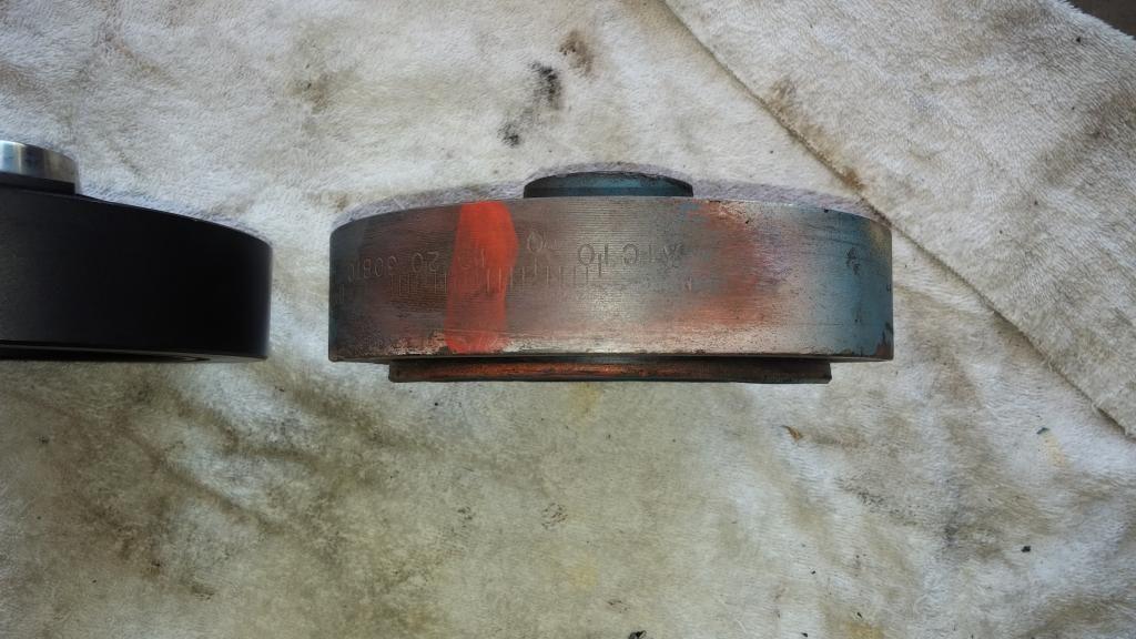

The old damper had a bit of a problem.

What's up with the orange oil pan and orange 1" wide timing marking?
PO probably. The engine's been replaced sometime in the past. The rocker cover decal says 1977 model year. The engine's also been repainted before so it may have been apart for rebuild or ring job, no way to know right now.
when the rubber gives up like that it can be hard to find the marks.
Imagine there's a pretty good groove worn in it too.

Jim, are you forgetting that the 385 engines like the FE and MEL have a sleeve or counter weight behind the balancer where the seal rides? Trackerrrr, if it is indeed a 1977 then it shouldn't have the "hatchet" counter weight behind the balancer, which doesn't look quite as bad as mine did.
