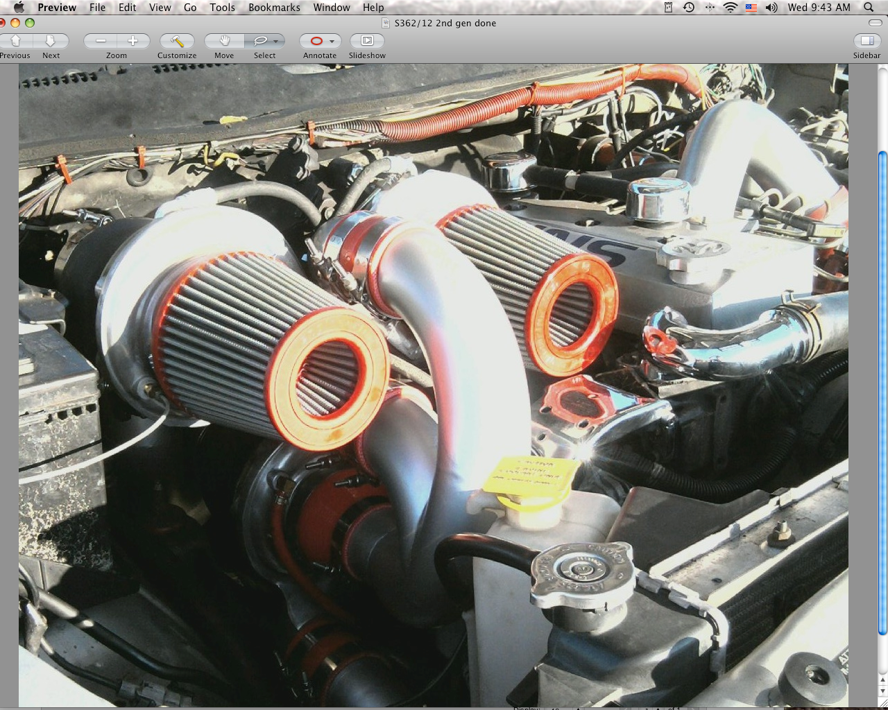

I am assuming you are going to straight to a triple turbo set up then.....

Awe hells yeah! Lol still definitely doing twins but I may just leave the motor alone and freshen it up like I've been saying going on what the cummins guys have been saying.
