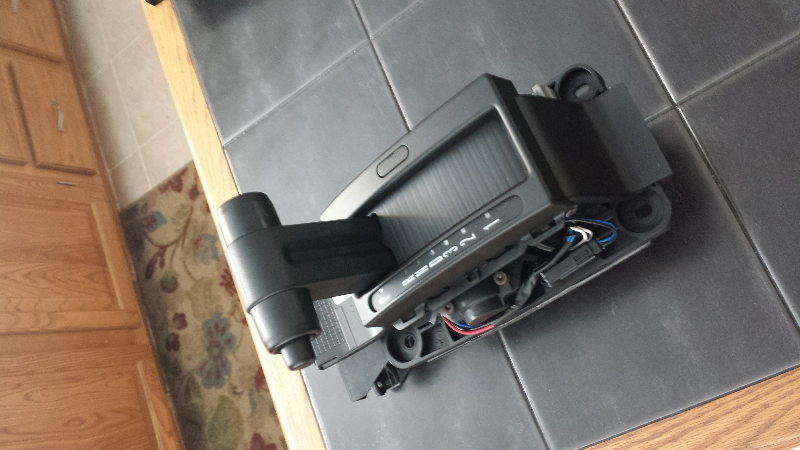

I got an 06 mustang shifter assembly, did i post a pic of it? I can in a few lol.

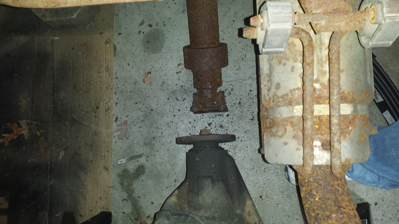

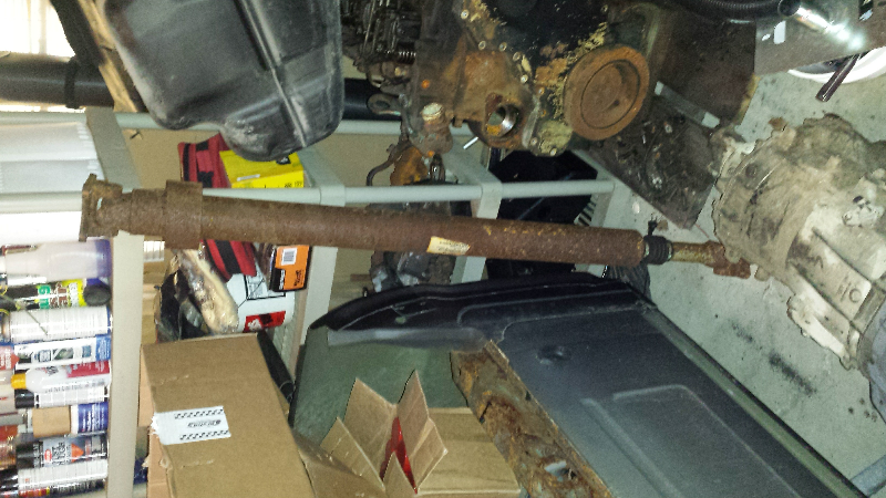

Well i got the driveshaft out, does anyone know how to remove the front shaft? The bolts looks really small IMO if i saw the right ones.
Here are a few pics

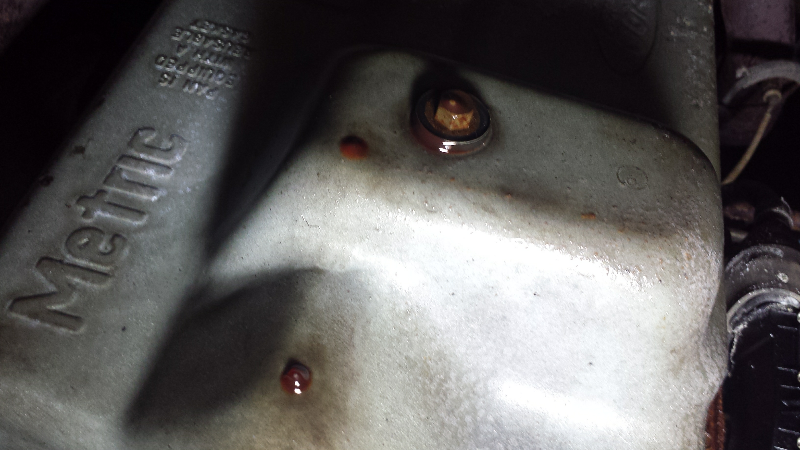

Also i found that my transmission and oil pans have gasket leaks there are drips on the ground and the transmission had fluid all over the pan

Here is a pic of the shifter i am going to use, its nice because now with the allison i can use the 321 section

For the drive shaft it should be a 12 point socket and you should be able to just pull it out. The shifter looks perfect like it is already a Super Duty shifter.

Yeah i think it will fit well in well, is that for the front drive shafy as well? I know the rear is 12mm but the front seemed smaller when i glanced at it i will look again lol.

I believe it is a 8mm for the front shafts u joint straps. Pretty sure that's what it was or 7mm

And it should be the same as the rear for transfer case side.

Awesome thanks! I will be heading out to the truck again in a few to possibly remove the front shafy while i am at it.

I am charging the battery currently so i can engage the case even though i can lock the hubs to keep the shaft from spinning i would like to make sure it works properly still.
BigBee did you remove the tcase before pulling the motor and tranny?
Also what is everyones inlut one an aluminum drive shaft? I will potentially need to get my current one shortened with the allison and cummins mounted.

I left it connected because I did not drain anything. And I knew it was going to sit for a while.
I just had mine retubbed and balanced. Front and rear.
Sent from my SM-G900V using IB AutoGroup

how much did that run you? i am currently looking for a driveline shop near by to have them redone if needed. also to measure the difference all that is needed is the center of the axle mount to the center of the tcase mount correct?

It was 250 to have a new front retubbed to lengthen and the rear shortened all you need is flange to flange measurements as the driveline shop will take into account the slip joints.

Cool! Should be easy once i find a place near here. I've read that larger aluminum shafts (5") are stronger and lighter than a 4" steel one, are there any thoughts on that?
