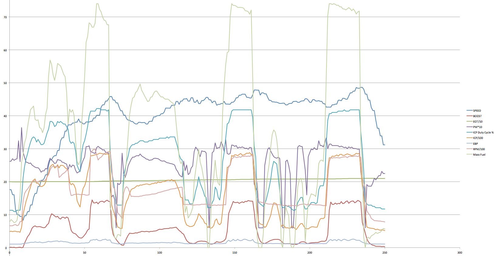

Here's a graph from a 2000 Excursion towing an 8,000 lb trailer up a small incline and flooring it when I could.
I'd like to know if I'm logging the most useful info and if the chart below is showing that anything needs attention.

Can you attach the data file? The PID 3D team has a special software that makes graphs easier to sort through and it automatically analyzes some of the data.
I can try, I tried to rename it from .csv to .jpg and upload, but it didn't like that - bad file format.
[edit] I see a reference to changing to .doc and using the paper clip, but I don't seem to have a paper clip as part of the editor. [/edit]
Also, is there a naming convention for the headers - to make your life easier?
Here are my headers:
GPS Time, Device Time,GPS Speed (Meters/second), Horizontal Dilution of Precision, Altitude, Bearing, G(x), G(y), G(z), G(calibrated),#FTE_Engine Oil Temperature(°F),#FTE_Fuel Injector Pulse Width(ms),#FTE_Injector Pressure Regulator (Injector Control Pressure Duty Cycle)(%),#FTE_Transmission Fluid Temperature(°F),#FTE_Injector Control Pressure(psi),#FTE_Exhaust Back Pressure (Absolute)(psi),Battery Voltage(V),#FTE_Manifold Absolute Pressure(psi),#FTE_Manifold Air Temperature(°F),Engine RPM(rpm),Voltage (OBD Adapter)(V),Mass Fuel Desired(mg/stroke),#FTE_Barometer(psi)

I see you are using Torque Pro. Naming convention? I use the acronyms, not the names.

Does you software assume particular headers, units, case sensitive?
I can massage my CSV file into something that makes it easy for you to import if you tell me what you want to see.
I'm still not sure how to get it to you though. I can email an attachment?

TorquePro headings
If you use the standard Torque Pro names, it will be easier. The software automatically finds and uses the columns then.
Here's a list. Ignore the asterisks

PID 3D update
Tugly and crew,
If my daughter isn't sparring tonight at class, I'll start the beta test release packaging on the software, after updating the graph color and layout schemes.
That means you will have it for review tonight or tomorrow night at the latest.
