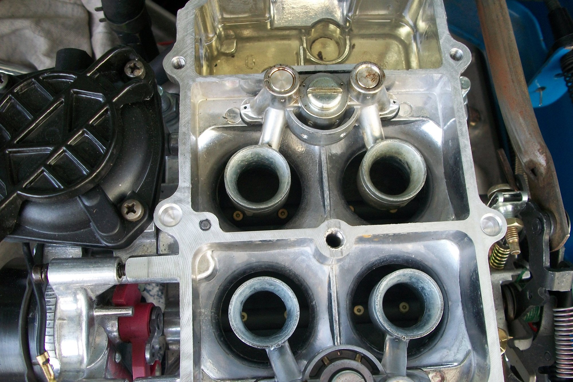

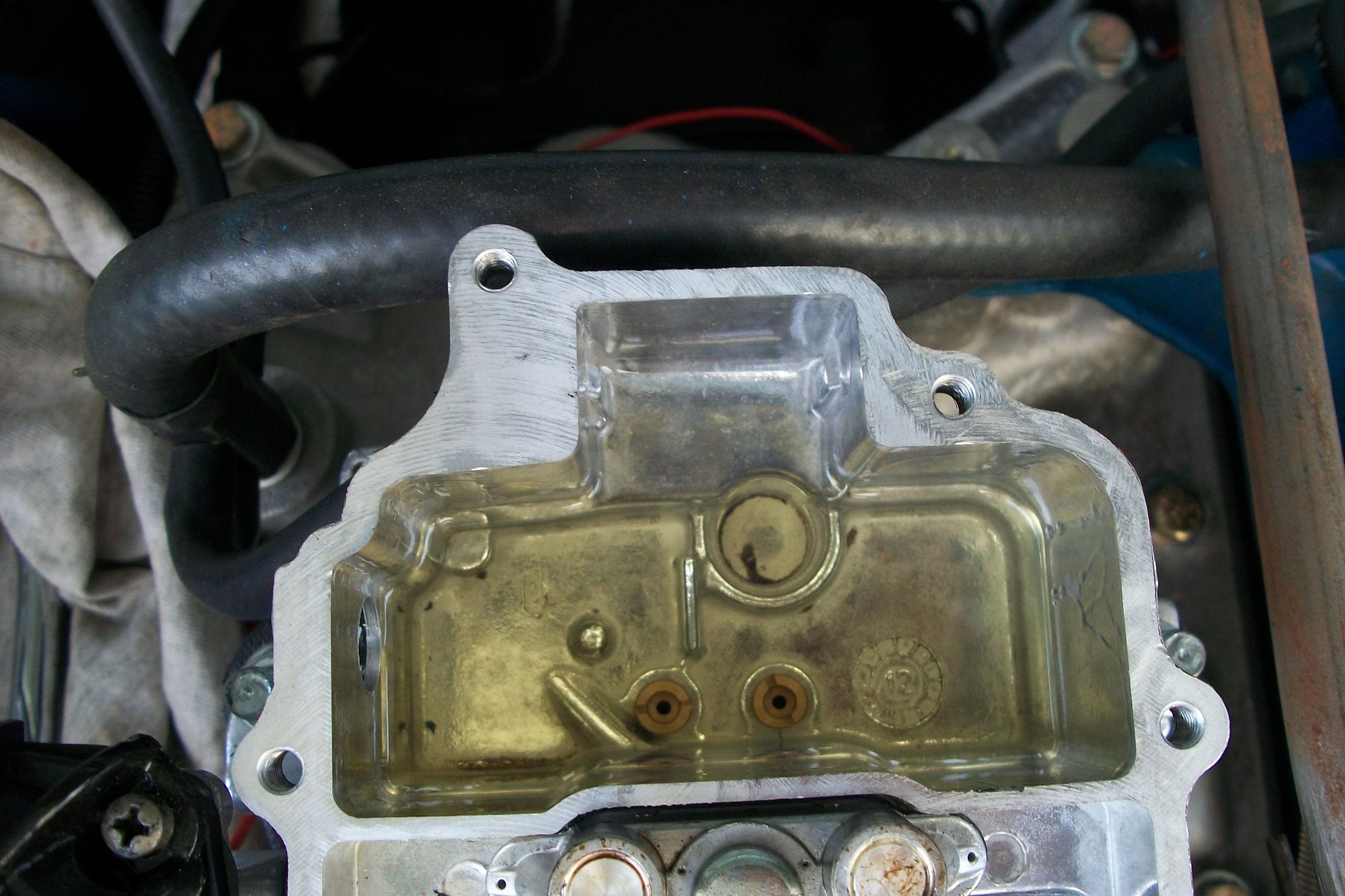

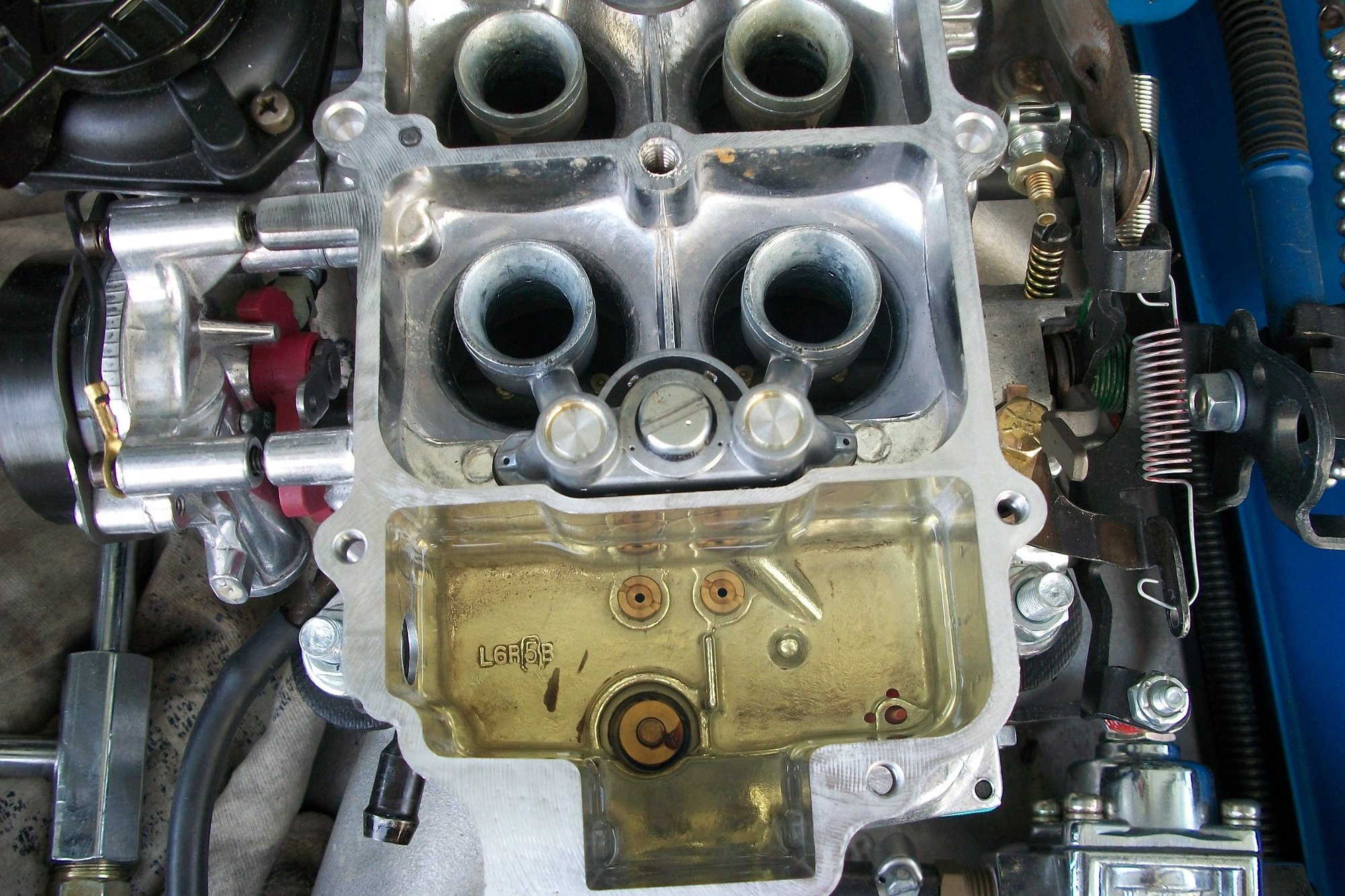

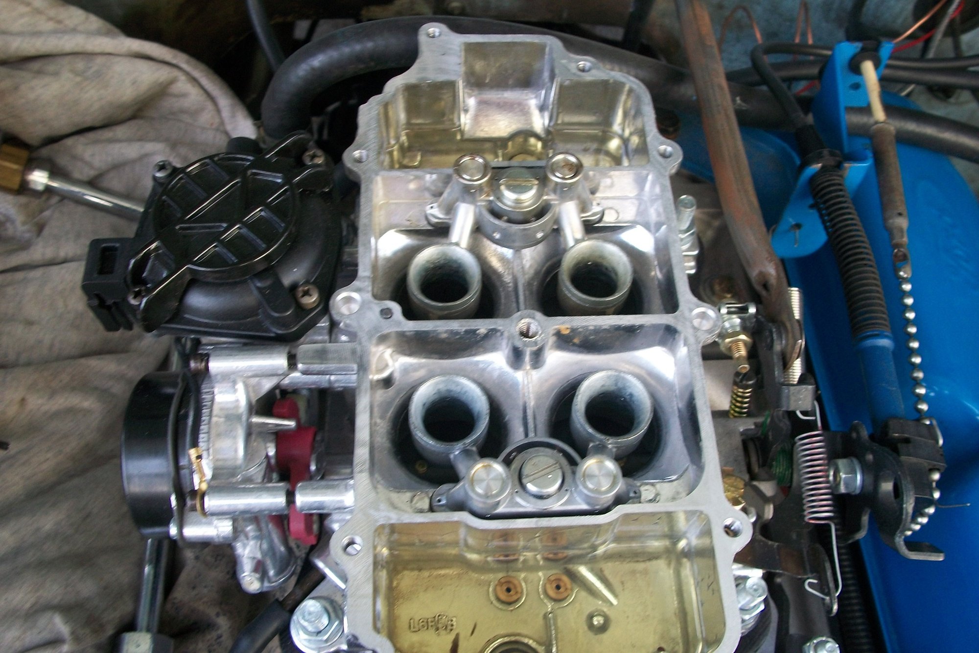

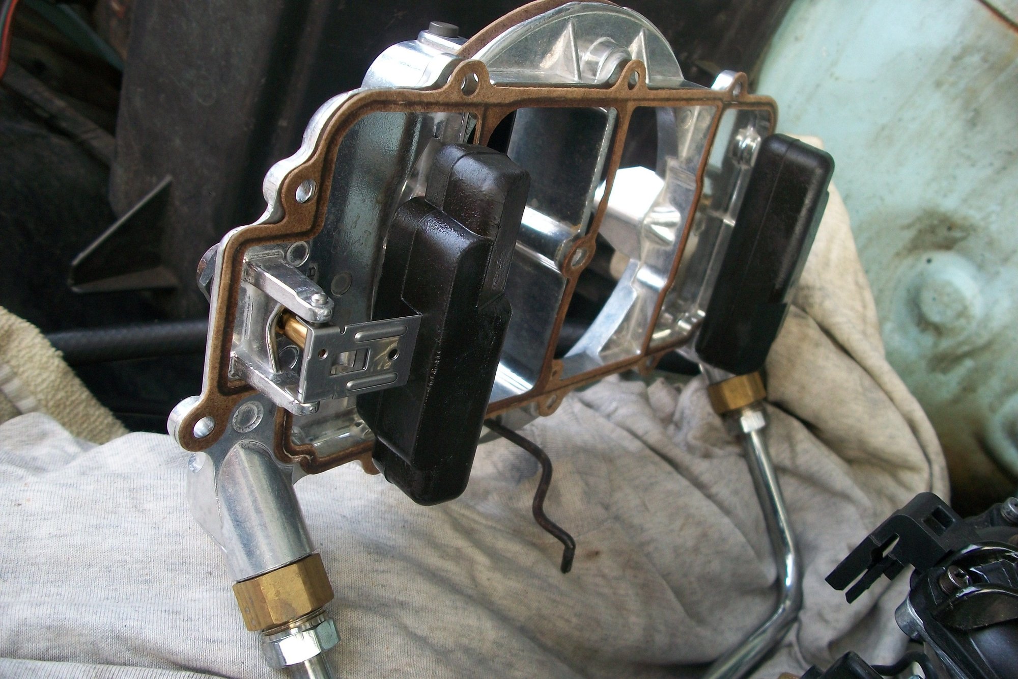

Wow, it's been a while since I've updated this. Since I've updated this last. I've taken the interior out, prepped the living daylights out of the floor and back wall and sprayed it with herculiner and put the interior back in. The passengers side floor board had a few small rust holes from water soaked insulation, the metal was strong between the rust holes so I addressed it and filled them all with fiberglass body filler. I've installed new wheel cylinders and rebuilt my calipers (brakes work awesome and don't stick now) I also put a NEW master cylinder on the truck. I have put new wire harness connectors on the alternator, installed a 192* Motorcraft RT1139 thermostat (thing works WAY better than the 180* Motorad piece) I flat sanded my thermostat housing completely flat and used loctite 515 gasket eliminator and it hasn't leaked since. I doubt it ever will, either. Today I changed my primary carb jets. Went down 1 size. I also installed a new rear fuel tank sending unit. Also a month back I fabricated myself a top alternator bracket. Here's some pictures, none are in order but here they are.
