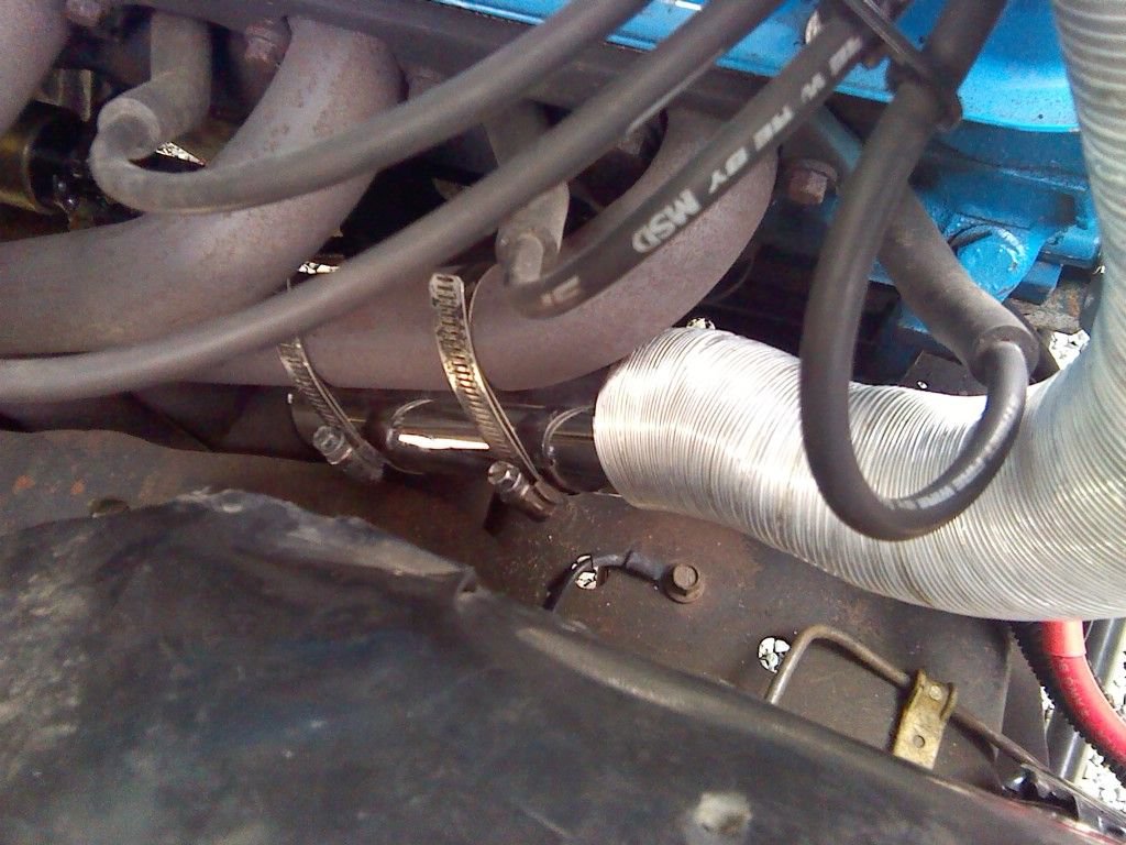

Got the cold weather hot air setup hooked up today. Seems to work. After running it for a couple minutes if I lift the lid up real fast and stick my fingers in there I can feel warmer air than outside and it idled better with no choke when it's cold than usual too. We'll see how it works in the cold weather.

I relocated the exhaust tip last night so it's touching two header tubes now.
