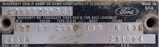

Can you help with this one??

C70 = C700 Tilt Cab (gas).
X = 391 4V FT V8 engine with low propane gas option. Or: 534 4V Super Duty V8 with low propane gas option. Both were Domestic Special Orders.
V = Kentucky Truck Assembly Plant.
Z08721 = 1977.
135" Wheelbase.
CT: C = Pure White / T = Candyapple Red.
C700 Tilt Cab (gas), 24000 lbs. GVWR
118: 11 = Light Gray Vinyl - Full Width Seat // 8 = 91A Standard Cab.
N = Dana/Spicer model 6352 5 Speed Direct or Spicer model CM-6052-C 5 Speed Direct.
E3K: or E3M: (3rd digit hard to read).
E3 = Eaton model 16244 Two Speed Rear Axle / 6.50/9.04 / 17,500 lbs. Rear Axle Capacity.
K = Ford 5,500 lbs. Capacity Front Axle with P/S // M = Ford 7,000 lbs Capacity Front Axle with P/S
24,000 lbs. Gross Vehicle Weight Rating.
231064:
23 = Memphis TN Ford District Sales Office, where the original selling dealer ordered the truck from.
1064 =Domestic Special Order number, truck special ordered by the original purchaser, not "bought off the lot."

NumberDummy, Thank you so much.. The guy selling this truck thought it was a 1964 or 1966... he lost the title
apparently he is mistaken if its really a 1977..

If the Warranty Plate is original to the truck, it is a 1977.
But is it the original?
1957/86 C series doors interchange. Warranty Plate riveted to the left door face below the latch on 1957/79's. 1980/86's used a printed Certification Label.
People replaced damaged left doors with used doors. 99.9% of the time, they failed to install the original Warranty Plates on the replaced doors.

See if the equipment listed above matches the truck. MAKE the guy go with you to the DMV to order up a duplicate title. No title, no purchase.

Original plate riveted to drivers door jamb

Is it the original door? Everything match?
