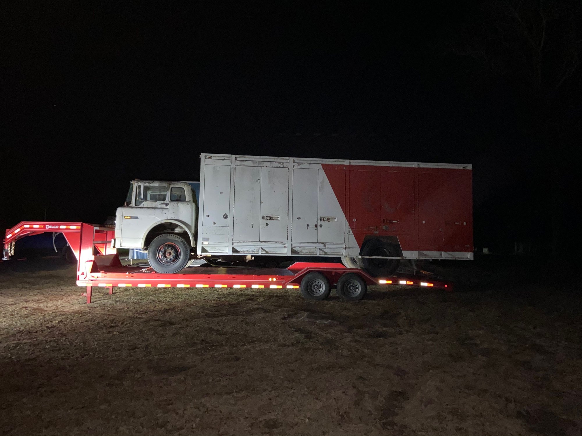

it is in fact red and white. It is an older coors truck. I’m not sure on the rear end being two speed. I’ll have to do some more looking at it.
My 12k lb winch had its work cut out for it. Good snatchblock helped get it pulled up.
30’ trailer and it took almost every inch!
