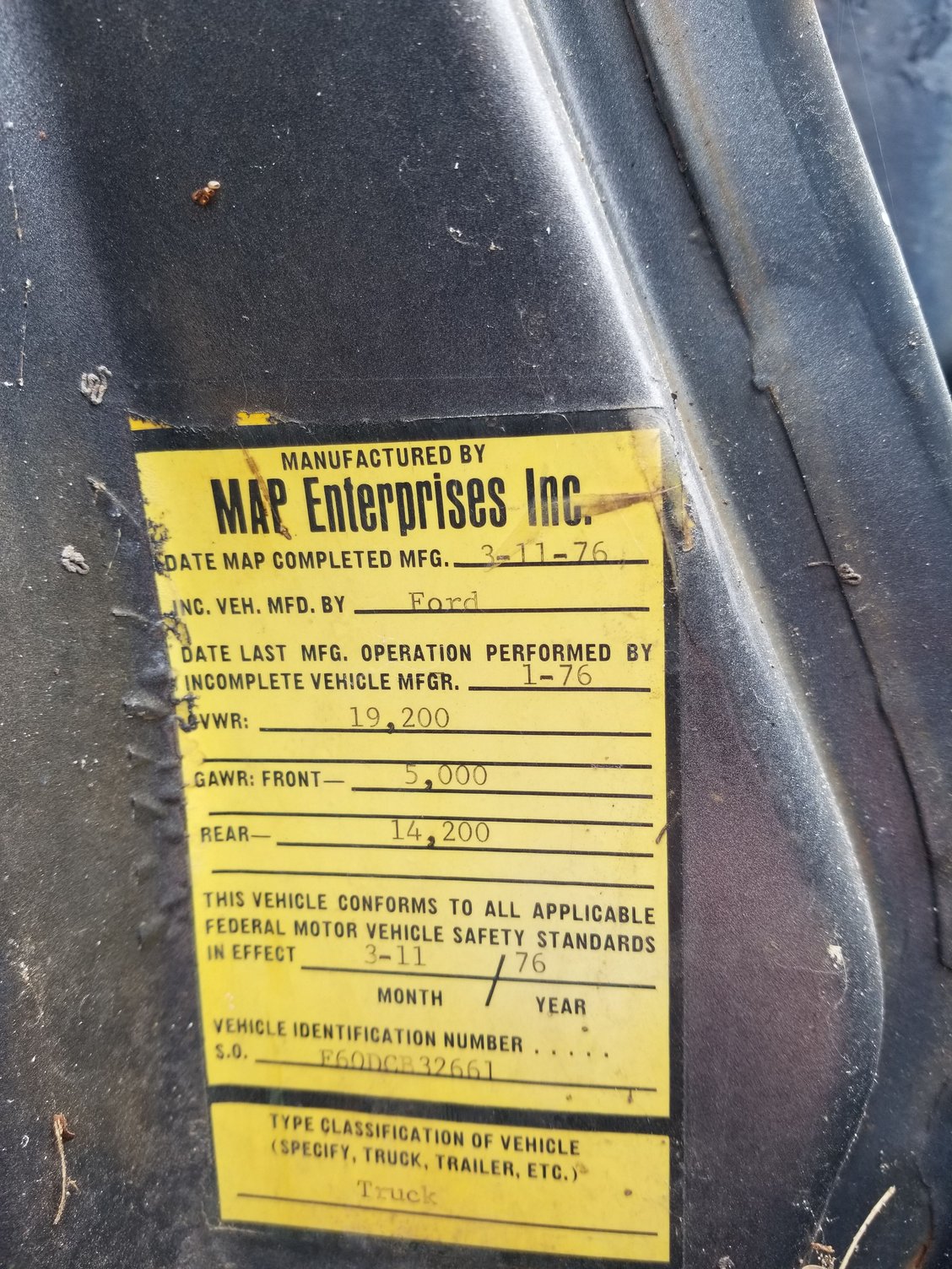

Originally Posted by 85e150
Not much in the VIN:
F60 = F600 gas 4x2
D = 330 2V HD or XD FT gas V8
C = Ontario Truck Plant. This would point to it being a '67.
B32661 = Numerical sequence. That number works for 1967 or 1976, The District code on the warranty plate, along with other info, would point to it being a Canadian market truck. According to the MPC sample I have, all US trucks were assembled in Kentucky after 9/69.

Here's the tag. I was thinking Canada but was mainly trying to get info on the engine. Thank you for the help

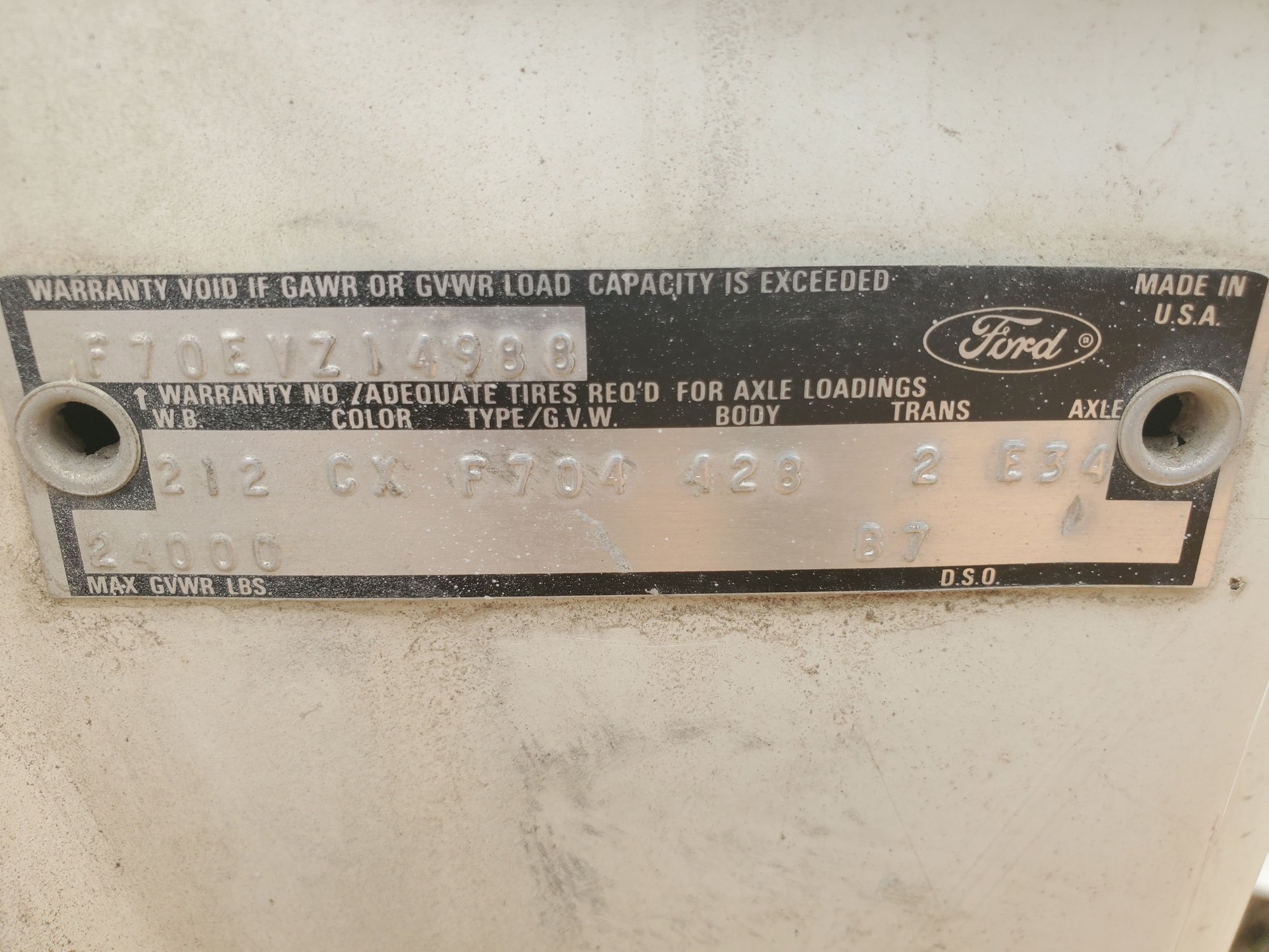

F700, no papers, need specs from VIN.
Need the specs on this old rig. Bought it for fire control, former owner pretty hazy except for buying it off a logging company. Really hoping you guys can help
Old and much modified, but still runs.
VIN plate
Old Aug 3, 2021 | 05:51 PM
  #326
85e150's Avatar
85e150
Joined: Apr 2004
Posts: 34,495
Likes: 2,809
Welcome to FTE!
F70 = F700 gas
E = 361 4V XD FT gas V8. (Starting in '76 the 361 got the 4V, and added the"XD" designation.)
V = Kentucky Truck Plant
Z14988 = 1977 series number
212 = 212 inch wheelbase
CX = Two color codes sometimes means a two tone. C = Special White, X = Tan. I don't see Tan in the picture. Another mystery.
F704 = F700 gas, 24,000lbs GVWR
428 = Standard cab. I do not have upholstery or seat info.
2 = Clark model 282V five speed direct transmission
E34
E3 = Eaton model 16244 two speed rear axle, 17,500lbs capacity, 6.50/9/04 ratios
4 = Ford front axle, 7,000lbs capacity, without power steering
24000 = 24,000lbs GVWR
87 = Body company. Sold to whoever put the tank and related equipment on it. (Possibly--could have been sold to another body company, and subsequently turned into a tanker. Any tank company placards on it?)
Old Aug 3, 2021 | 07:30 PM
  #327
Saloompt Tom's Avatar
Saloompt Tom
Joined: Aug 2021
Posts: 2
Thank you.
Thanks for the quick response! Knowing the year of this thing, plus the other specs, makes it a heck of a lot easier getting parts etc. Apparently it was also a firetruck at one time, which explains the body
code, and the PTO setup as well. It hasn't seen pavement for probably 20 years.
