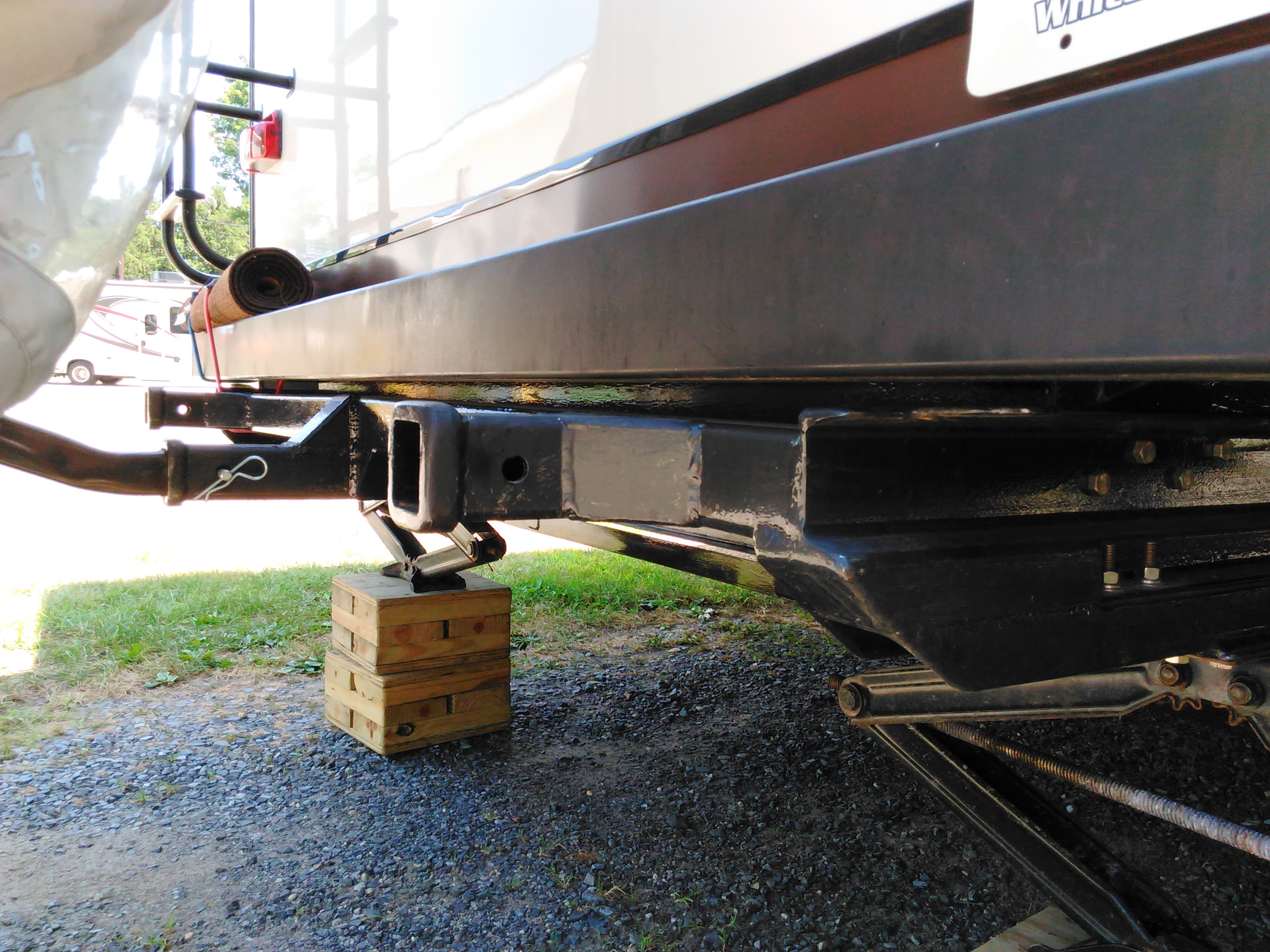

I (seriously over) built my TT rear hitch, it's fully welded and bolted in double shear to the trailer frame in 32 locations. It has 3 receiver tubes, the center for a bike rack as shown and the two outside ones for a yet to be build platform to hold the 2 small Honda generators and marine fuel tank for them, all to be fully secure and enclosed on an aluminum box.

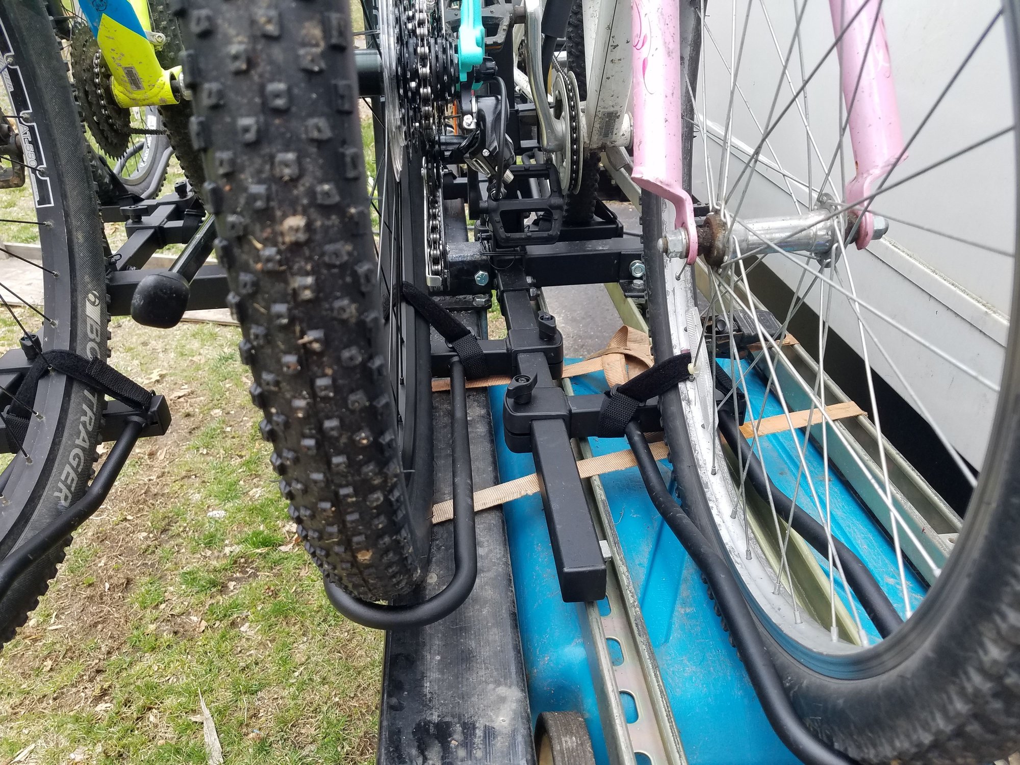

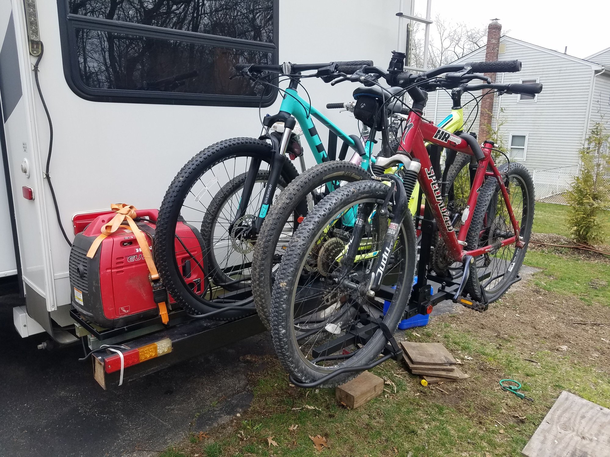

i would not recommend anything bolted to the center of the original box tubing bumper no matter how well the bumber is attached. with out additional bracing there is just too much flexing force on the thin walled 4" box tubing. i replaced mine with 1/8 or 3/16" walled box tubing and it it still flexed too much. i think i finally have a setup i like. i was able to tie it in in 2 spots.
new setup ready for florida run
hitch mount is in the middle of bike rack and on the inside Kindof cross member
