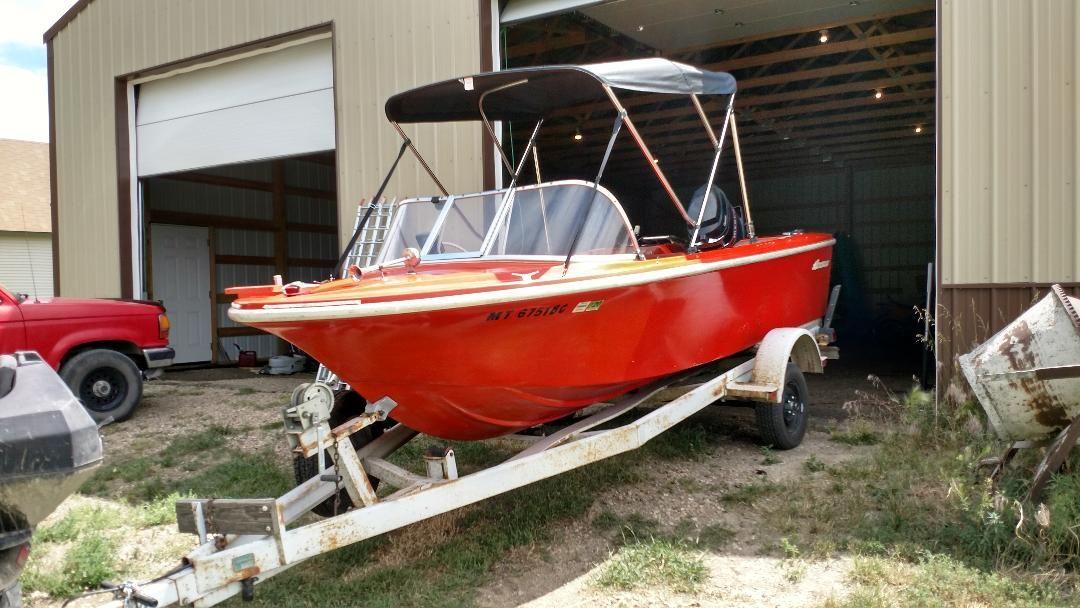

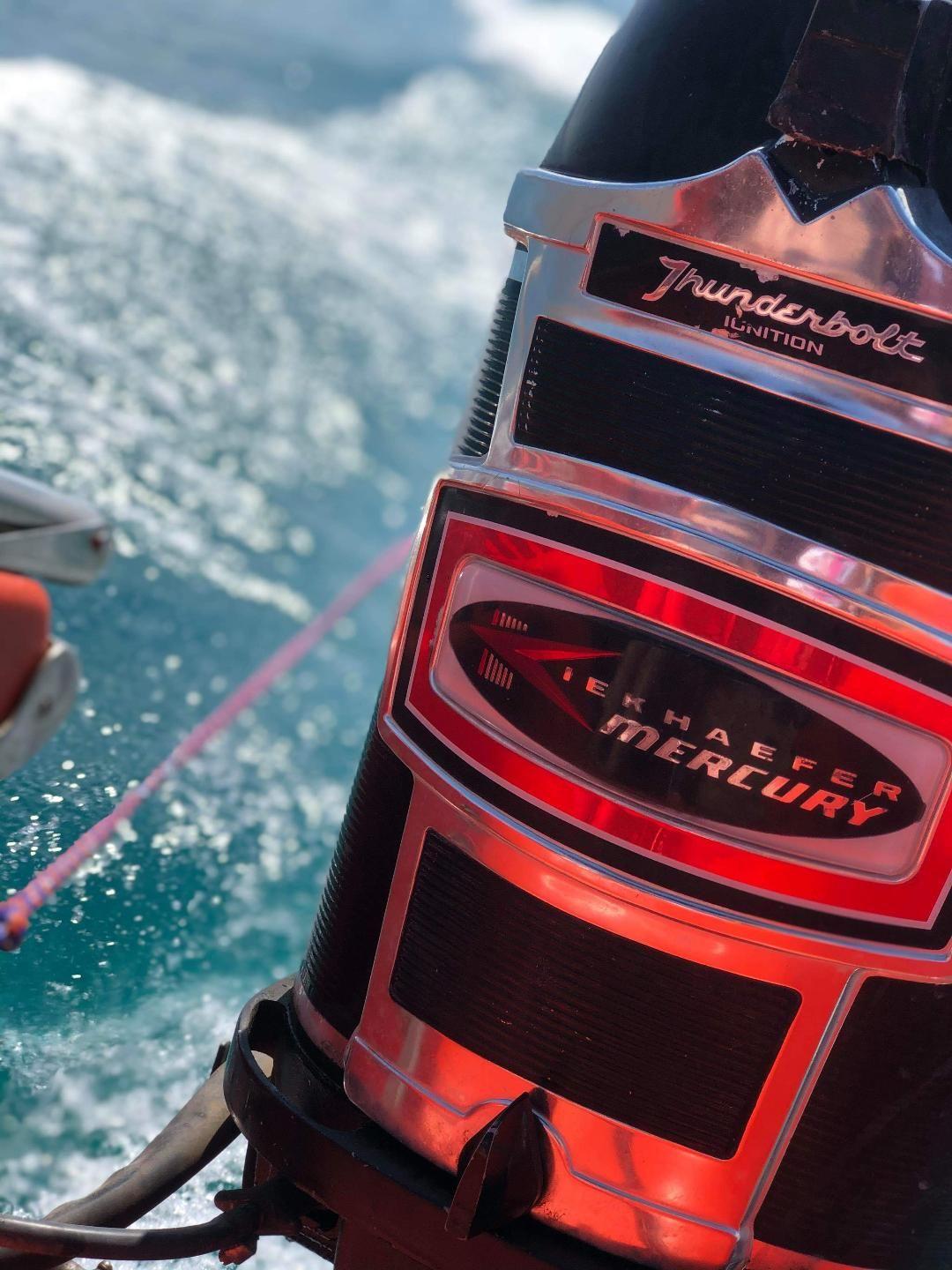

Back from our Bear Lake trip and man-o-man was that fun! Please excuse the minor book that is written below........
.......Glad I decided to forgo wasting good money on a rented boat. Put about $750 into my classic and I couldn't have been happier I did. Spent a day washing/waxing it, but couldn't really find a product I liked. Its a 50yo boat and the gel coat was gone a long time ago. Was repainted by my grandfather at some point, so commercial marine products don't really work on his cheapo automotive paint job. I scrubbed it with scotchbrite and a mixture of Simple Green/vinegar to clean off the grime, old bearing grease, and attempt to remove the oxidation. That left the hull with dull orange hue that I had hope the marine wax would shine up. It didn't. So, I dug deep into my Army boot camp memory books and used the "ol' stand-by." When you don't have time or energy for a glossy shine the RIGHT WAY, you use Mop 'n' Glow. Yup, I raided my wife's cleaning closet and stole her MnG for the boat. I'm happy to report back that my fingernails are just as shiny as the boat is. After spending the day cleaning and shining her up, I installed a fresh bimini courtesy of Amazon Prime. Lemme know your thoughts on my MnG shine job:

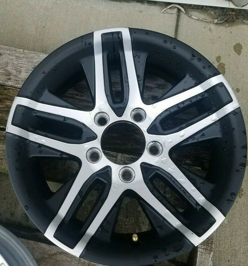

Now that the boat is looking all purty, the trailer really stands to use some love. I'll paint it black to match the bimini and wheels that are coming. Not wanting to lose another boat to a roll-over and fire, I replaced the 50yo axle with new one, inluding hubs, bearings, and marine grease. The original drop axle was square tube with about 4in of drop. I couldn't find an exact replacement in the weight capacity and dimensions I needed, so I ordered a straight tube axle kit that I could weld up myself and keep it spring-over (factory) or under as necessary. Either I measured wrong, remembered my specs wrong when ordering, or they sent me the wrong axle! When compared next to the original, the new axle was 5in narrower. Whoops! No time to send it back and I couldn't do anything with my old axle or trust it to make the 800mi round trip journey, so I went forward with the "mistake" and made it work. After triple measuring the correct spacing for the spring perches, I welded them onto the axle with my angle finder getting them perfectly level. Once painted and installed, it looks factory other than the wheels/tires are a little closer to the frame. Speaking of, the original wheels are only 13in and look tiny on the trailer now that I'm not using a drop axle. My Ex is taller than stock, so having the new axle configured as a SPOA, I gained about 4in of lift on the trailer. To fill the wheel well, I decided to order some new wheels, 2in spacers to make up for someones's goof up, and some new tires. Here;s what I ordered off Ebay as dealer take-off's for a measly $62.50 shipped:
Glad to say that the trip was uneventful as far as problems with either the boat or the trailer. Weather was a little cloudy and windy at times, but we still had a blast. Got a call 30min before leaving Montana that the motel people double-booked our room and would comp us 50% off our entire stay if i was willing to squeeze us into a smaller room for the first night only. Sold!!! We settled in nicely to the vacation lifestyle, gorging on raspberry shakes (a local tradition, apparently), fries, and anything else that looked good. North Beach on the Idaho side was sandy, warm, and really shallow. We could wade out 200yds and only be waist deep. Fun for playing on the beach, soaking up some sun, and BBQing a marinated pork loin. But I came here to go boating! All in all, it was a fun trip. Here's a few pics that remind me I need to buy some vacation property down there and relax a bit more....

Ahhh...the old Mop-N-Glo trick...fun times. Looks good to me!! The other thing that works really well for gelcoat (provided it has a decent wax on it) is that Formula 2001 stuff in the bright green bottle. Wash the boat, spray it on, and leave it. It even hides gelcoat stress cracks pretty well. I wonder if that would work with paint as well
