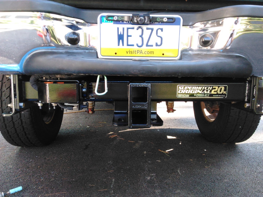

Originally Posted by RedBirdin96
The chain extensions were purchased through ProPride, but I do not know the exact rating in terms of strength, then there are the connectors I had to use in order to attach them to the factory chains, so I am sure something is weaker than factory :-(. Regarding the break away cable, in this pic it is on the hook for the safety chain as it did not have a separate hook from Jayco, but once I got home I installed a hook and clip it to the hitch separately from the safety chains.
Again, not to criticize, but clipping the safety cable to the little loop up under the bumper (I keep a small clip hanging from it to make it an easier find and hookup) will offer protection in the event of a receiver hitch failure vs clipping onto the hitch itself.
Here is a picture that show where the little loop (actually one on each side) is located and my little clip hanging from it.
Attachment 281394

I use the same hook for the breakaway. In reality, I can't fathom a receiver failure with the Torklift.
