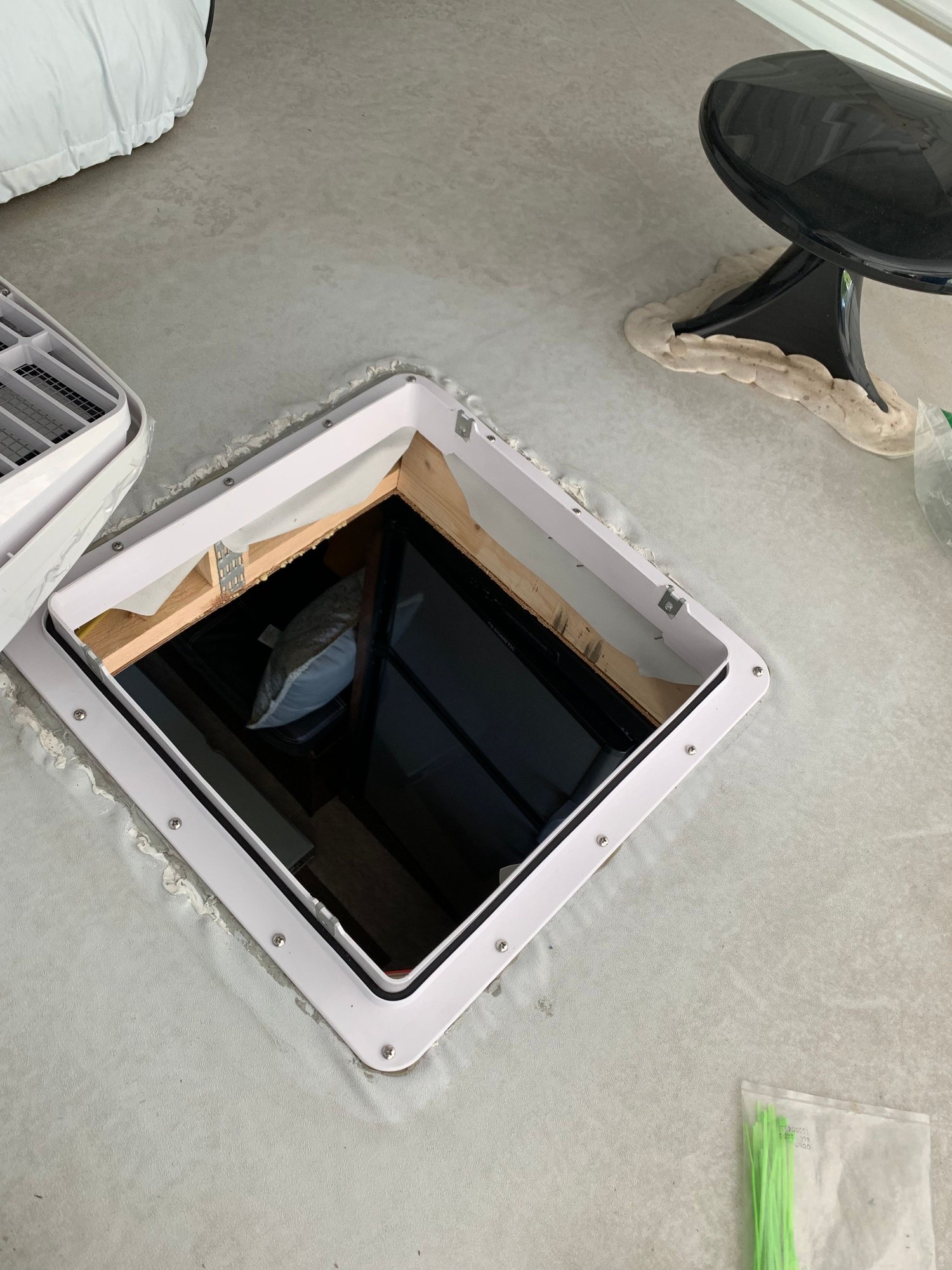

Originally Posted by thor363
Did you use the Dicor products also? Thanks!

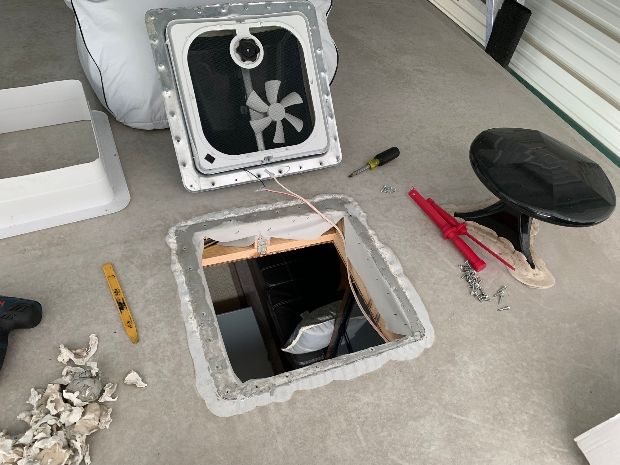

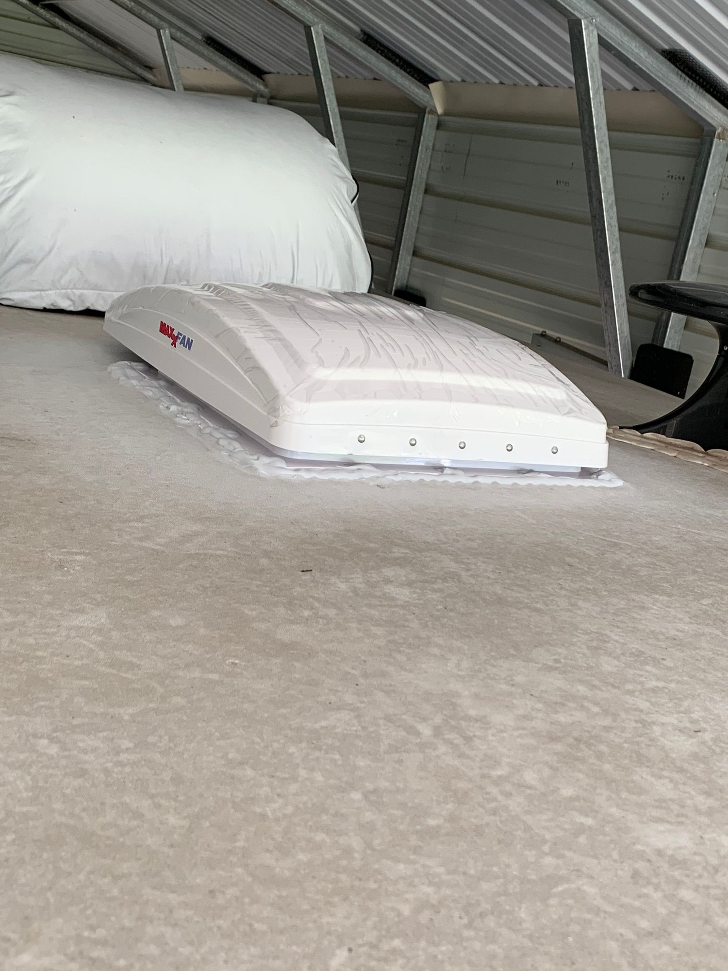

Yes I did. The Maxxfan I have does not need a cover to protect when raining.
The original one
The new one has a seal on the roof flange that contacts the fan unit and makes a seal there.

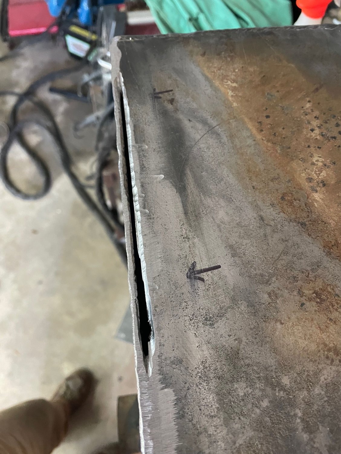

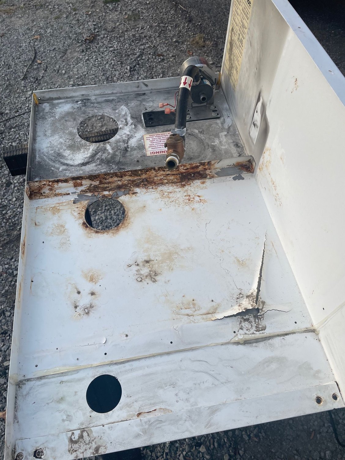

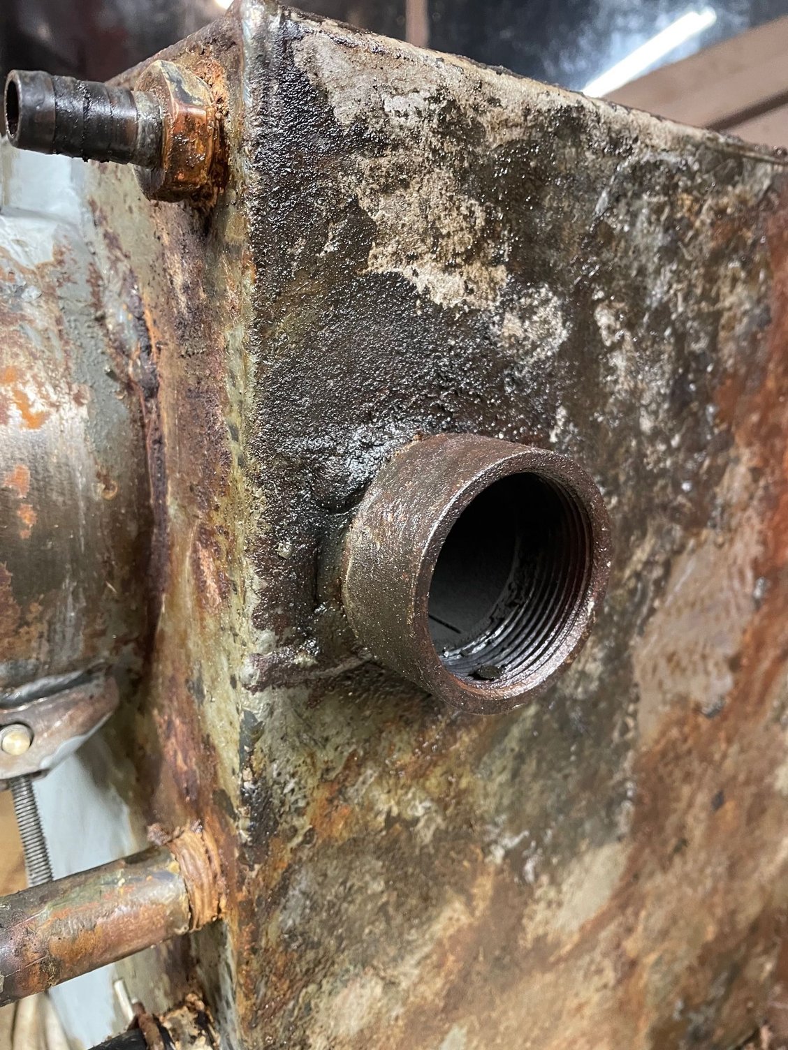

Winter weather has mostly set in here in Southwest Ohio and in the weeks leading up to it, I've been battling some "camper" issues that I figured I'd share so y'all can live vicariously.

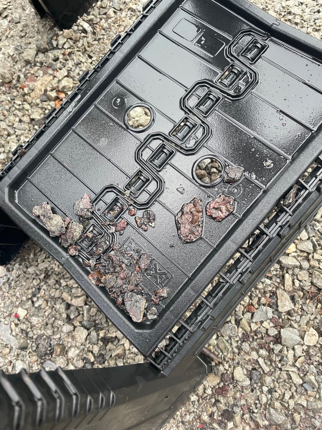

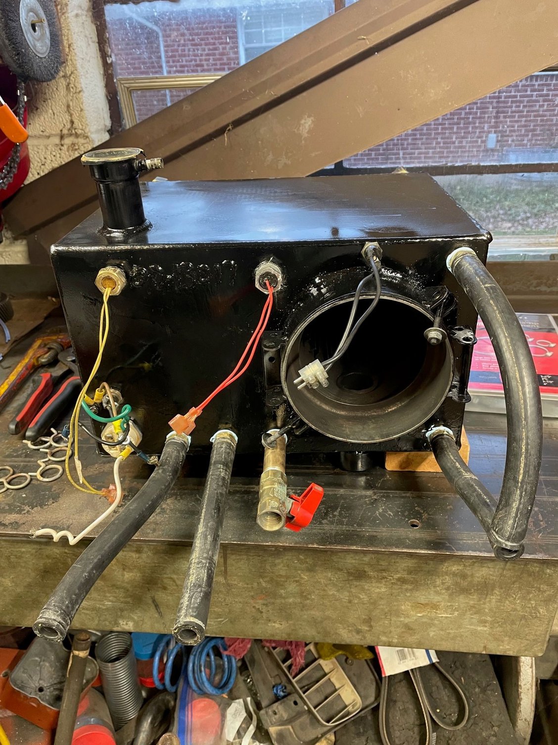

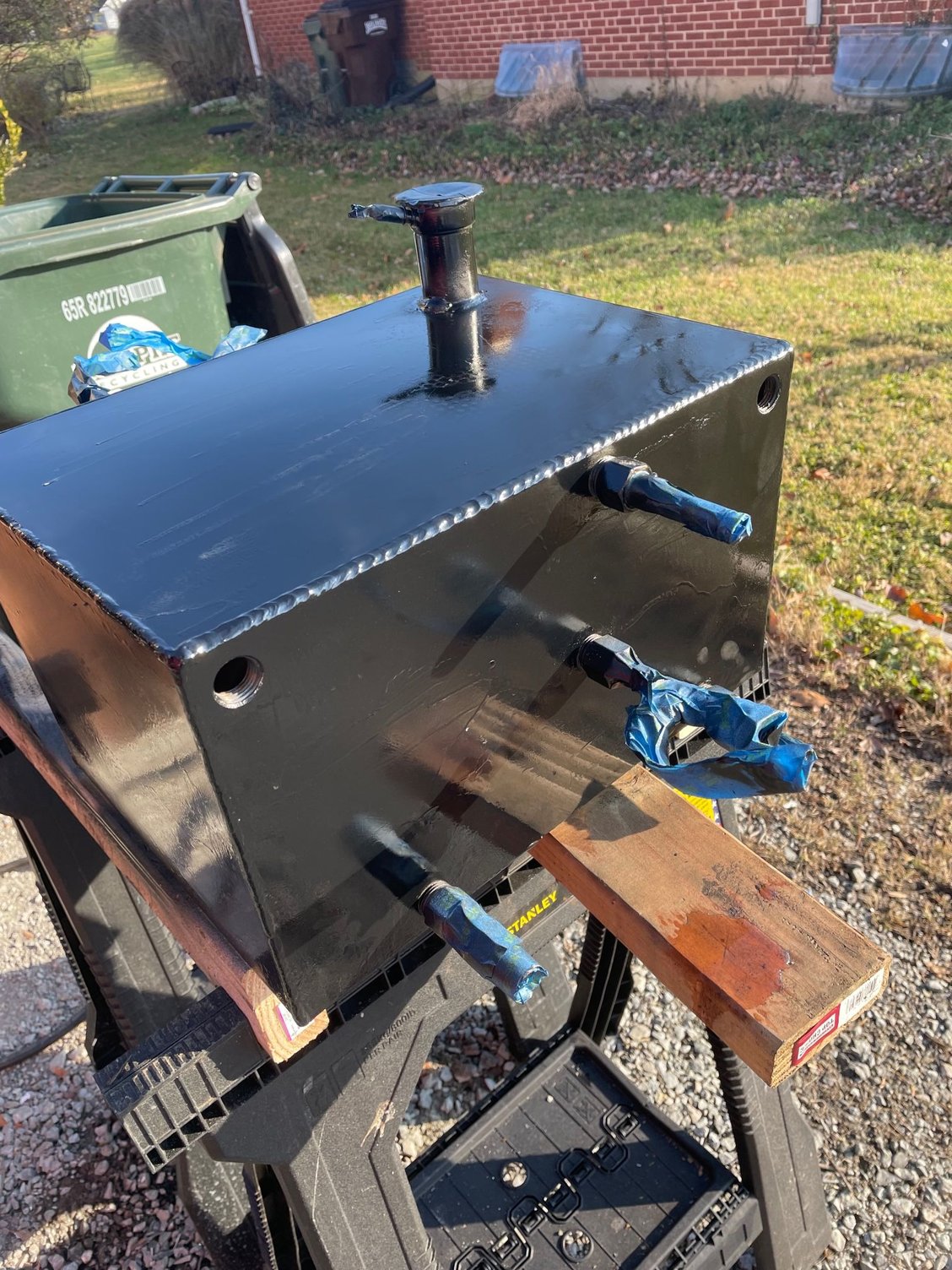

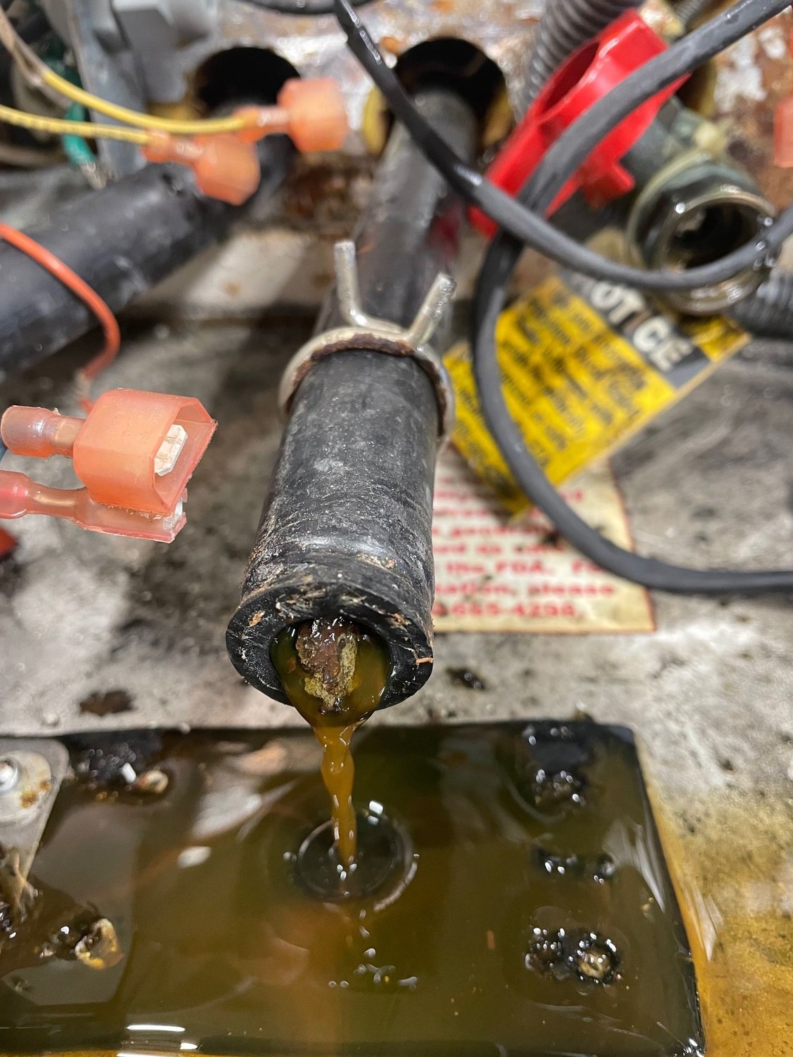

Aquahot is a loved and hated system that the RV's have that does 3 things: Engine preheat for cold weather, hot domestic water, and furnace heat. Some coaches alos have heated floors like you can get in a house (hydronic heating). It's a diesel fired boiler with electric (basically a standard hot water heater element). Mine has been weird since day 1, and I've been through fixing the diesel side (wouldn't fire) and a faulty boiler fluid level sensor. Got it all going fairly easily and then the last trip we went on I sprung a leak. Boiler fluid leak. I figured it was a leaky fitting as the tank has about 10 different fittings threaded into it. Pulled it out of the coach, which wasn't fun. The worst part was the engine preheat hoses. They're attached onto plastic barb fittings. Only thing was, they aren't the multi barbed fittings like brass. They have single large barb. So, several gallons of leaking engine antifreeze all over the place later, I got them off and plugged. Made a GIANT mess all over the storage floor. Took 2 bags of oil dry to get it all soaked up. Not fun.
The case is riveted together so those al had to be chiseled off, ruining the nice paint. Didn't really matter at that point because when I got it all apart, the inside of the case was rusty as well. Pulled all the fittings and left the sensors and the two copper coils that are inside. Plugged the holes and began to flush as the boiler fluid looked more like dark mud than anything. Turns out that the inside of the tank was completely rusted up. Large chunks of rust scale came out and I ended up having to fill from the bottom and then pull the cap off and let it flush through that big hole. I also used CLR on it. Got that all done and then used air to pressure check it to 10PSI. Found a crack on one corner of the tank. Took it to a buddy's house and ground out the crack and opened it up with a wheel. he then TIG welded it and that fixed it. Pressure checked OK after that. Started putting it back together last weekend and the painting is taking FOREVER. Makes me wish I had a paint booth. Got some of the fittings back in with pipe dope and found some new insulation from a neighbor who is a union insulator. I think it'll work. Once I get it all back together, I'll have to install it back in the coach and fill with new boiler fluid following a flush of the heat exchangers.
Am I the only one having this much fun???
Rusty Case
I suspect that one reason for the rust is that the grounds were loose
Tank painted
Going back together
This is supposed to be bright yellow/green
Nasty rusty tank
Cack opened up
Welded up by Eric
All the nasties from the inside of the tank
